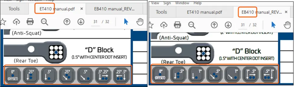

ET410 & EB410 use the same gearboxes, ABCD blocks, hinge pins, and inserts. Why are the amounts of change different when adjusting inserts (pills)?
I have to guess it's the difference in the length of the arms. In my pea brain though it would be the other way around with the longer arm having the greater changes with the hole offsets.
There's just a mistake on the EB410 one. For the 410 platform, single dot is half a degree and double dot is a quarter.
