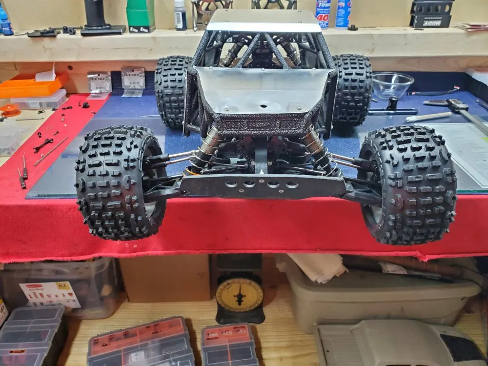

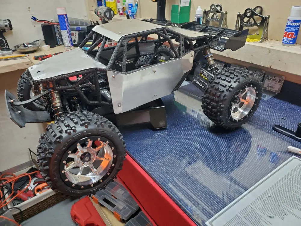

48.3 Here is my progress REBUILD MT410/ET48.3

The ET48.3 chassis is a good choice, amazing balance and stability. Love those trucks. I have two, one is m2c-ed for bashing and the other one is stock for racing.

Dude very noice :) really cool creation!
have you tried this with plastic rim proline truggy tires? took me a while to finally put truggy tires on my et48 because i didnt think the treads were aggressive enough - but now ill never go back. #1 rotating mass reduction is huge effect on hub bearing life. #2 way better at turning, braking and launch. #3 (i was using 1/8 buggy tires up till then) gearing smoothed way out, went from 21T pinion @50mph to 17T @ 50mph and it became alot easier to control the throttle.
i recommend buckshots... i know, it was painful for me to shelf my 150$ set of rims too.
