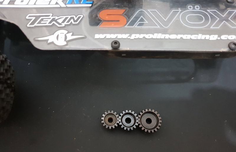

I am still sorting my way around getting a suitable setup fro bashing, with the 15T/44T gearing that was on the truck when purchased. On 2S it was not overly impressive, actually quite disappointing. I purchased a 17T - go to for racing I am told giving the best balance of acceleration and top speed , and a 20T , for bashing. 15T,17T, 20T pictured side by side.
I had a few of the racers on FB telling me that running 20T was a fools errand on a 4600KV Tekin engine, and that I would thermal it in very quick order, even to the point where one poster jokingly said it will be good , at least one run ?
Well rumors of an immediate death were greatly exaggerated !

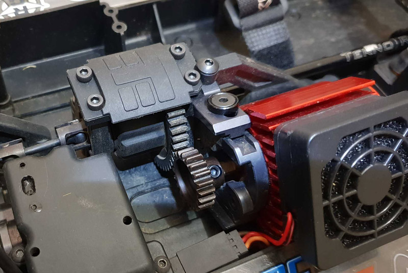

20T installed .
Temps were well within range after heavy bash session, around 70-75 Celsius ( 158-167F ) , top end speed was now within a hair of the Hunter on 3S.

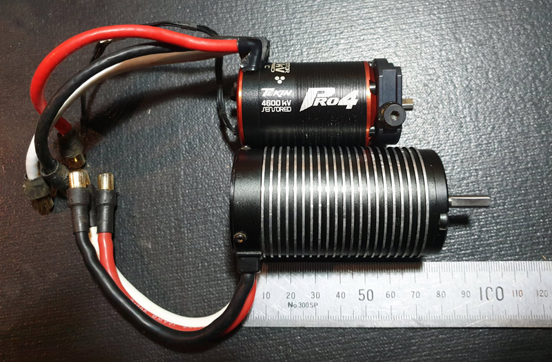

Some details on the 4S conversion, first up was sourcing a suitable 2200KV Motor.
I settled on a SH Traxxas rebranded 2200KV Castle SL motor for the initial test install , which has proven to work well enough for me to keep it. Difference in the size of the motors were quite substantial as can been seen.

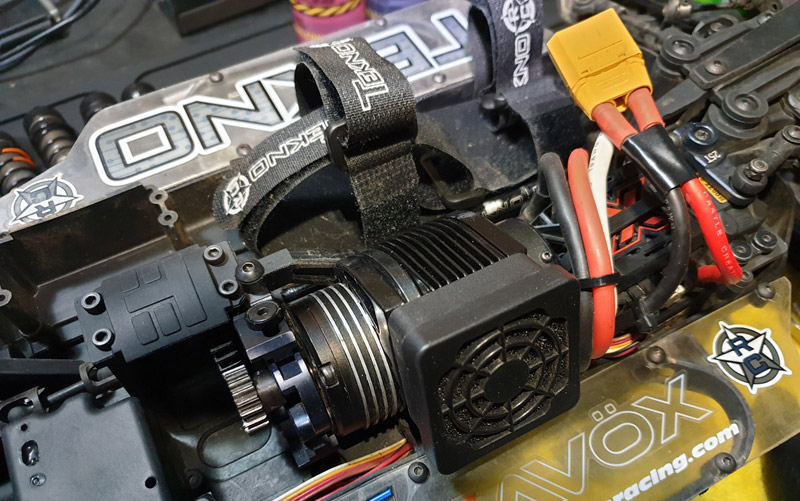

First curve was to replace the original LCG engine mount that was standard on the SCT410.3 as it would not allow the installation of a 42mm can motor. The motor mount insert of the EB48 was required , part number below.
EB48.4 - TKR5211 Motor Mount Insert - Required for 40/42mm can motors :
The only other parts required were the longer battery straps to suit 4S :
BR48.4 - TKR40007K - Battery Strap Set .
Installed a modified HSF array to keep the temps down, also changed the battery connections to XT90 after a minor disaster of melting the original Deans, which I quickly discovered were not suitable for 4S. Pinion is 17T
