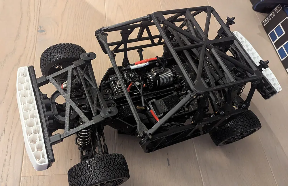

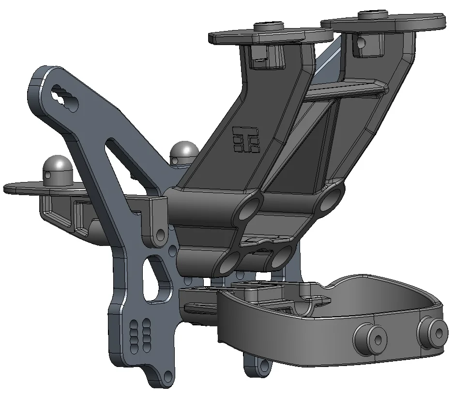

If you have a 3d printer you can make one from TPU & PC material. I made some custom stuff for my sct410 (the honeycomb TPU white part is pretty durable). The ET48 has a few mounting points on the chaise, A block, and shock towers to base support around (depending what you are after for bashing)

Nice looking ET you have there and thanks for sharing.
I don't think I have the proper tapping tools or skills for that modification lol.

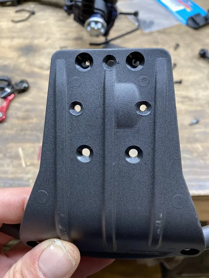

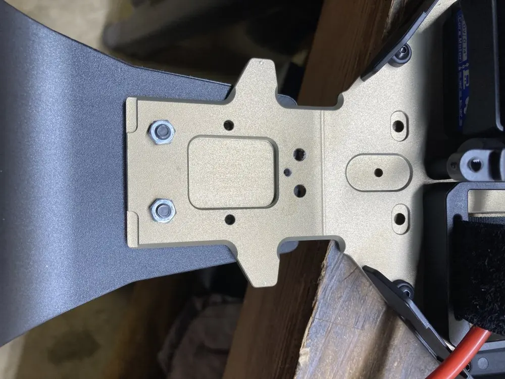

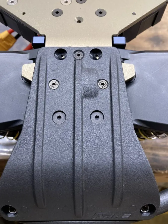

The MT410/MT48 bumpers bolt up to the ET48 no problem. You'll want to use the longer screws that the MT calls for though. I think it's M4x25 in place of the M4x20 and M4x20 in place of the M4x15. I also suggest putting the thin steel skidplates we sell on there too. By running the steel skids (chassis, plastic skid/bumper, then steel skid) you will increase the life the plastic skid/bumper and the steel skid prevent the screws from going too far into the plastic and deforming the holes.

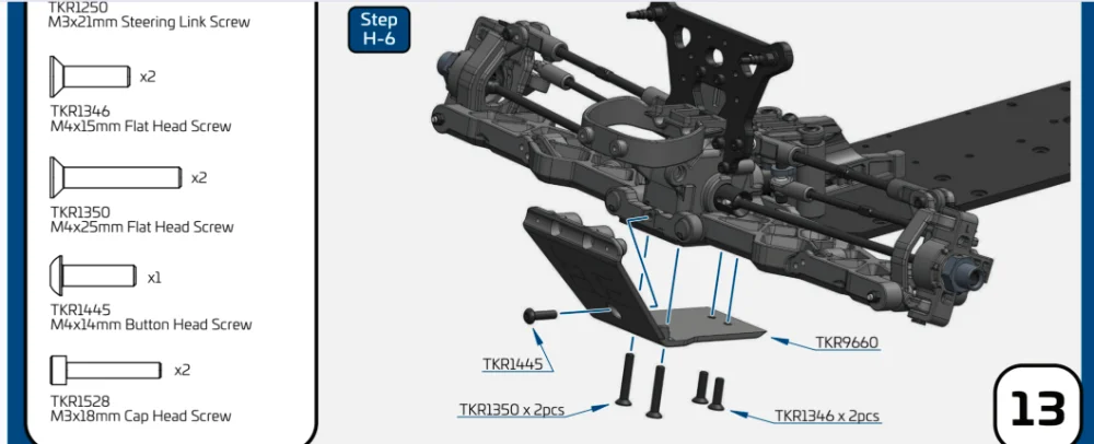

Mind sharing the tekno part #'s for the hardware or the longer screws that I need to order please?
The wheelie bar shouldn't be a problem. I think the only interference between MT and ET parts are the wing mount and the tower/bulkhead brace. I haven't put the various pieces together in a while so I can't be sure offhand.
Here's a pick of the MT48 manual with the screw part numbers.
