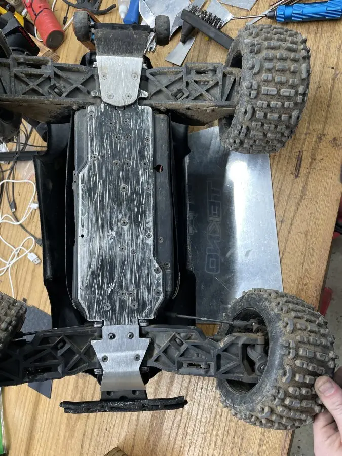

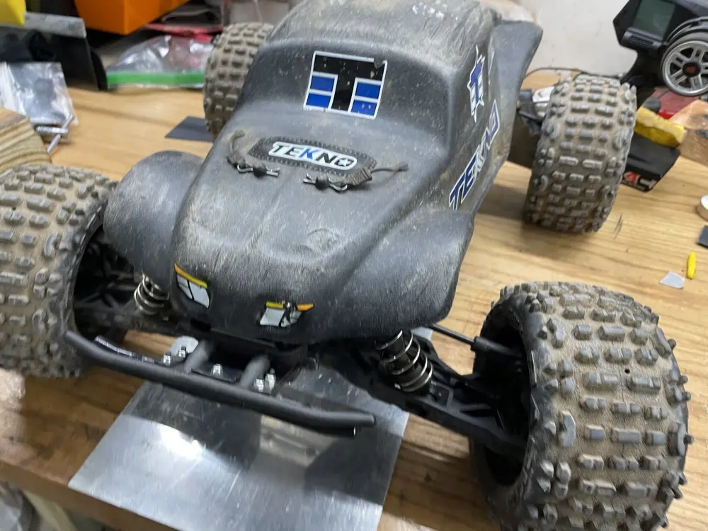

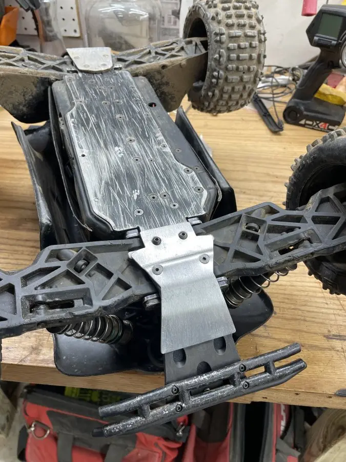

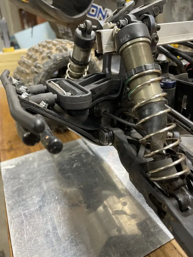

I couldn’t find a good bash bumper so I upgraded a new Tekno original bumper. I used kydex to brace from above the hinge pin against the gear block and behind/under the top brace. Drilled through the two front screw holes and bolted the kydex into the back with a aluminum plate under the nuts. I bent the aluminum skid plate to cover the lower spot in the bumper where it shovels dirt and cups in the plastic.
