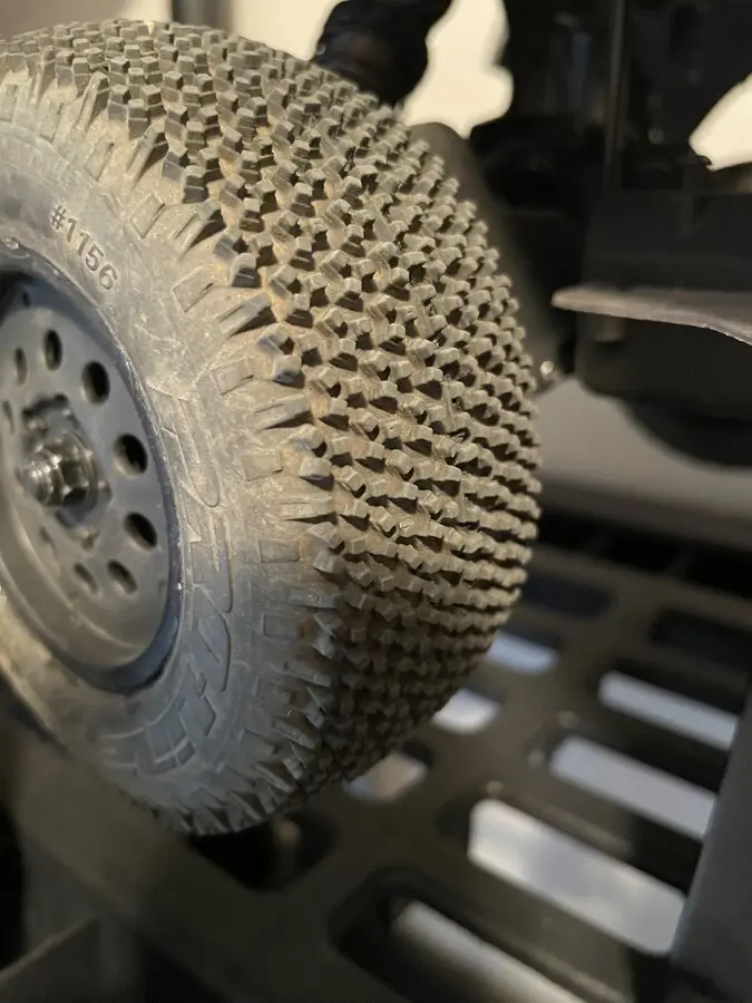

I couldn’t even go in straight line with out it veering off or spinning out. It was like it was skating in ice. I decided to run my 2wd slash vxl in the same conditions and that thing hooked up 100 times better. I’m hoping it’s just my poor tire selection. I was running the proline calibers. This is my first build so I’m new to it. I’m hoping maybe someone could give me some pointers to try out. Thanks

BTW your tire selection looks good so long as you went with super soft compound... if you're running soft or medium compound then that could be a problem, regardless, the truck should be able to drift no matter how horrible the tire is performing.
