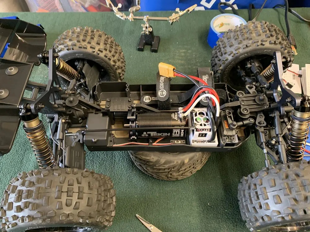

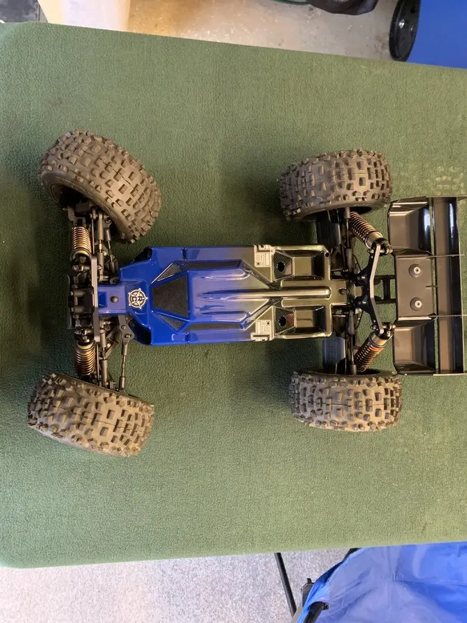

Just need a pinion, leaning towards 16tooth for 4S use.
Also will get aluminum servo horn

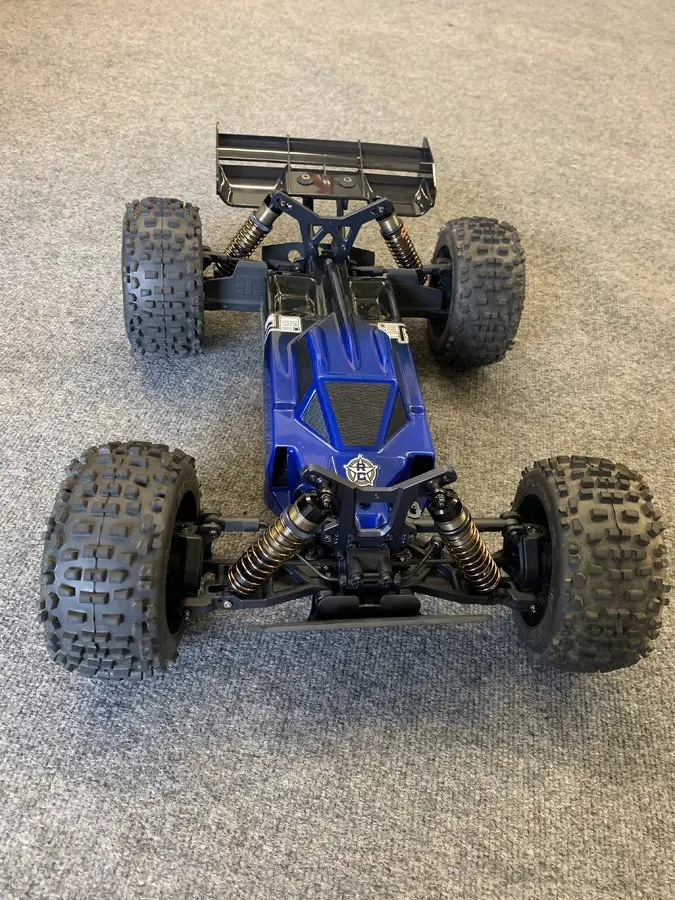

It looks really nice. Like @Billl DeLong bill I am also wondering about the wheel clearance at full lock, not just at rest but also with the tires ballooning under throttle.

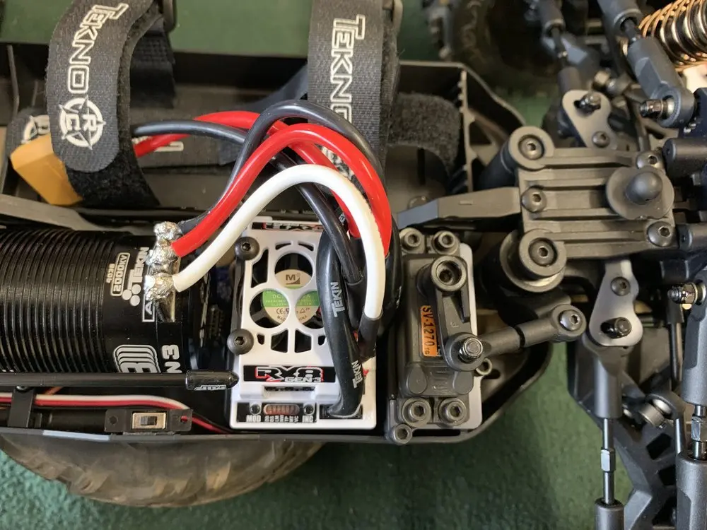

Probably cant fit anything smaller than a 15t pinion with that motor. I have them in my truggy and buggy and without grinding the center brace I cant get proper mesh on a 14t pinion.
Ok excellent advice....
I’ll check wheel clearance
Gonna bring my buggy to hobbyshop to test fit pinions.

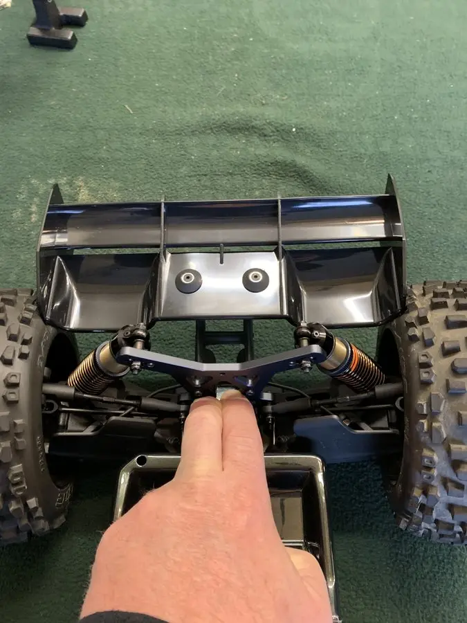

Looks like it’s maybe ok? I’m gonna have to trim wing a little in the rear.
Looks like it will be rubbing when it balloons. I’d definitely belt those suckers.
You can simply add rc8t extended hexes and the wheels will have full clearance.

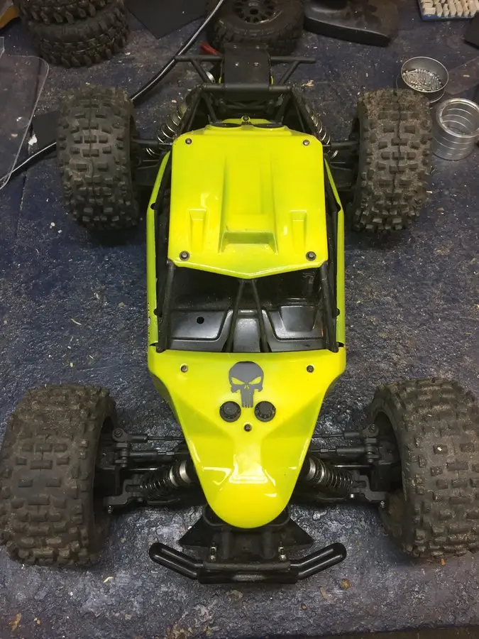

This truck is a mix of kits...but mostly an eb48.4 now. Eb48.4 arms/universals/links. Running the same wheels/tires combined with the rc8t hexes i easily have clearance, even with ballooning. I dont have the wing but I’m almost positive it’ll clear for yours.
This truck is a mix of kits...but mostly an eb48.4 now. Eb48.4 arms/universals/links. Running the same wheels/tires combined with the rc8t hexes i easily have clearance, even with ballooning. I dont have the wing but I’m almost positive it’ll clear for yours. View attachment 1858View attachment 1859
Oh nvm. I see they are the same. Thank you soooooooo much.

Almost ready for maiden run. I added the RC8T extended hex set, all my clearance issues are solved. Put the T Bone front and rear bumpers on. Thank You Chainsaw
