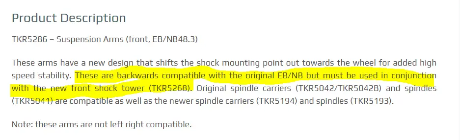

https://www.teknorc.com/shop/tkr5286-suspension-arms-front-ebnb48-3/
OMG, thank you very much, I didn't noticed.
I'm quite confused now, EB48.3 has longer shocks than EB48.2 so if I use shock tower for EB48.3, Do I have to replace shocks too?
You have a forward upgrade path with higher quality parts without having to buy a whole new car, it's a no brainer to keep what you have IMO

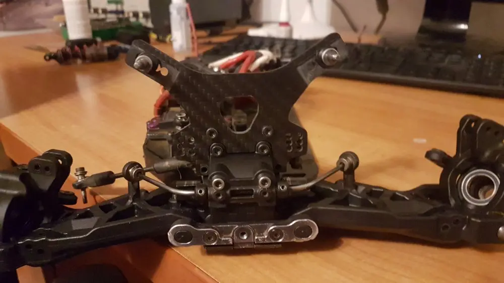

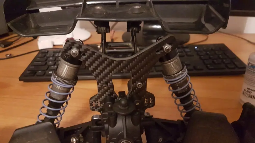

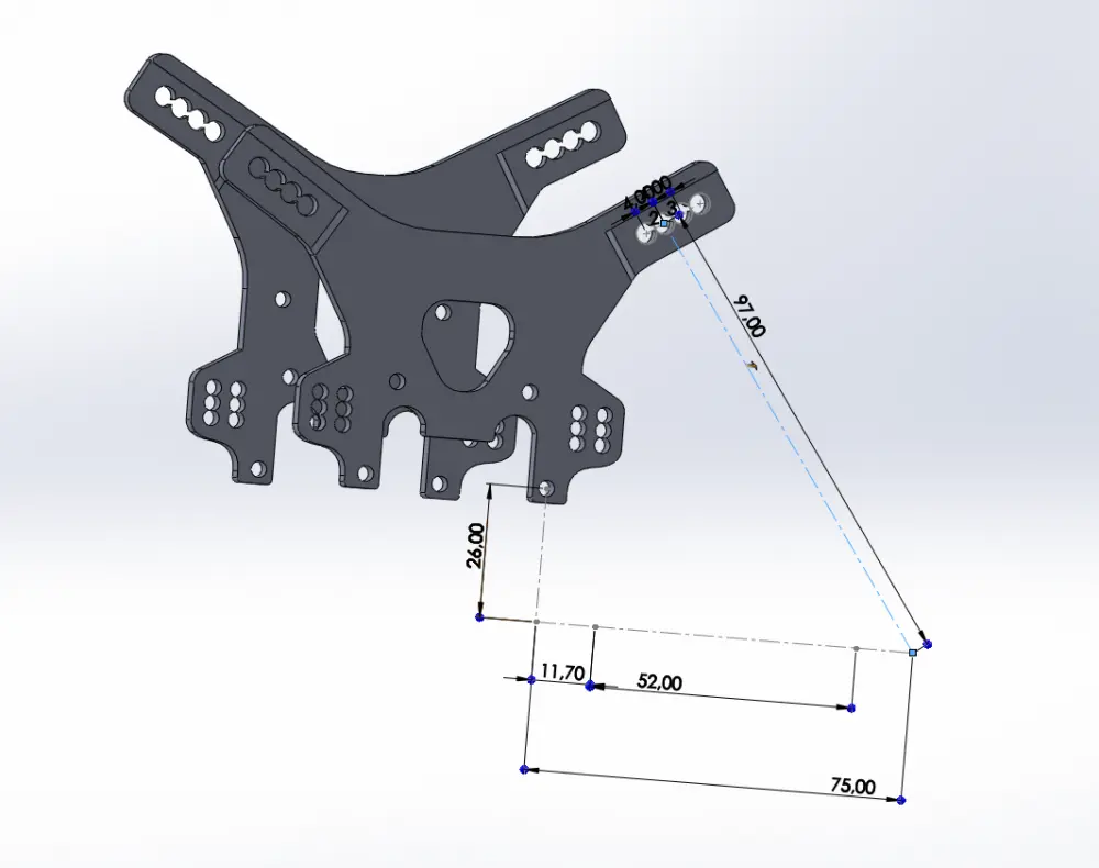

Well, I will never sell that car, I love it. I bought arms for Eb48.3 and create my own tower. I tried to keep original geometry as possible. One week of measuring and printing prototypes.
I'm not sure about carbon, I think it would be weaker than original towers. I will see.
The car is almost new, I spent approx 250$ for new parts, I'm waiting for chassis and new body, it is last order :).
