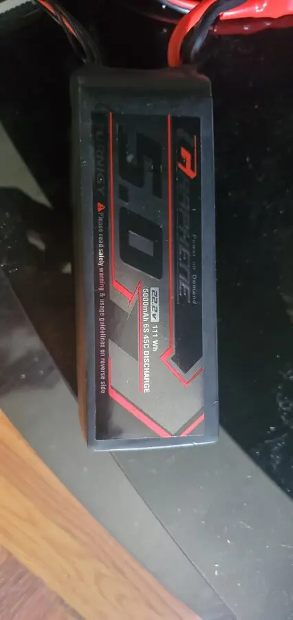

Hi, forum i wanna start with im still new to the rc game and I need help with finding the right gearing to not burn nothing up? I'm running 4092 1420kv motor 20t pinion with a max8 esc on punch 4 on 6s 5000 mah 45c graphene lipo. I wanna know is that a good gear or am I geared to low or to high? Like I said I'm still new to this and the gearing part is my worst fear not to burn anything up. Any suggestions or advice would be greatly appreciated 🙂

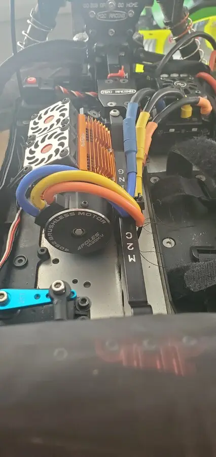

Well the temp I got was 148 Fahrenheit onesc and motor about 160 at about 15min run on grass and ripping down my street. I have a temp gun I just don't know what Temps are bad or good? So are those good Temps for that long run of 15mins?

150F is good
160F is the limit I do not like to cross
180F is when you start cooking the grease in the motor bearings, leading to compromised lubrification. If you ever get there, recommendation is to change the motor bearings or you risk regular overheating.

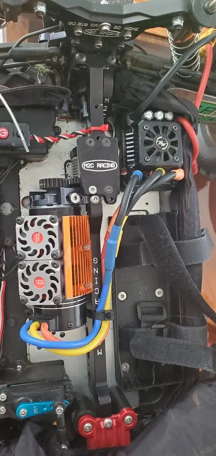

Ok thanks I'll look out for that also can I change pinion size to see if temp changes as well? And I'm running these tires the dboots copperhead.

You can reduce pinion size to reduce temps, but only to a certain extent.
150F on grass feels alright though. Grass creates resistance and a lot of heat. I would just keep an eye on it.
