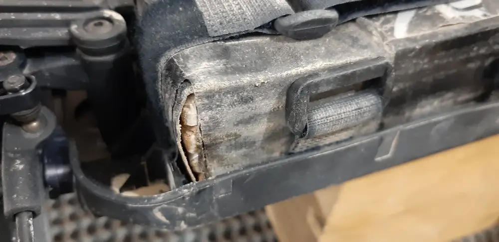

My "strips" in the tray...after i closet ..push forword the battery...and she hurt...you now what i meen?.
I wil photo this..

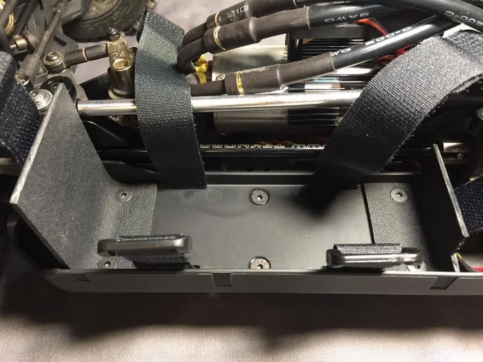

I would replace the OEM tray, and if there is any gap between the battery and the front edge of the tray, then I would place a shim there to help fill the void. Cut a scrap piece of plastic, I have used a plastic servo horn from the kit as a spacer too.
Also very important to use all 3 velcro straps ;)

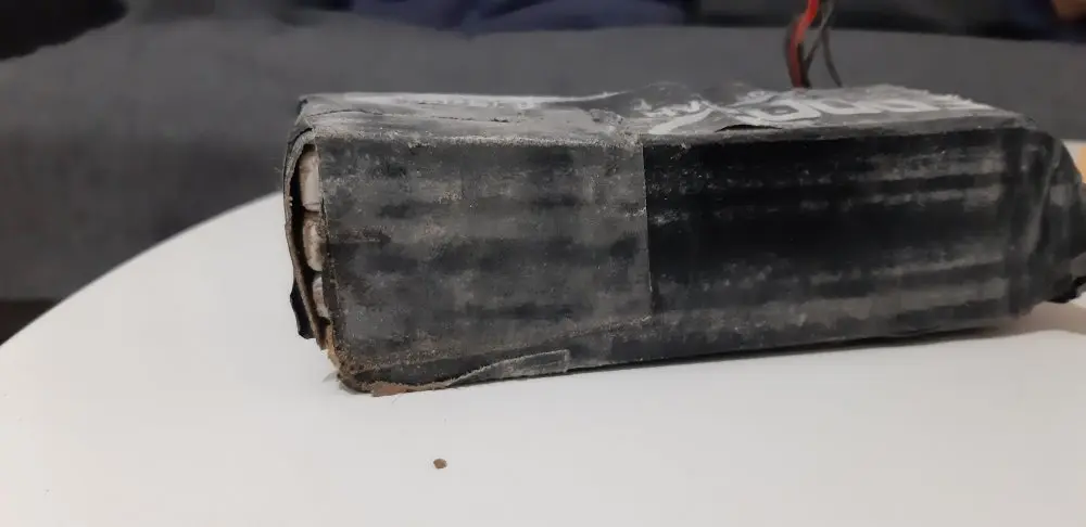

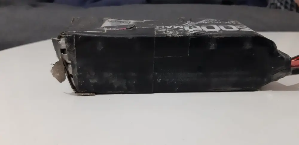

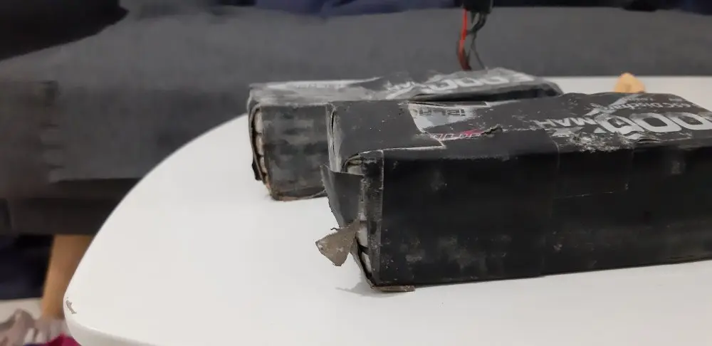

This hapen becous i jumps allot. The battery move back little bit and corved becoas the small plastic on the tray 20200924_214211.jpg

I recommend going with a hard case pack, it can handle a lot more abuse and will be less likely to shift like that.
