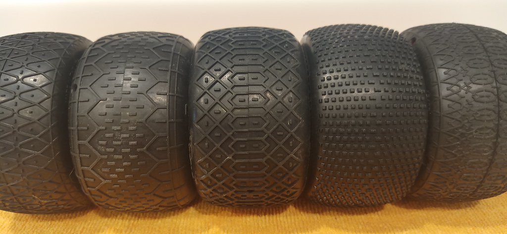

Here are all the tires I have tested at Thornhill with running the same tire on front and rear and compared my lap times during a single session and quickly swapped my wheels to make sure I wasn't having an bias with moisture change, I ordered the fastest tire on the left to the slowest tire on the right:
At this point, all I was ever told was to always run the same tire tread pattern on the front/rear, but a few months ago I attended an AKA Race Clinic that was hosted by Gil Losi Jr and Tyler Hooks and they discussed some key advantages of running a different tread pattern up front. It was a 45 min session so I can't possibly explain everything I learned without writing a full chapter on the topic, but I already gave an abridged summary above of what is working well for me right now :)
I tried many different combinations and put a fair amount of work into figuring out a system that my setup is responding well for our current track, where I am running soft compound in the summer and super soft compound in the winter with Simple Green sprayed on the tires between each round.

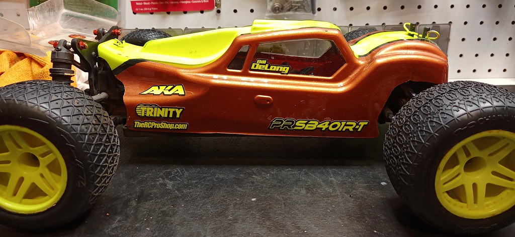

I no longer run the ET410 and have switched over to the PR Racing 401R-T a little over a year ago, but I would expect similar results regardless of the chassis:
I'm definitely not the fastest driver in my area, but every now and then I have a pretty good race day, on occasion, I'll also hit a 99% consistent run with this tire combo too:
