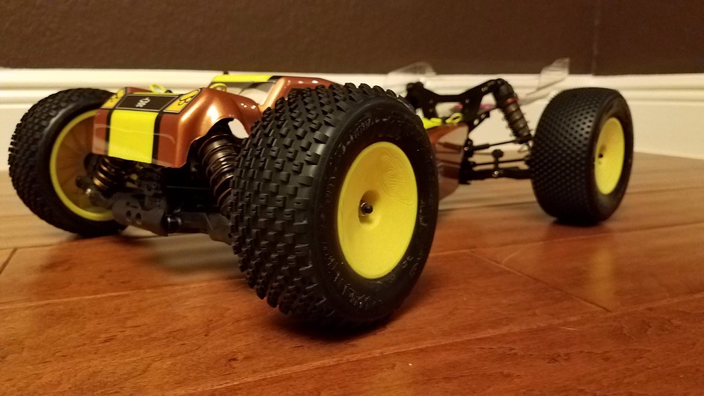

biggest problem I had with SCT wheels on the mini truggy was the higher center of gravity... I couldn't reduce the ride height properly and was prone to traction rolls... for bashing around it's cool, but for racing, ST wheels are the only option IMO.
I raced on carpet, turf, dirt and clay... same results all the way around regardless of condition, lap times were significantly enough faster with ST wheels and FAR less frustrating with the tuning.
That said, you didn't specify the track surface which will be impossible to recommend any tire package regardless :(
The only good thing about SCT wheels was they were so tall that they ballooned up to where the front wheels could grab the ground when on your lid to self marshal... never once had to be marshaled with SCT wheels, but consistency was crap with the SCT wheels too, ha!

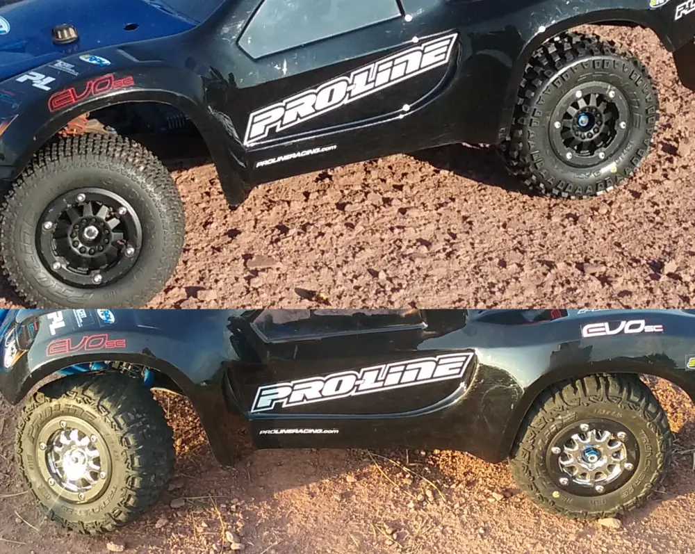

I love the look of SC wheels/tires to give the ET410 a truggy-like appearance, and has better selection of knobby tires. The Pro-Line set of Traxxas Slash SC offset wheels that I use, had a smidgen deeper hex socket which required me to use +1mm hexes in order to tighten the wheel nut. Just be aware of that if/when you do go the SC wheel route, and you have wheels that feel hard to turn by hand.
I had two sets of Pro-Line bead lock wheels...
they were significantly heavier, because of the metal bead lock ring and screws. My track is medium to loose conditions and I still managed to "pop"/pull the tire bead while going into corners hard. Yeah, I like the look, but I would not recommend them in any racing with others situation.
