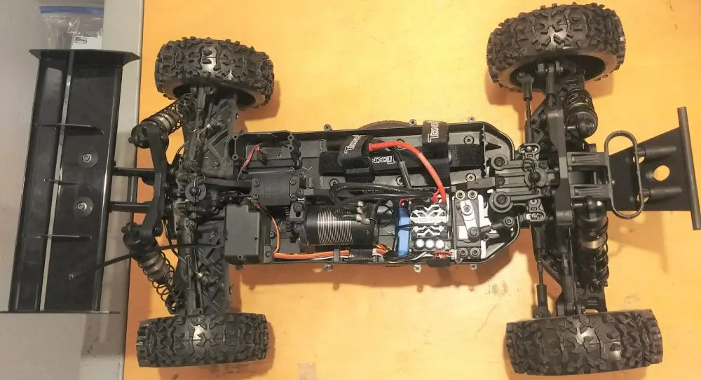

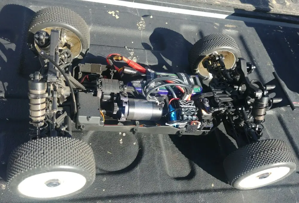

With the SCT410.3 going for $280 (w/ Tower coupon) I couldn't resist and added one to the collection.
As much as SCT bodies look cool, they are functionally quite poor so I was hoping to fit a Lead Finger ET410 body, but it surprisingly turned out to be quite a bit too short. I think an ET48 body will fit with some trimming so that may be in the works.
Tekno 17mm hub adapters (as I have tons of 17mm wheels).
Tekno SL wing kit and wing
Tekno 44t steel spur gear
Castle Creation Mamba X ESC (running 4s)
Holmes Hobbies 2100kv Puller Pro 540-L motor w/ 17t pinion
HiTec 7955TG servo running on 7.4v
Castle Creation 10a BEC
Sprung for 4500 4s battery, still 1/2lb lighter than EB48!

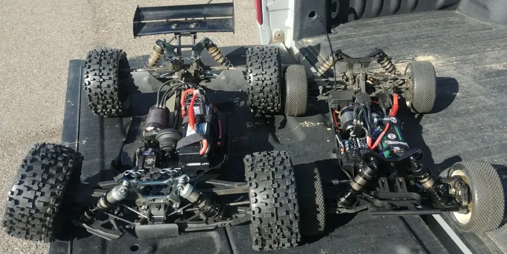

Initial shakedown/break in went well, this thing screams! Accelerates and brakes superbly, probably due to the light weight. Much better than the Mugen Truggy which busted a lower arm....:cry:
Excited to finish this beast up and get it on a track.

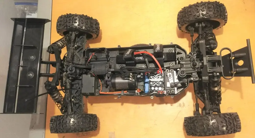

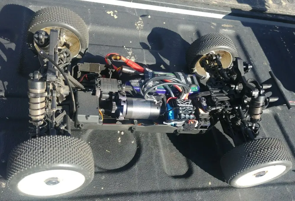

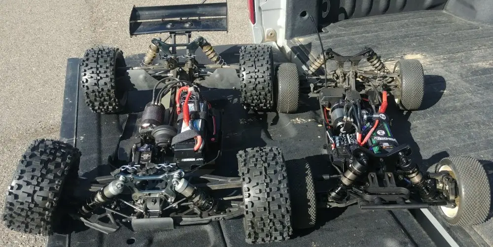

The Mugen has a pretty short wheelbase huh? Nice trucks! I built my sct410.3 to try and utilize both 3 and 4s..I've found 3s to be plenty for my small area, 4 was just crazy. Enjoy🍻
