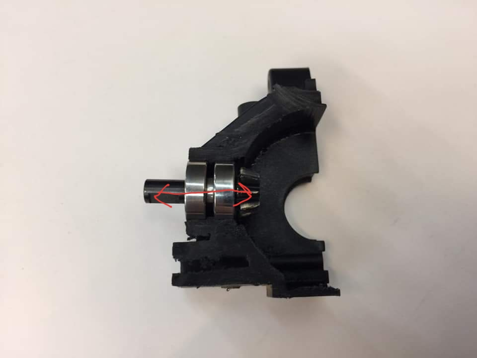

It's hard to say what is wrong, just from that description but if you posted a picture that may help us get to the bottom of things.
There shouldn't be much if any play on the pinion at the diff cases. Perhaps you just need to snug the outdrive up to the pinion a little more?
2279
Ill use that picture, only difference is mine is assembled.
When I move that shaft or even put pressure on the drive up I can feel it become notchy on the diff inside.
I had thought about making the drive cup more snug to the bearing on the shaft.. that would sort my issue I just didn't think it was a good idea to put it too close.
There is a bevel in the cup so it contacts only the center of the bearing. You want it snug.
If it still feels notch once you snug it down then I would check/adjust your diff shims.

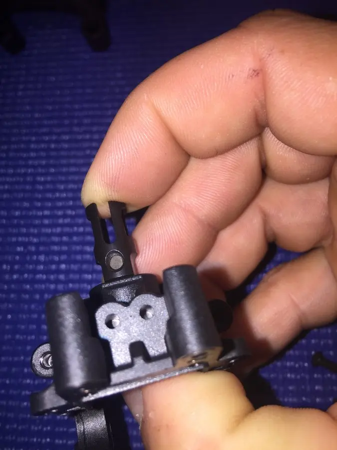

When its disassembled pinch the pieces together like this. Not super tight just snug. Use your thumb to put pressure on the pinion while your finger presses the cup. Tighten it all down when you are happy with the fit. Don't forget to use thread lock!
This is the diff case for an ET410 but its the same principle and its how I do all of my rigs.
2280
Cheers guys, pulled the diffs back out and moved the drive cup.
It's perfect now :)
