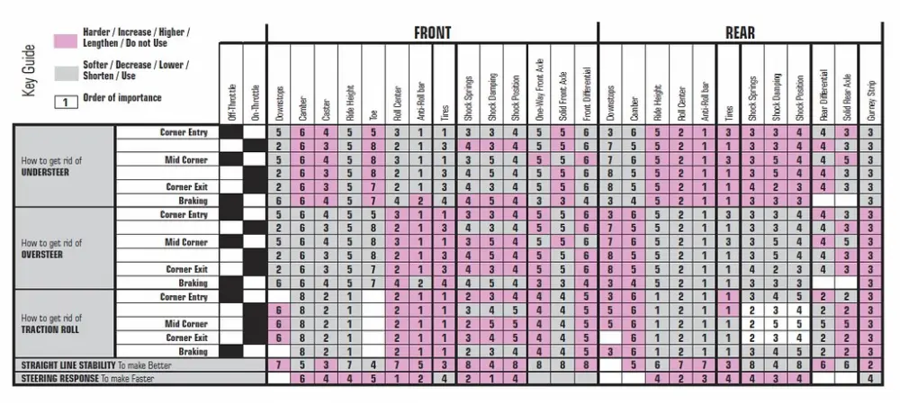

consider using the following chart from Hudy to help prioritize the tuning changes for what you need the car to do, though this guide is indented for on-road, I've found it very helpful for off-road where there are some off-road tuning options not provided here but this will often solve what you need for 90% of the time:
^Thanks! This is super helpful. Glad to see I'm generally on the right track. I totally didn't think about roll-center, I'll add that to my list.
