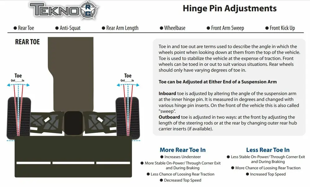

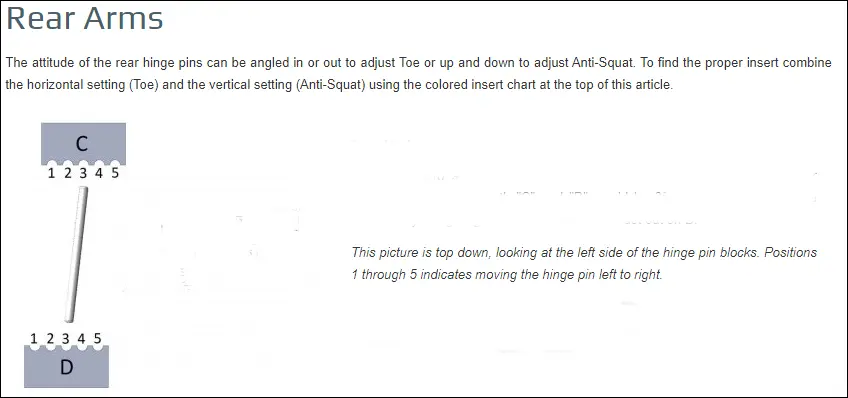

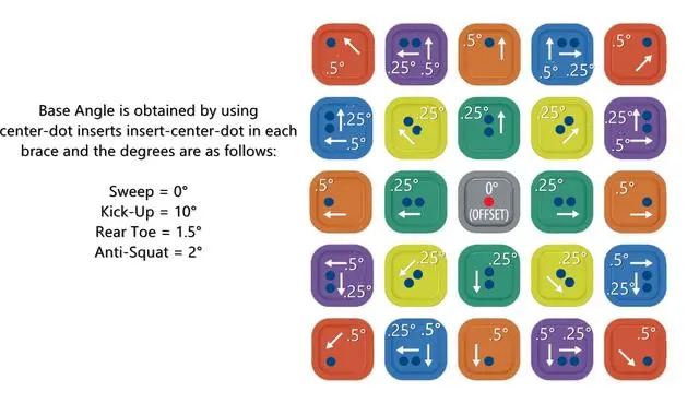

Can anyone explain what effect replacing the rear d block inserts with something other than the stock center dot offset will have? What is the most common or best set up. Provide pics if possible so I can see orientation of inserts.
Here you go:
https://www.teknorc.com/wp-content/uploads/2014/06/Set_Up_Guide.pdf
**The ABCD blocks are different on the ET410 & ET410.2
The base angles stated above are for the ET410
Using the center dots inserts on the ET410.2 CD blocks will give you 2° toe base angle.
