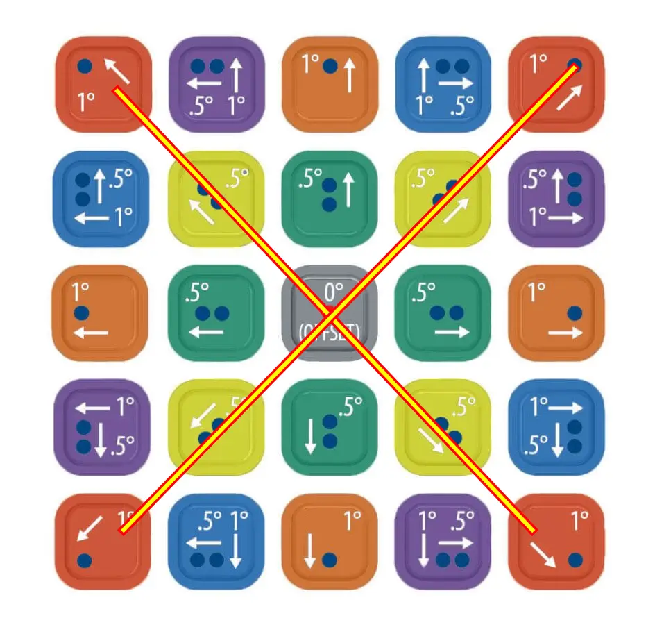

Stock rear toe is -3.5° using center dot inserts so you would want to move the hinge pin on C block in 0.5°, or the hinge pin on the D block out 0.5°
Edit: This is the correct insert chart...

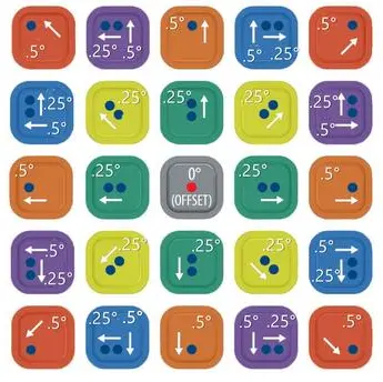

So I just realized there's a mistake the SCSL manual by reading your post. The chart posted above is correct for our 8th scale vehicles but it is not correct for our 10th scale line. On the 10th scale line, each single dot is only 0.5° and each double dot is only 0.25°. So, to get 4 degrees of toe on the SCSL you can either go to the single dot out on the D block, single dot in on the C block, or double dot out on D with double dot in on C. I'll pass the info along so we can get the online manual updated.
Having said all that, even a quarter of a degree change is noticeable on the 10th scale. I would try just double dot out on the D or double dot in on the C. I would go in on the C as I always prefer a narrower pivot.
