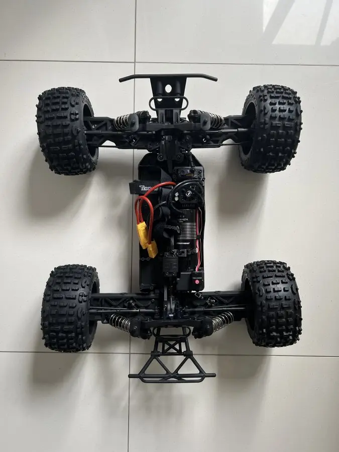

I’ve now completed my build, all bar the body and I have a question regarding the front and rear toe adjustments. Everything was set to stock but looking at the front and rear they seem a bit off? The front especially has quite
a significant toe out, the rear is toeing in. I have the backflips 4s. Please help
its normal to be out in front about 1 deg and around 2 in in rear. but your front looks a bit too much out.

I thought the front looked too much toe out, I will adjust it for more toe in, is there a tool to check exactly the degrees? Thanks for the guide.

you can use a square and a camber gauge to get pretty close within a degree. since you're just bashing this isn't too important. you could just eyeball zero degrees (straight) and it'd be fine. usually i just eyeball it so that i can tell the fronts are just barely toed out (not quite zero) and its spot on 1 degree each side. but again for bashing, doesn't mater. even the fast off road dirt racing i do it doesn't matter much - most of my effort is staying on 4 wheels rather than having my steering perfectly set up! if in doubt just eyeball it to zero, turn each turnbuckle a half turn and be done.

Eyeball method is what I ended up doing :)
To add to it, because of bump steer/camber gain being effected by mounting location, and steering linkage height, I'd eyeball toe and camber while battery is onboard and ride height is set.;)
Just the other day I was fiddling around with setting ride height after doing teardown/rebuild on a buggy & truggy. I took notice to the amount of toe difference at full droop/chassis being bottomed out. I can only guess at the amount of change, but I could definitely see things moving in/out a good amount.
