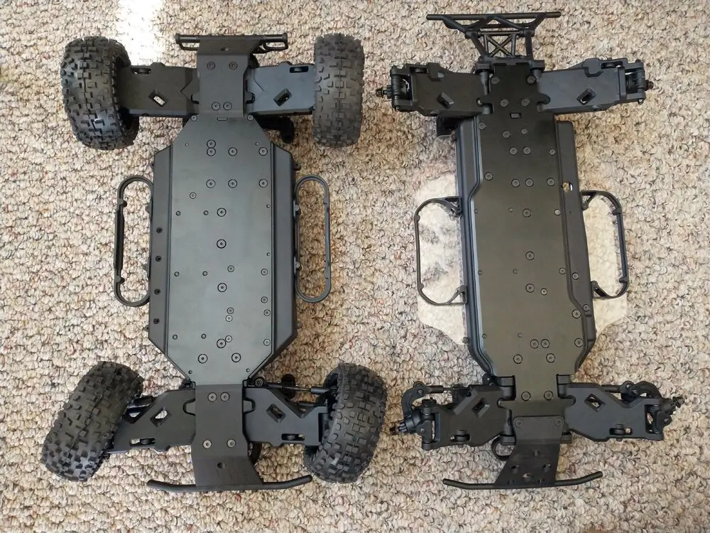

From plastic side guard to plastic side guard, there is approximately a 15mm difference between the two platforms. Is it good, or bad?

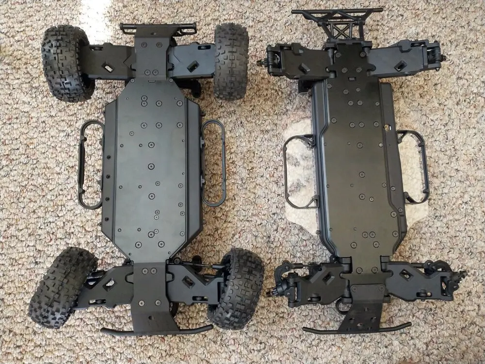

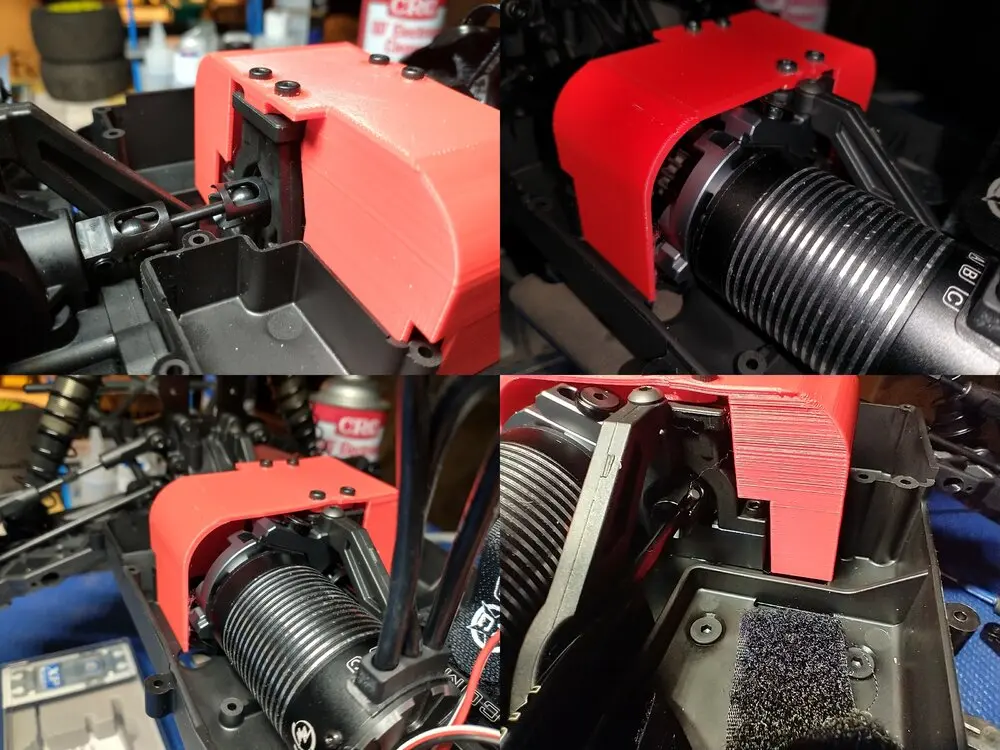

I printed a cover (from thingiverse?) for the SCT410.3's center diff, and there's a lot of little gaps for stuff to get into. It would need some work to minimize the gaps.
I think that would be worse, in my case, than just leaving it open as I got tons of crap (pebbles) that jump onboard my rides. If you got a stl file of the SCT410.3's guard, I like to take a look at it.
