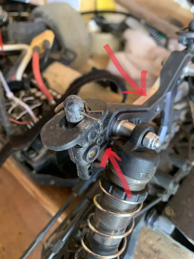

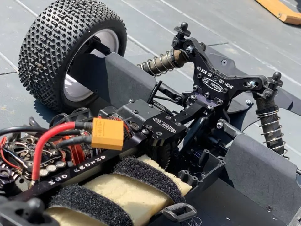

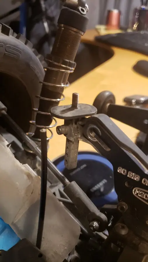

i would suggest the M2C tower braces for MT410. They allow you to strongly hold the plastic body mounts between the tower and the brace.
see the front brace in light silver color, They also add screws in the mount . In the picture below I am also using the Arrrma body posts, they just need a bit of grinding to fit.
Here is the back tower with the go big or go home M2C kit.
you see the square post where your arrma body post fits into in your pic above, that's what breaks on the mt410. I got all the m2c upgrades except the wide body chassis but got all the braces, etc. chassis fine just, when the top of the body hits the ground it breaks the where the body posts screw in. tomorrow a bunch a part arrives for the revo body, am gonna try to use a revo body and body mount parts to see if I can adopt it to the mt410. We'll see . . . and yeah i check out the revo 2.0 and was not impressed by the reviews. And the new arrma kit (don't recall the name) looks like it gots some flaws. seems nothing comes close to the mt410. I love mine! just wish it had a better body mount design or I just get better at bashing and stop landing on the roof lmao.

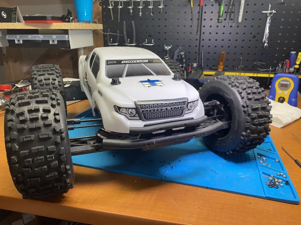

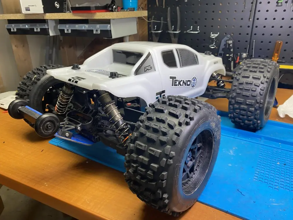

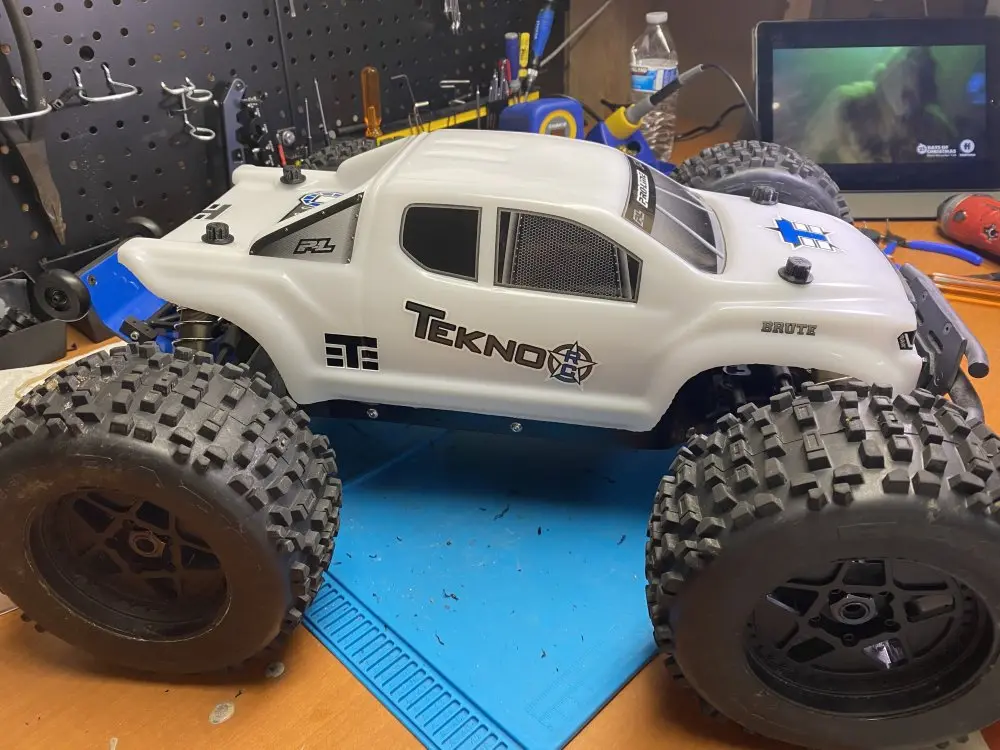

Return the ERevo body and get the outcast brute body. I just did what your attempting and the outcast body fits with very minimal trimming to the rear mounts. The mounts just don't line up on the ERevo body without a lot of modification.
