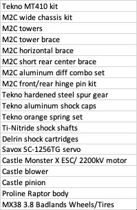

Newbie here...just started an MT410 build with the parts below. Any suggestions or tips? Different parts? Additions?

Personally I like the yeah racing dual fans with aluminum framed fames and the tekno pinions but I like the other castle products a lot.
And an aluminum servo horn is a definite must!
