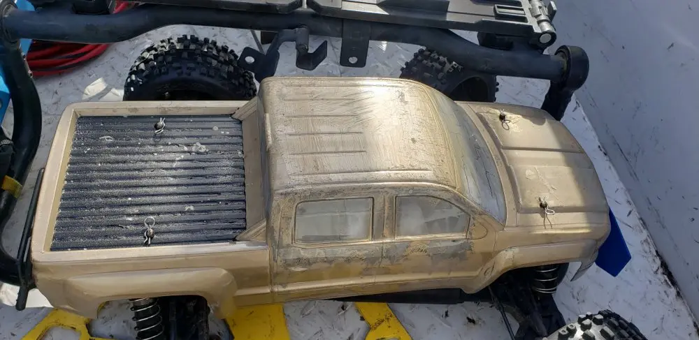

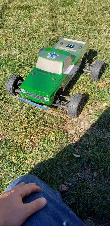

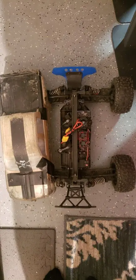

MT410:
Tire: backflips and badlands, until I get better I am sticking with the badlands kept flipping on them back flips ... go figure.
Currently running the arrma 2-ho truggy tires to learn and drive better
Motor: hobby wing ezrun brushless 2200kv
ESC: hobby wing max 8 150a
Servo: powerhobby 729mbl (this one I should have went cheaper now that I understand the part better)
Batteries: 4s lipo 2 6200mah Zeee and one Lectron pro 5200 both are nice I will see in the long run
Pinion: worked my way up to 17 I like the feel so imma stay
Transmitter: Flysky fs-gt5 + receiver I like it but I also have no comparison.
Body: proline checy extended cab (no idea what i was doing when I painted it and a longbed chevy reinforced.
Accessories:
Motor heat sink with high rpm fans ( seems to be working well, not really heating up) putting o. The yeah racing heatsink and fans tonight.
Metal spur I didn't trust plastic though the more I read I realized it held up well so now I have a spare
Metal servo horn ( I heard those go out a lot)
Metal shock caps since I cross threaded. got 60wt and 50wt oil for when I replaced em and orange springs
Tower to tower support bar from T-bone as a preventative measures
Front bumper from T-bone since I broke mine in 5 minutes playing chicken with a parked car.
