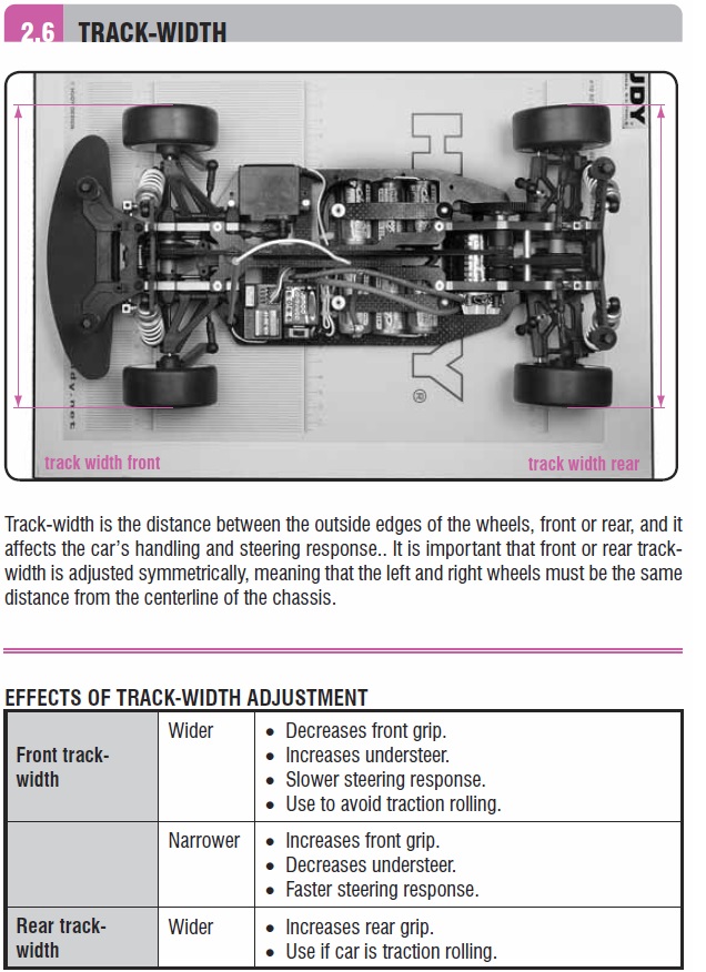

They will increase the track width, more info here from HUDY on what that does:
I am using them so I can use associated 12mm hex wheels. These will widen the track a bit on the EB410?
