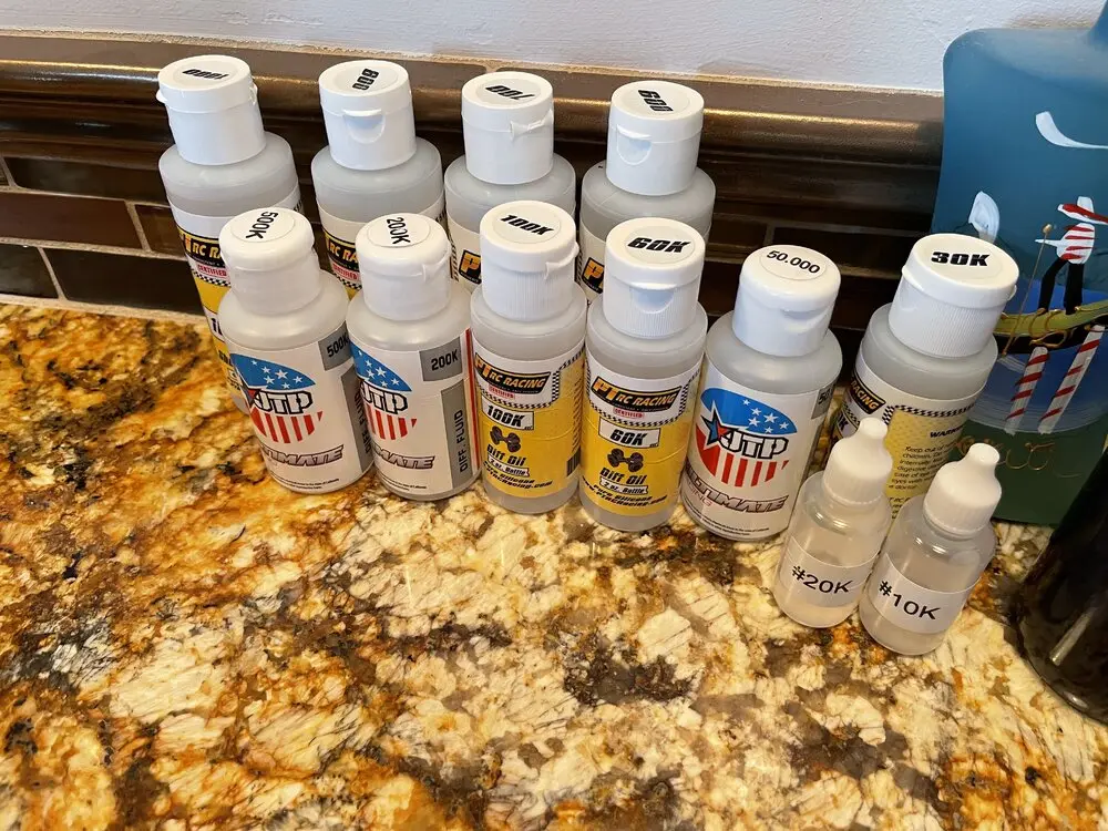

If your willing to shop somewhere else I’d recommend PT RC Racing Shock and Diff Oils or JTP Diff and Shock Fluid - They are all in CST and pretty much equivalent to the CST weights in the kit.
https://ptrcracing.com/
https://www.shopjtp.com/
Don't overcomplicate it by comparing different brands and cst and weight charts. Pick a brand and stick to it so any changes you make are consistent. As far as I know there are no standardizations for rc fluid weights. Personally most of my fluids are Team Associated, with a couple of Traxxas and Flash Point mixed in due to availability. If you use Amain and go to their oils and select the Associated shock oils they show you the bottle where it list both weight and cst. So you can for example select 55 wt and see it's 725 cst. Close enough. I believe they're diff fluids show as cst only. If you choose another brand use their chart if they have one for their oils.
Find the Traxxas shock oil CST to be closest to what the manual calls for. When talking 100k, think a little difference will not matter. Shock oil gives the biggest gain or loss in performance, I think, and why I looked and could only find the Traxxas oil CST to match.
