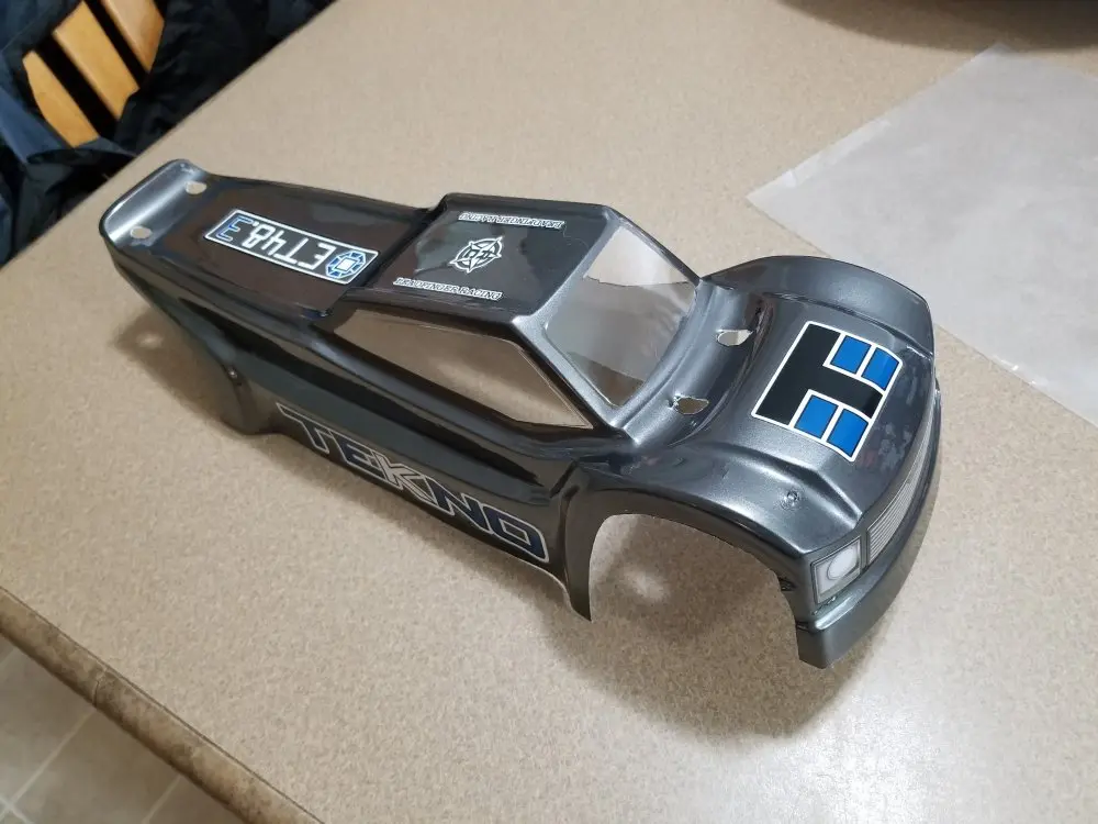

Leadfinger Racing is also releasing the "strife" body for the et very soon. I bought the Assissin recently and am happy with the purchase.

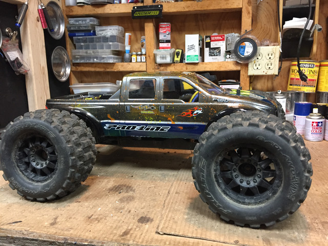

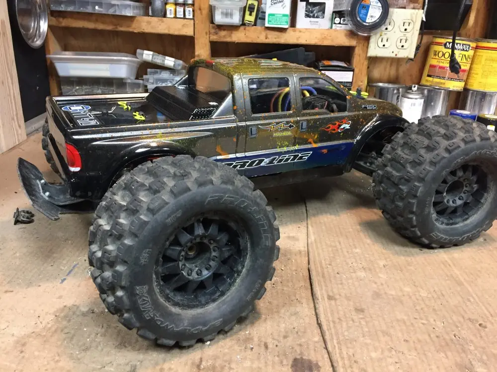

Here’s a few I have. Proline F650

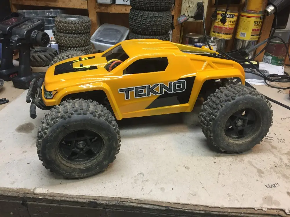

well i ripped it on the second wheelie because it scratched the ground but i glued it back arround the body post and putted the spoiler back and it's all good now. It just don't have the MT look anymore but i don't care, i have an MT410 for that.
My truck is a pure ET48.3 with stock body posts not an extended MT

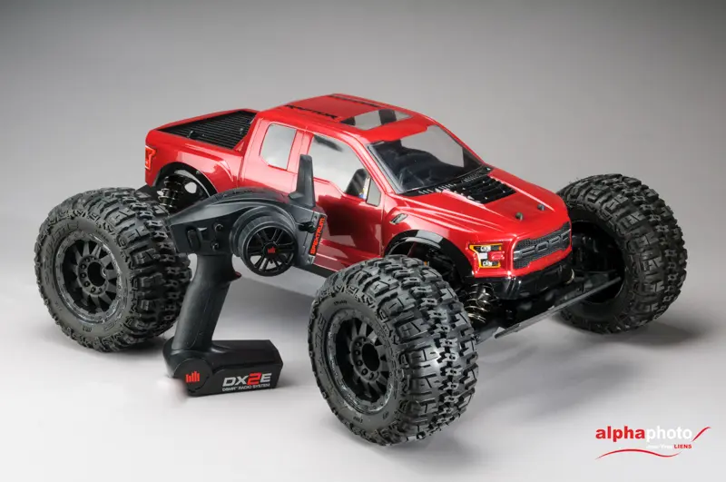

Proline Ford raptor
That's for the short wheelbase MT chassis though, you can see how far back the front fender is.. looks ok from that angle but take it from the side and you can really see how it doesn't fit the longer wheelbase well. Mounts OK though so i guess if it works for you it's all good.

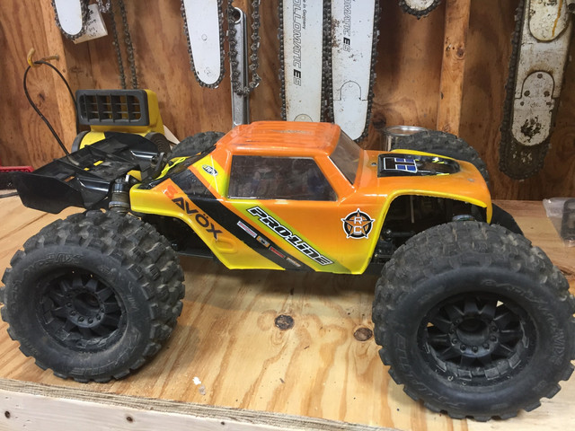

The Pro-Line Slipstream was a good fit. Unfortunately discontinued but if you can find one it's an option. Looks good with a wing too:)

Out of the 3 bodies I have I’ve run the f650 the most, by far. It’s reinforced, and quite thick lexan to begin with.... its held up very well. I have a T-bone front bumper on the rear for protection
