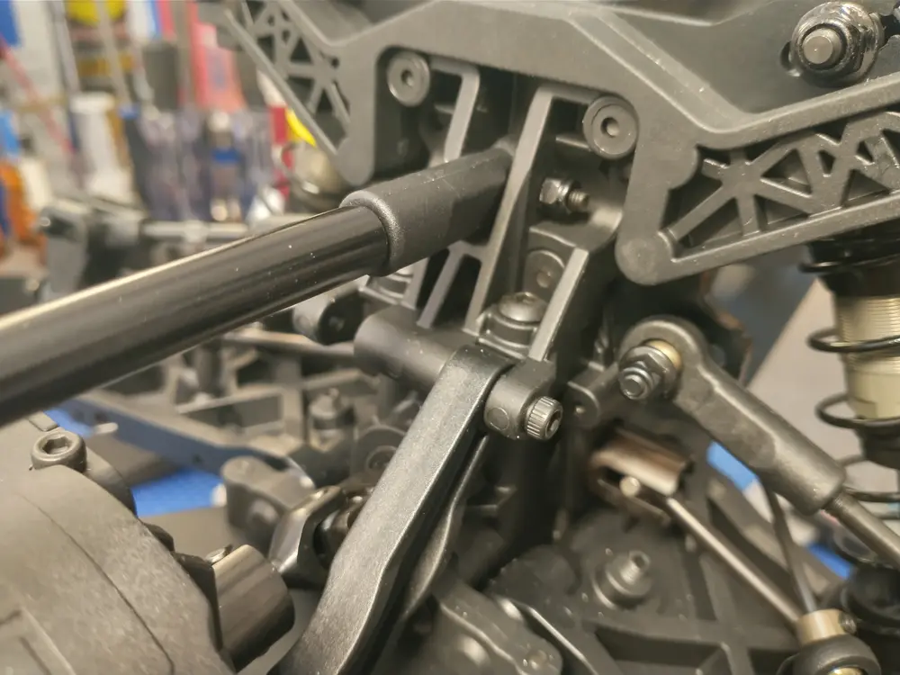

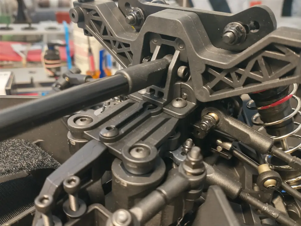

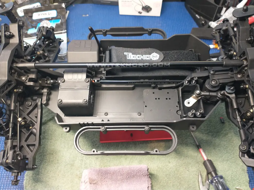

I picked up the chassis brace TRK9585. I'm looking at it, and I just cannot figure out where it's supposed to mount. Is anyone running this extra support and have a pic of it installed?
*Edit* Forgot the old rule, just take things out of the way until it fits. You only need to pull the shock towers to slip that brace in. Maybe this will help someone else.
That brace is only used of the SCT410 2.0. There is no mounting on either the SCT410 .3 or the SL. On the 2.0, it mounts on the at the top of the gear box where the shock towers mount.
