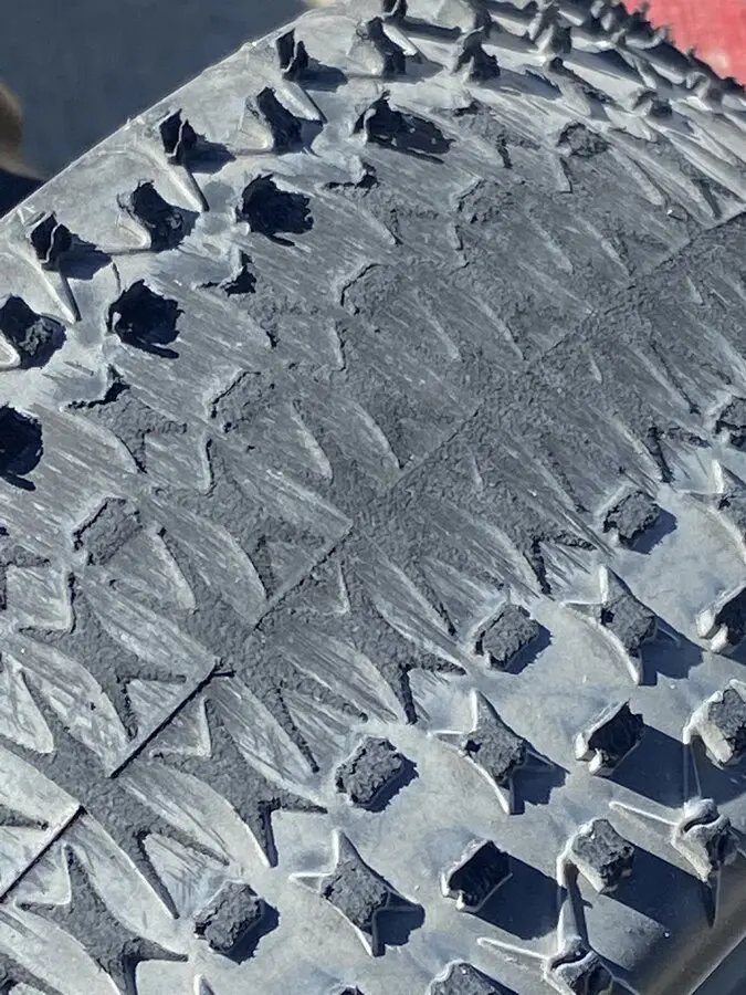

Drained two 6000mah on the wrong tires on pavement and has a blast the whole time:

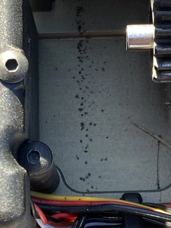

This was my first run with the ET48, and I noticed a leak in the differential:
The black trail could be the grease on the shaft, but the diff itself is leaking as seen on the casing, the is a small amount of “wet” on top as well, under the spur gear. Is a little leak expected/normal or do I need to fix something?
not uncommon to have a small amount of residual fluid around the spur when you fasten it... after 15 battery packs, I would change the fluid and inspect to make sure it's still full, if you had a significant leak, it would be obvious with a large mess all over the place, what I see above after 2 packs is nominal.
Thanks. I did remove it and what you are saying seems to be the case. There was very little silicone oil there, and the back grease is what was slinging around.
Also thanks for the tip to change after 15 batteries. I trust this should be done on all three diffs?
Yes all 3 diffs, wipe all the bearings clean and check for crunchy bearings, fresh grease all rubber seals in diffs and shocks, etc.
15 packs is a good benchmark to inspect your cleaning interval... if the fluid is still a bright grey milky shade then you can probably go longer between rebuilds... if it's starting to turn brown then that's the limit where fluid is breaking down and no longer functioning at it's peak... if it's black then you've gone way too long between rebuilds and risk premature wear of parts.
