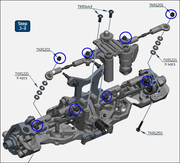

Not sure if anyone else is having this little concern or not, but I've noticed the front end's nuts coming loose after every six, or so runs. That area of the buggy (in my case) sees the most abuse; I'm sure of that. After last night's run, and giving the buggy a once over, I am now beginning to put some thread lock on the front end "lock" nuts (circled in blue).

Do those lock nuts not have a rubber ring inside them to stop them from backing out??
I'll take a look when my kit arrives and as long as both screw and nut are metal I'd probably go with thread lock too.....

The lock nuts appear to be the same as the previous generations, but maybe they switched sources and the newer ones are not as nice?
That would be a shame if I have to replace all of my lock nuts, but I was also looking for an excuse to install some extra color. That being said I will keep an extra close eye on these when I hit the track.
On the plus side they are easy enough to swap out if need be!

Yes, they have a nylon insert inside the nuts to help keep them from loosening.

Anyways, I haven't had an issue with nuts loosening since I began to use thread lock on the nuts circled in my earlier post.
