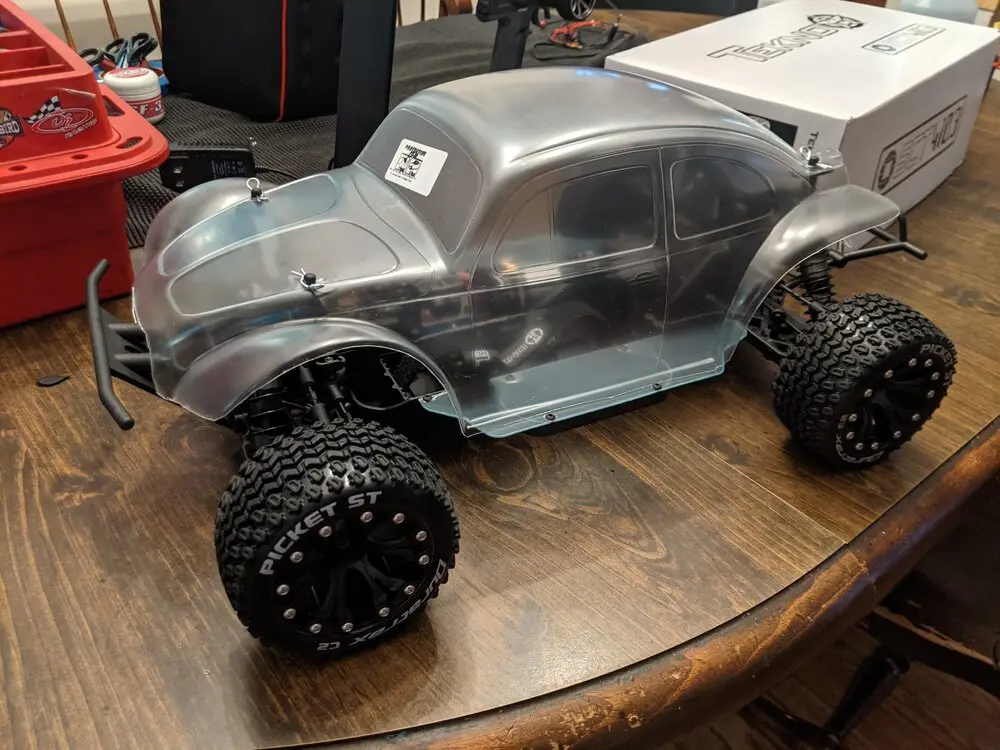

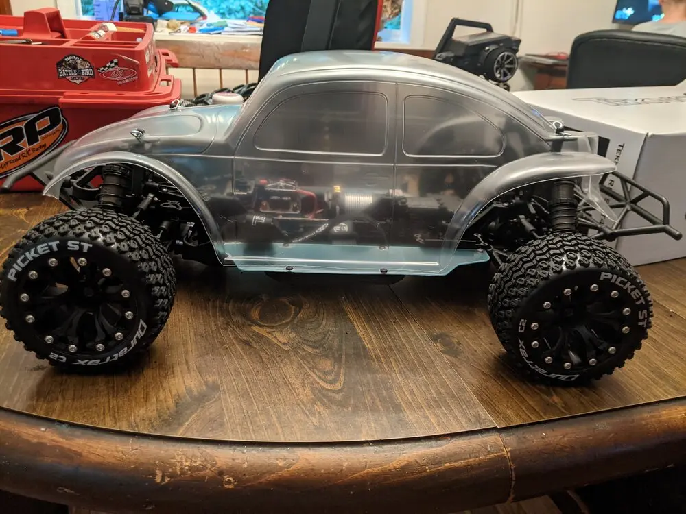

Ordering from lhs Friday. Would like to use the sct410.3 as a Baja bug platform. I'd like to use an eighth scale wing anyone know what wing mount would work on the sct tower? Also would 2.8 with 1/2 offset stadium truck wheels work on this chassis. I've got a bunch of durratrax wheels I want to burn up.

the 2.8mm .5 inch work on it. At-least it did on mine. i did however break a number of "A" and "C" blocks also stripted out the plastic servo horn out almost immediately.

Awesome glad to hear the 2.8's will work I have a bunch to burn through. I ordered all the aluminum blocks and servo horn for assembly. I'll be off work for awhile starting next week so I'll have time to do the build. Can't wait

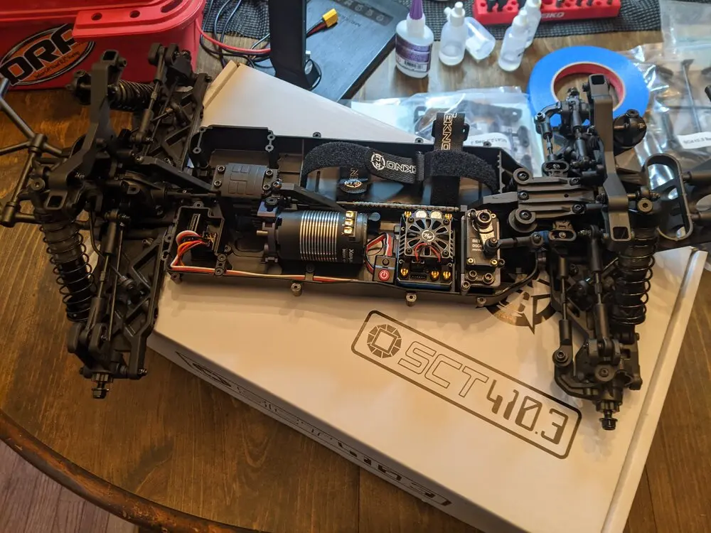

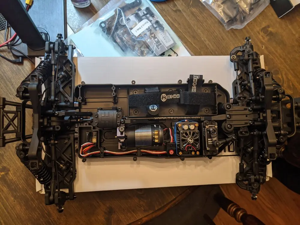

Made some progress today. Really nice build. Some solder, paint and some final tweaking and it's ready to go.
