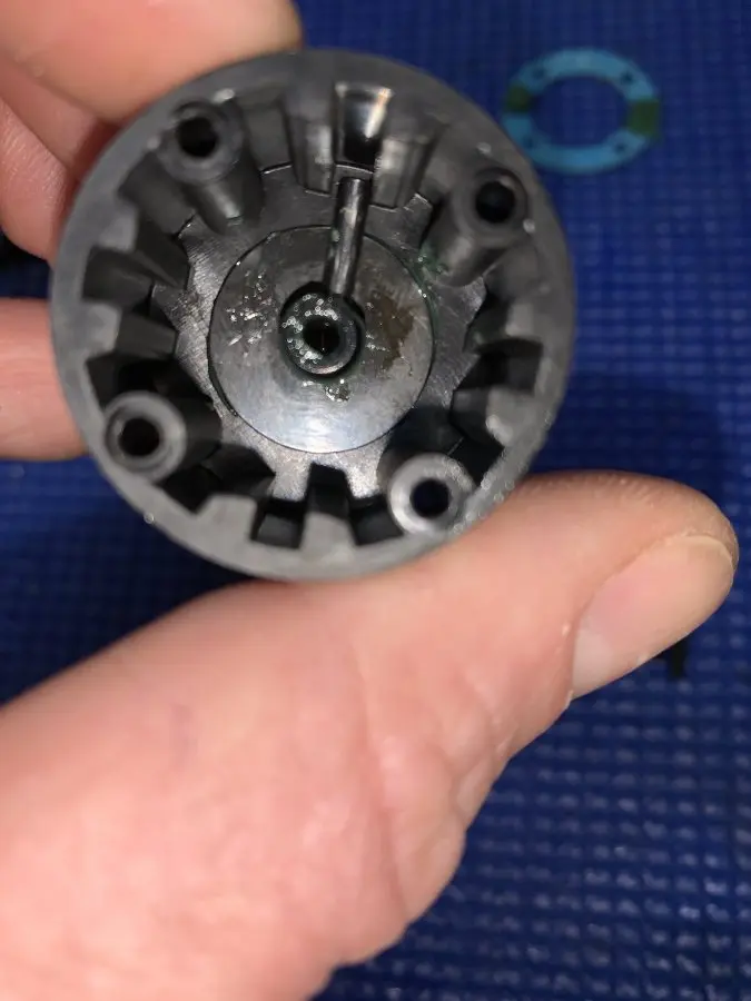

Humbled already. A-Bag, how do you get the pin for the outdrive in on the diff. case side. It seems too long to be able to lay flat and get it into the outdrive. I messed up a tiny bit before I understood how the parts went together so I got diff 7K Diff oil all over it and its kinda slippery. But I can't understand how to get the pin in.
Line it up like this.
I used slant tip tweezers to grab it and shove it in the hole. Needle nose pliers would work too, if they're small enough. Make sure that the pin sits straight in the groove of the gear that sits on top of it - otherwise, the top won't sit true and you'll have to tear the stupid thing apart and rebuild it. I don't wanna talk about it. lol
Alright, thanks guys, I think I got it figured out.
