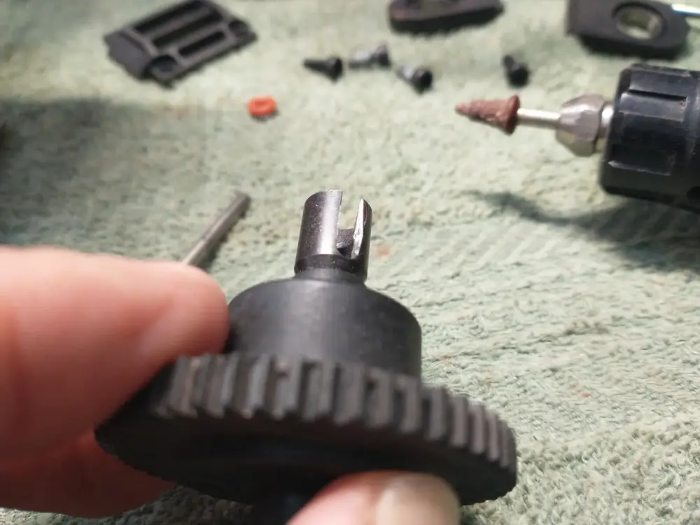

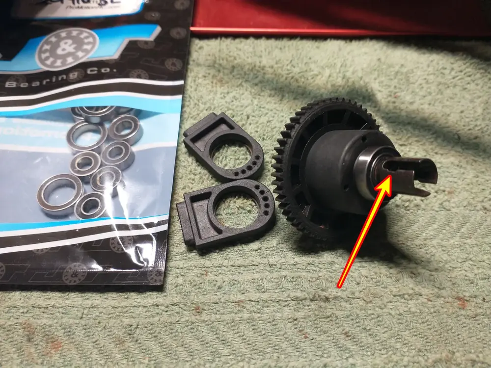

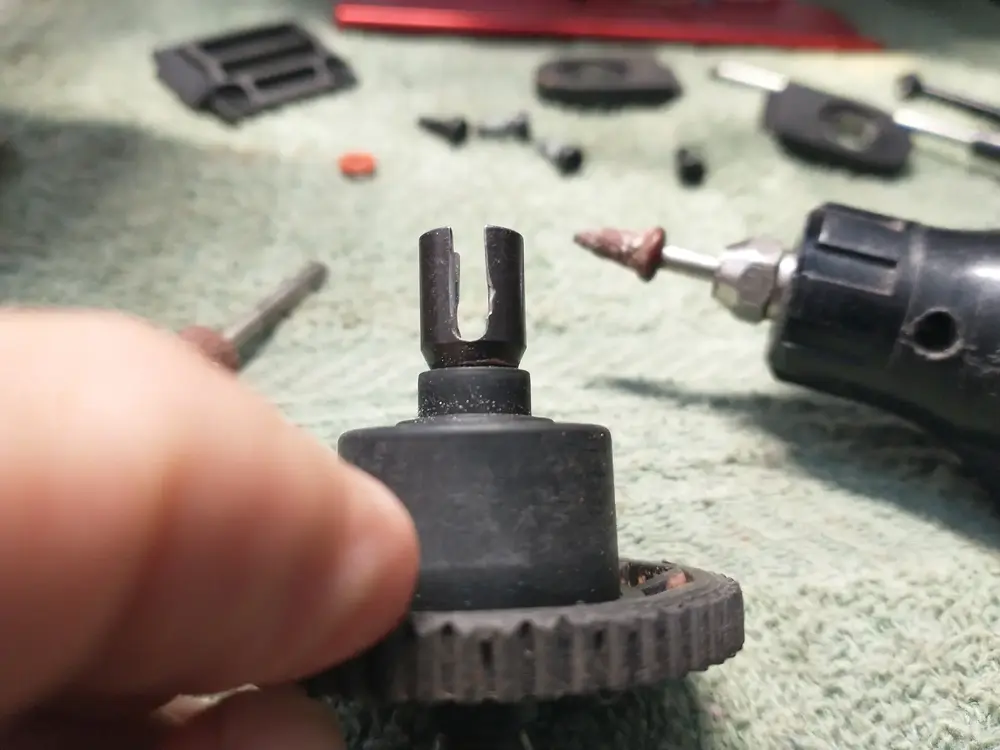

I got one diff outdrive that is looking rough.
Dr.Emel (rotary tool) to the rescue... I just smoothed out the harshest spots so that driveshaft pins won't 'grab' the same area. That's my hope anyway.
I'll definitely revisit this later in the year as things get going.
