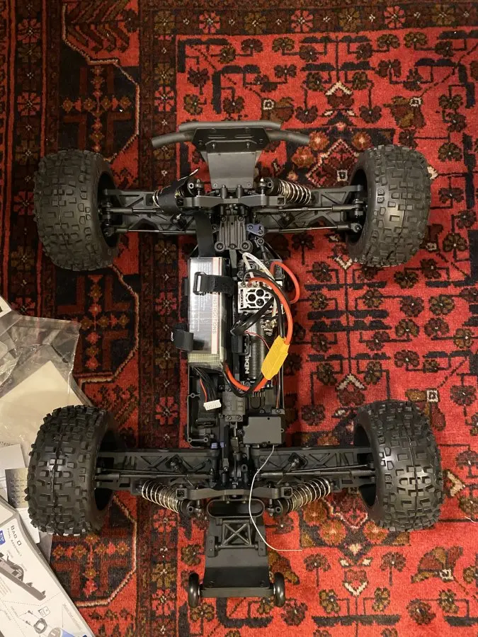

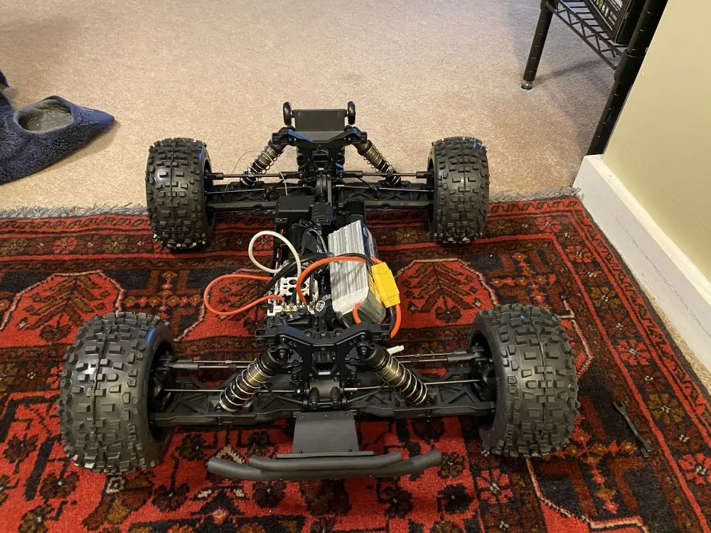

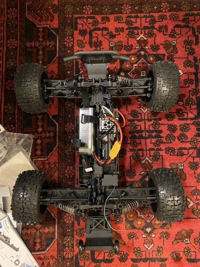

Thanks to the help here I’m nearly done with my first ever build. Photo below and excuse the ?soldering! @Nicochau I went through with it!
1. Suggestions on ride height and shock adjustments?
2. Any toe / camber suggestions? I still need to adjust mine as you can see it’s out.
3. Anything else??? Can I send it now?
Looking good!
I do a bit of toe out (like 0.5 deg) and -2deg camber all around.
Ride height is set when arms are perfectly horizontal.
3. Anything else??? Can I send it now?View attachment 5671
Looks good man
in my experience running the battery in that position is not good.
The yoke on the center diff will rub the cables. I always have my cables facing forward. I think it is just safer.

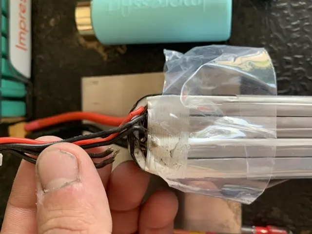

but that is a issue I have were most of my battery’s are very close to the open driveline and yokes i had my balance port get eaten up on the first run

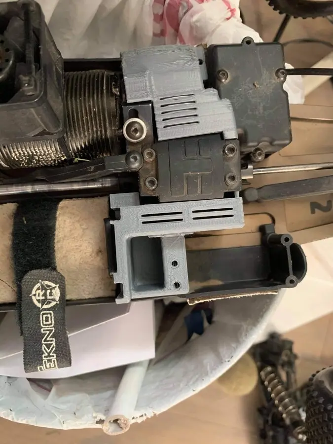

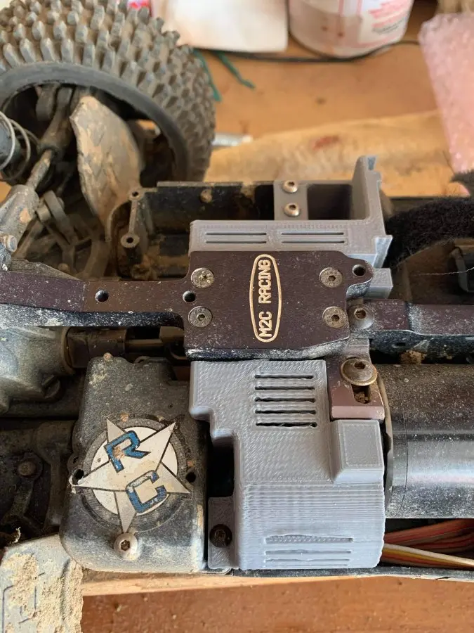

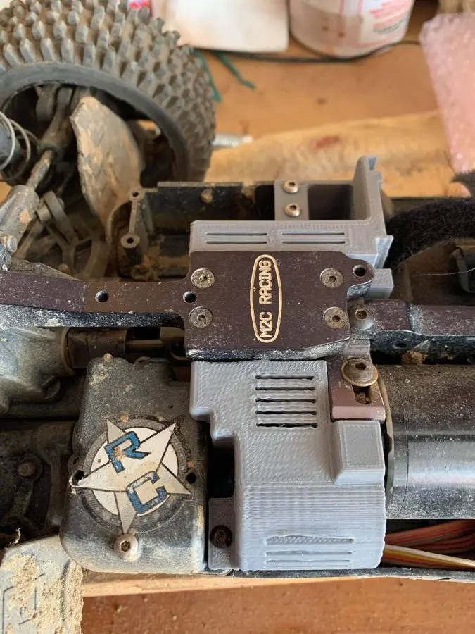

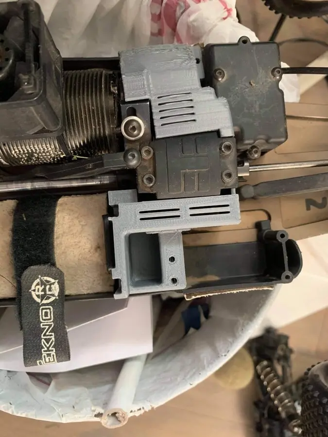

You can also run those parts that people 3D print to help contain the battery. I personally don’t like to pinion cover, but run the battery side as a good way to keep battery connectors out of the driveline.
also, always strap connectors to make sure nothing is shewed up.
Looking good!

Looks good man
Thanks. I’ll do that

I will look into the battery side cover thanks
Hey I got the same results got the battery cables chewed up. I did fix the battery. removed the shrink wrap, soldered new wires and connector adn re-shrunk wrap. Works fine but now it's always oriented as you mentioned and works fine.
