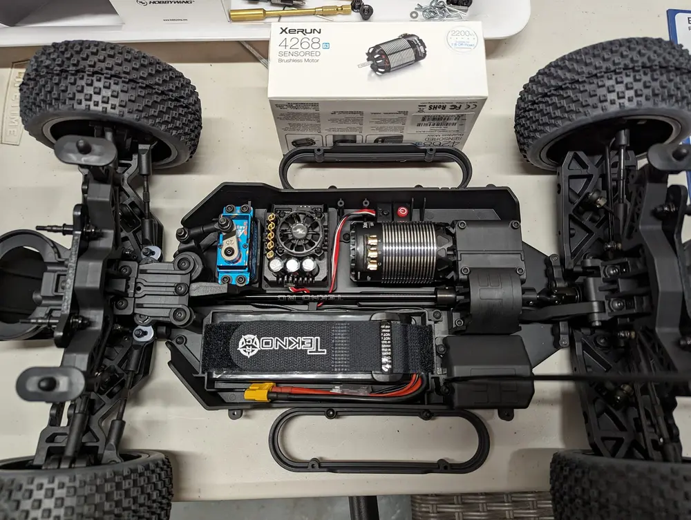

Not mine, but...
Thanks @RustyUs, I already placed an order, so I was gona make it work one way or another :ROFLMAO:
The XERUN XR8 Pro G3 should be slightly slimmer than that aswell.

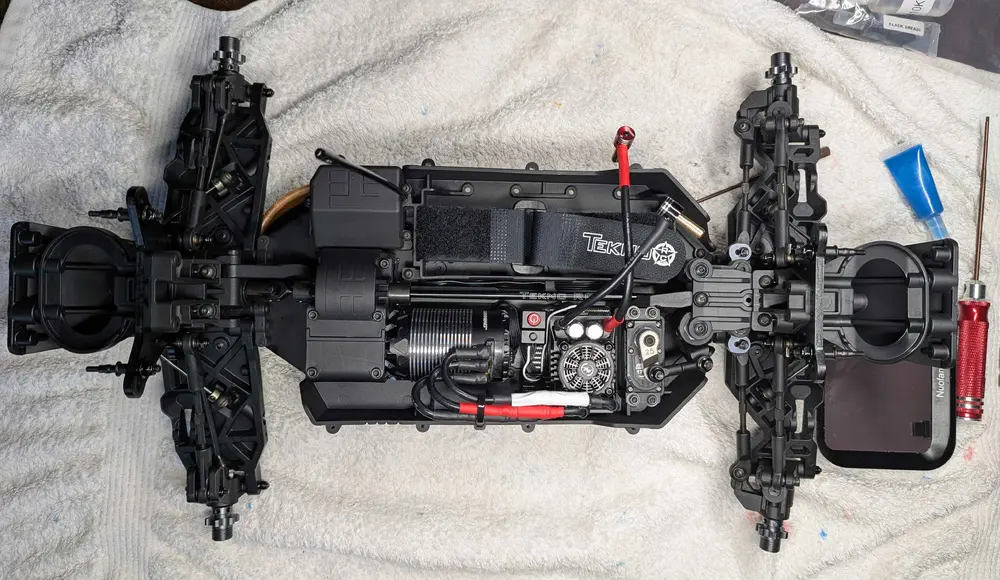

No issues with stock mount & the XERUN XR8 Pro G3 / 4268SD 1900kv G3 Motor Combo:

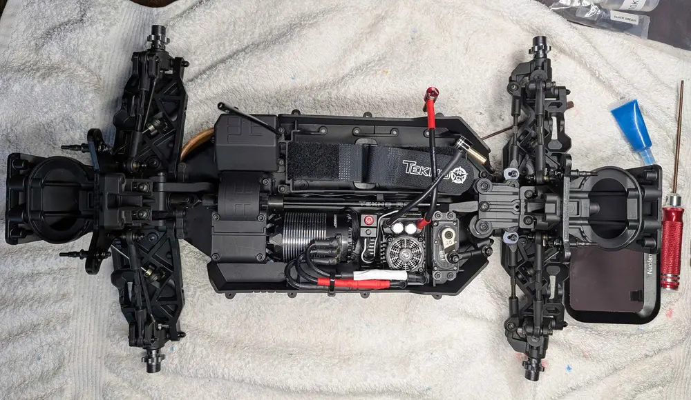

Awesome. I had no doubt it would fit... it is the gearing that maybe comes into play with a larger can. I am guessing you'll be using something close to a 17T pinion gear.

Yeah was a relief first mounting the motor. With a 1900kv I went with a 16T @4S (will be using LipoHv packs). I can adjust the throttle curve and amount on my Noble transmitter is it gets to wild.
I ripped it around my kitchen last night seemed very peppy :ROFLMAO:

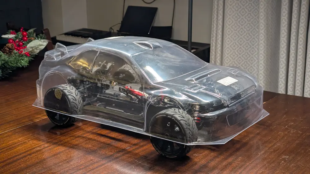

Still have alot of work to do with the body & also plans for custom foam bumper and roll cage.
