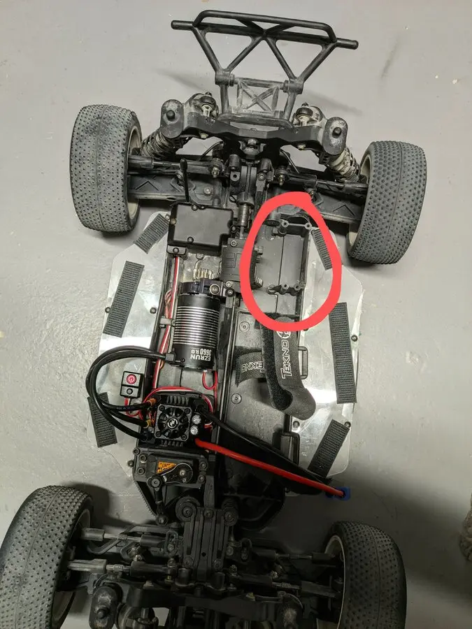

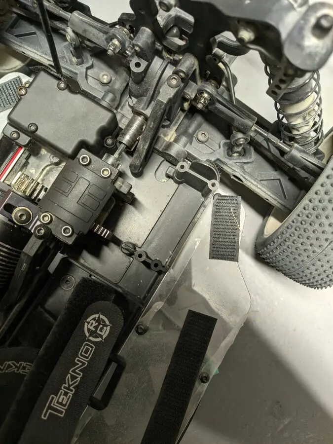

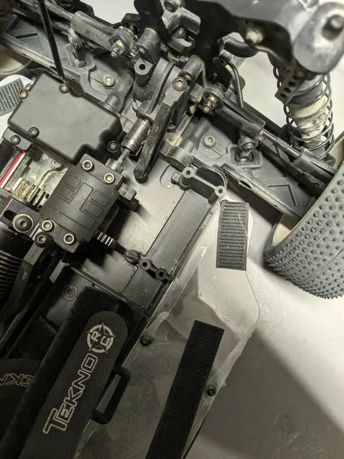

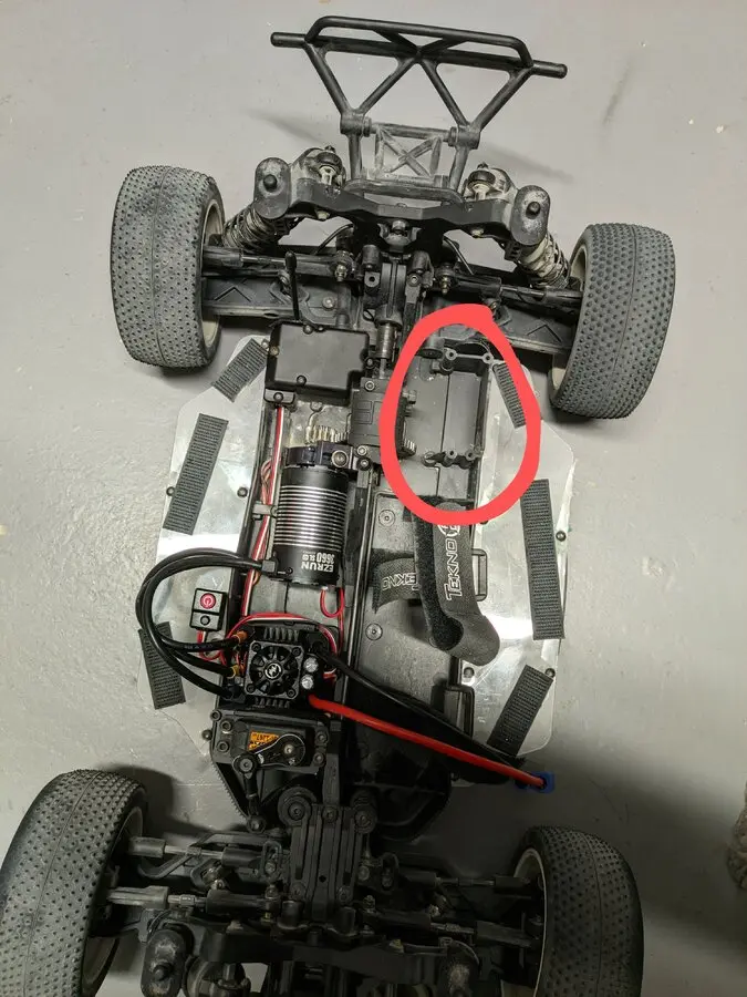

So i was building my mt and i saw this thing that looked like a servo mount but that was on the other side guard? What are you supposed to put here because the manual doesn't tell you.
I believe it is space for an extra servo that would activate brakes (nitro style).
No one really uses this in electric, because the motor acts as a braking system. I did hear some guys like the feel of independent brakes or use it to reduce battery consumption (braking seems to use significant power).
+1
TEKNO has discontinued the mechanical brake kit:
https://shop.stormerhobbies.com/product-p/tkr5206x.htm
When LiPo was first introduced the run times were abysmal so the brake kit allowed roughly 25% longer run times, but over time battery technology would replace the need for the upgrade as capacity and C ratings increased.
The 2.0 kits no longer offer this feature.
