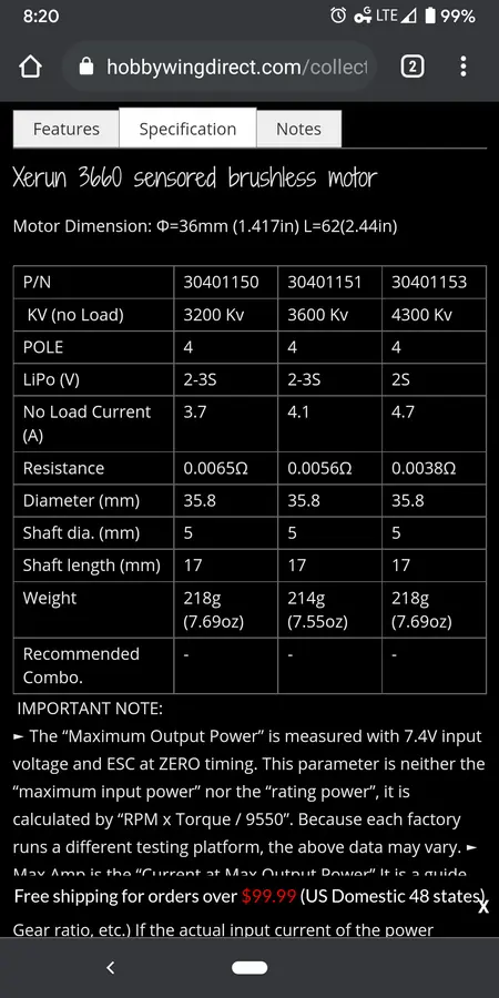

I’m considering going 4s.. will that motor get to hot?
Might be a bit much for 4s. I think on the Hobbywing website it shows 2-3s for that motor.
Might be a bit much for 4s. I think on the Hobbywing website it shows 2-3s for that motor.View attachment 7404
Yes sir, you are correct. I did check the website and that’s what I’m seeing.

Thanks for your reply. I’m thinking I’ll go ahead with the XR8 3200 combo with a 15t pinion. I also plan on adding the C1 heat sink fan combo. I’m not a speed runner by any means, just trying to get the best torque/speed I can.😊
