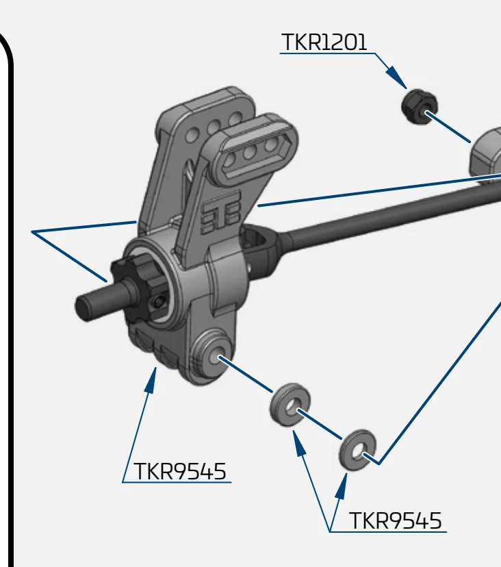

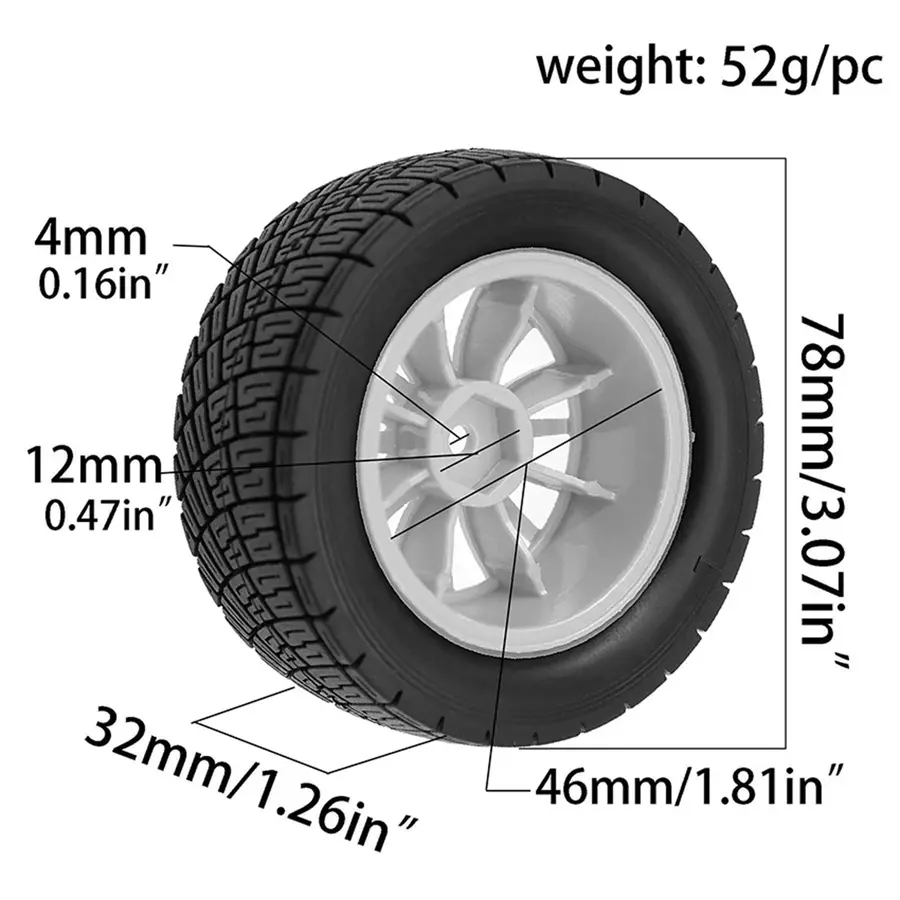

The wheels are where you are going to have issues. A standard short course wheel (not the tire) inside diameter is 3 inches. For a standard short course truck, the inside diameter of the tire is tall enough to clear the height of both the front and rear hubs.
I recently tried to transform the tekno 1/8 buggy into a 1/10 short course truck and the inside diameter of a short course truck tire isn't large enough to fit over the front c-hubs.
That said, I was able to fit the Rlaarlo XTS-10 rally car tires to my SCT410SL. If you're gonna use a rally body for a short course truck, look up the wheelbase and track width for the SCT410SL.
