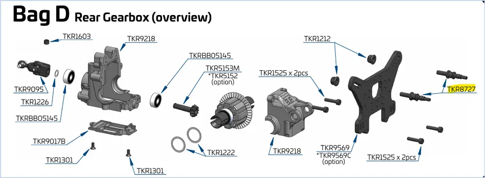

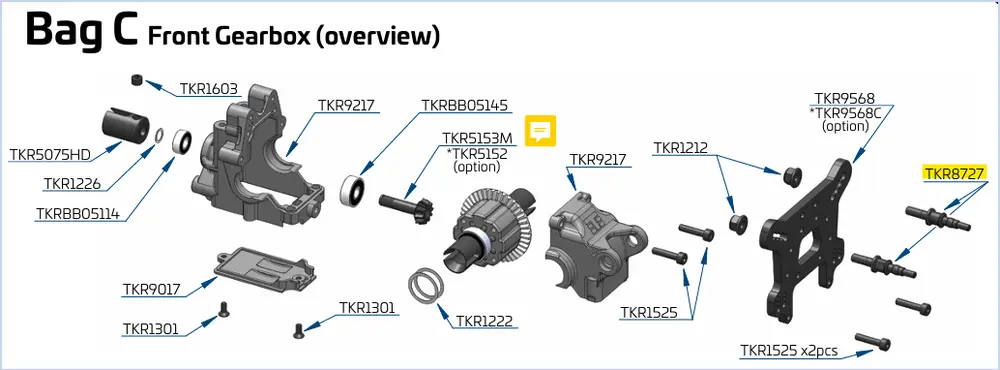

Part number TKR8727 is not on Tekno's website anymore.

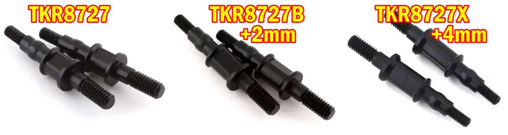

With these close-up pictures, I can see a distinct difference now. I'm guessing the TKR8727 is 2mm shorter the TKR8727B.
My gameplan is this..... TKR8777 (0mm) Shock Standoffs
Keep your Tekno RC vehicles running at peak performance with our new shock standoffs. Instead of the previously used M4 nut, these standoffs attach to the shock tower with an M4 screw for improved durability. Our tests have shown them to be significantly stronger and more likely to withstand a direct impact. These new standoffs are CNC machined from high-quality steel and have a keyed shaft that accommodates the TKR1103 – Turnbuckle Wrench for easy installation. They replace the TKR8727 and require two M4x10 button head screws (TKR1443).
The TKR8727 shock standoff is back on the website again. That's a good thing, I think. Lots of talk about the newer buggy/truggy (two-piece) standoffs screws snapping... the front ones anyway.
