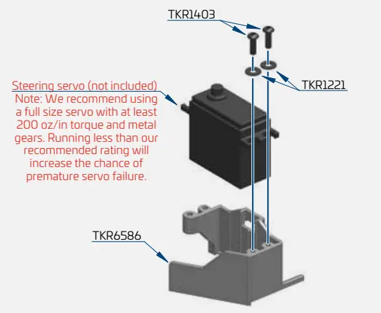

Hi, I bought ET410.2 from a friend,
I saw it don't have savor saver. Is there any problem with that?
Should we use servo arm with servo saver build in like we usually see in rock crowler?

You want to use the TEKNO aluminum servo horn, servo savers are no longer recommended:

Modern servos have come a long way where servo savers tend to take away too much steering response making cars feel "lazy" in sweepers. Just make sure you invest in a high quality servo where the manual recommends anything higher than 200 oz/in.
I highly recommend the Eco Power WP250T which offers 758 oz/in

Thanks, I have one spare Savox 1258TG, it's rated at 12kg, hopefully it can survive. If it died, I will switch to some thing around 20-30kg
I wouldn't waste your time with the Savox 1258, it won't hold up, start looking for a higher quality servo ASAP.
You'll want a solid aluminum case servo at a bare minimum. The OEM for the ECO Power servo I recommended above is JX and they have an older version that is pretty good if you want to save a few bucks:

@Lisa, I don't know what your plans are for your ET410.2 ride, but if any hard surfaces are to be encountered, an all-aluminum cased servo is not a bad idea. I personally don't run one on my ET410, but my mini truggy doesn't see extreme bashing either. I certainly think carpet, turf, and clay tracks put more harsh forces on things.
Maybe my lawn darting/cartwheeling mishaps on backyard dirt is the reasoning for my servo enduring the abuse? Maybe the plastic case is different/better composite than others? 🤷‍♂️
Thankfully, a person can find lower budgeted servos to cover all kinds of wants and needs these days. If I were spending big $$$ on a servo, I'd probably take on a servo with lifetime gear replacement warranty.
Thanks for the recommendations, I’ll look for a aluminum case servo
