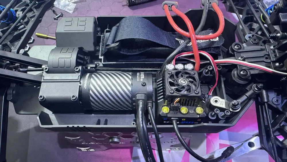

Modellbau-Metz in Germany very kindly sent me this photo and a description of what it would take to get the Max8 G2S to fit:
I'm not sure what you'd do with that sensor cable once it's hanging out the side of the truck though. It's nice to see that the long 4278 motor will fit.
Hi,
you can use the MAX8 G2.
There are only some small modifications needful.
You need to cut a small peace from the ESC-Board for the motor.
Second you need to modify the sideguard a bit for the sensorcable.
Attached a picture.
But in my meaning you need no sonsor for a Monstertruck.
