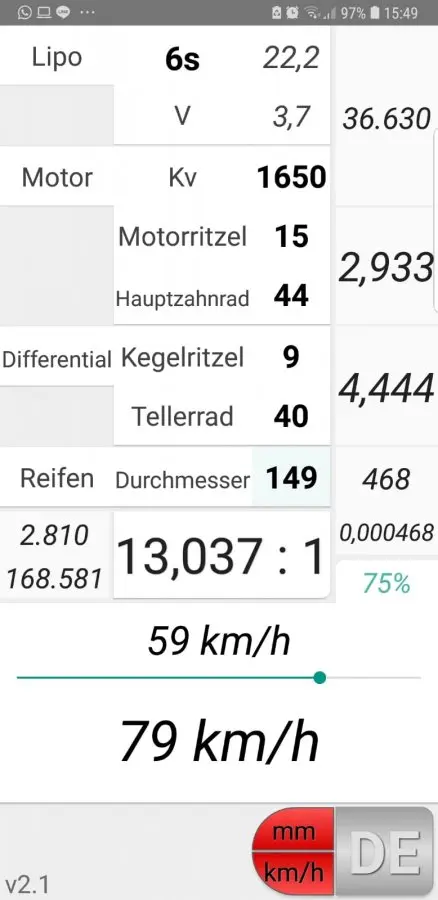

Well i did bite the bullet and ordered a tp4060 1650kv. I will stay on 15/16T with 6s and keep watching esc temps. Hope i am lucky and it will work fine on the max8.

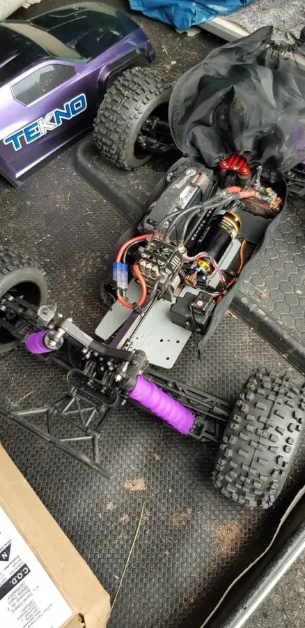

So installed the TP 4060 with 1650KV. Still on 15T @6s.
I also switched rear diff oil to 50k (from stock 100k) and added a fine mesh dirt cover to the chassis.
The motor i received had a non sealed end cap (large vent. holes) wich i sealed with heat resistant tape on the inside and plastidip on the outside. i also closed all holes on the top cap.
First run ~ 10-12min on gravel, ~8°C ambient temperature. Lots of acceleration, power dirfts etc.
Top speed went down noticable wich is fine, but i had the feeling also torque went down a bit wich i cant really understand. This could also be lost power due to wheel spin, i will have to test it on other surface again.
ESC was still kinda cool but motor was allready hot.
I will have a little bash with jumping tomorrow and take messurements of power consumption and temps - right now i have mixed feelings about the setup.

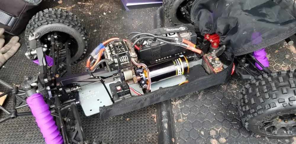

So i had my runs today. Still on 15T/6s, Punch 2/5, Badlands 3.8.
Ambient 3°C/ 40°F
Max Temps ESC ~ 25°C/75°F /// Motor 55°C/131°F
Acceleration is great, i can send the truggy high and far even with little approach. However i get very little to none backspin impulse on throttle in air.
I dont get why the motor is getting pretty warm while the esc stays cold. It is geared very conservative and running small wheels. I will add 2x 40mm fans to it now, maybe no airflow under the mesh dirt cover is just to much even under these low ambient temps.
To get the truck responsive in air i would have to add bigger wheels and maybe more punch on the esc. But both will put more stress on the motor. I also had broken spider gears in the rear 2x times in the past running my big joe II wheels. I guess i will try backflip lp 6s next, they should be a bit lighter but still give more response in air.
Your motor is on the cold side . 150 would be the idea temp . I just saw you are running Badlands tires . Fairly lightweight and smallish diameter. If you are fine with the performance leave as is , but you could gear up a tooth or two based on your esc and motor temps . Almost forgot where is the battery temping at the end of the run ?

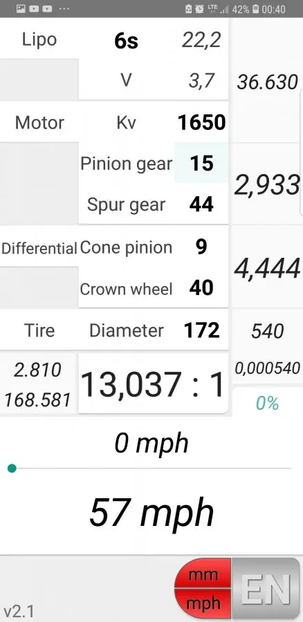

So i had a run with my big joe II wheels. Still on punch 2/5 on the esc and a 15T pinion on motor.
Air control was great, the truck did instantly go into backflips on gentle throttle inputs, it also did wheelie pretty hard on straights. Tyres balooned like hell, so i wasnt able to get real fast runs. Measured max power 3500W, im shure i could get it to draw some more with better handling tires.

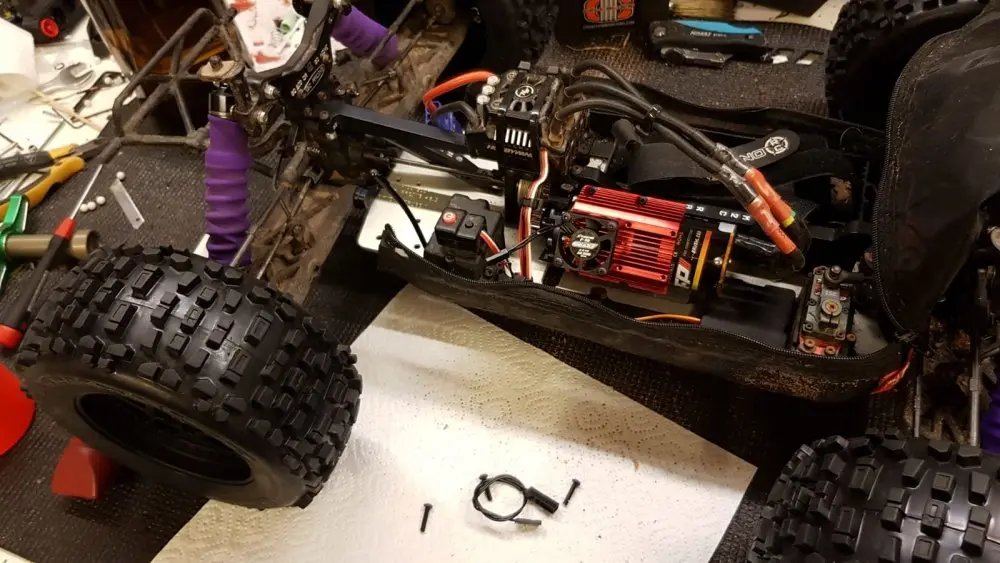

Little Update.
I did rebuild my Rear diff and installed a Yeah Heatsink (had only 1 weakish fan at hand) and the Backflip LP6s. The Yeah Heatsink is a little to big for a 40mm TP Motor and i had to add a bit dense foam as spacer on the rear, but the fins have tight and even contact now.
Did a 6s Lipo today, still on 15T.
Handling much better than with the Big Joe II, Top Speed was more than enough and the Truck still super stable on gravel - the tyres balooned just a little bit.
Also Aircontroll was fine. While my Badlands 3.8 had next to zero aircontroll and the BJ II violently flipped the truck in air the Backflip 6s feel alot more controlled. Big supprise rear diff is still alive...
We had only 0°C/30°F so i did only gentle ~3-4m/10-13f long jumping and single backflips.
Temps after a full pack and 3min. of speed runs/powerdrifting at the end:
Ambient temp 0°C/30°F
ESC temp 35°C/95°F
Motor temp 40°C/100°F
Lipo temp 35°C/95°F
Lipo was a limiting factor, i had permanent Lipowarner Alerts on full throttle.
