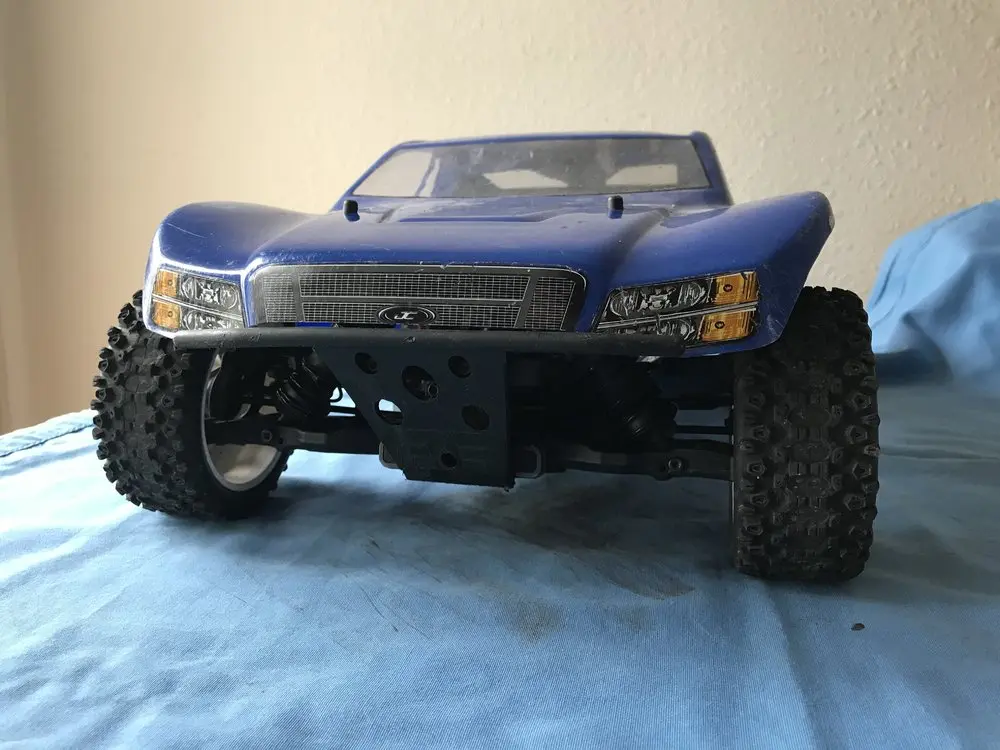

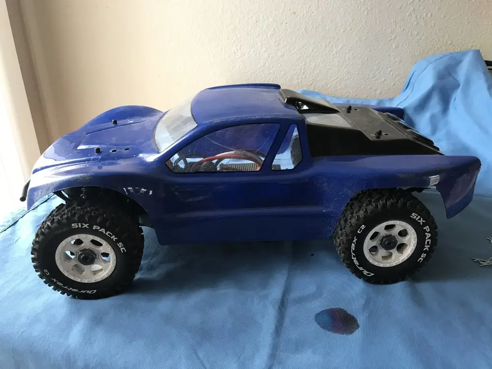

Pictures. Long over due. This is a JConcepts Truth Body. (I think)
It's for a slash, was never to happy with it. Even on the slash. Tires would stick out to far. But I'm running it until it's no longer usable. I have a Proline Ram 2500 that's next. The fit looks better.

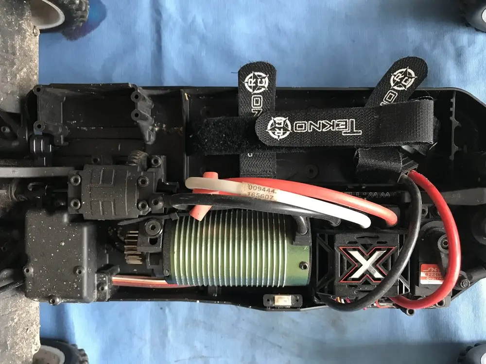

Castle Mamba Monster X with the 2200kv. Non Sensored.

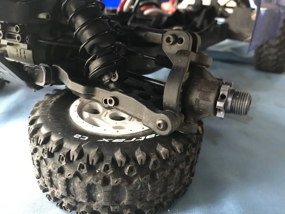

Running the Tekno narrow wheel hubs.
Oh, I am running aluminum hinge pin braces. (all 4) Found them all for under $30. Could not pass that up. Those got installed around May-June.

If you like the 17mm hex's, try the Tekno ones. You can use DE Racing SCT wheels that use 17mm hex's and standard SCT tires. The Tekno hex's keep the width legal for racing and within the body. I happen to use the Traxxas 17mm hex's. I got them before the Tekno ones were released. They are slightly (1mm or so) wider. Plus the 17mm hex's use the EB48SL stub axles which are much stronger than the SCT axles. I think the DE wheels are a bit stiffer as well.

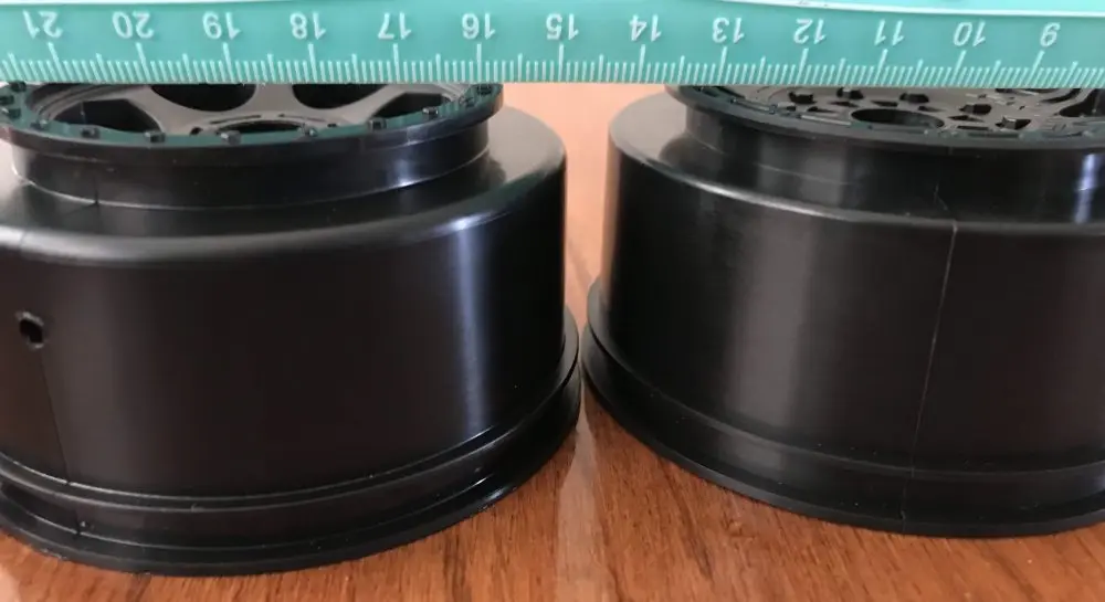

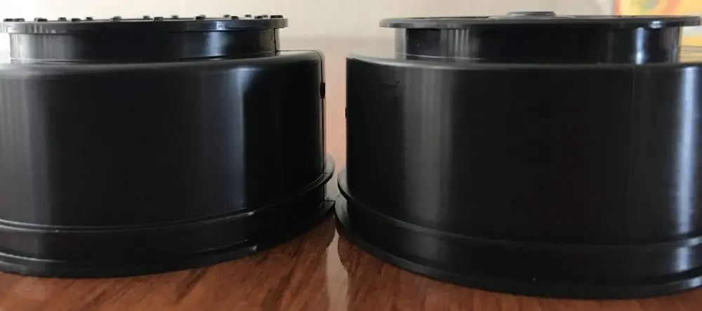

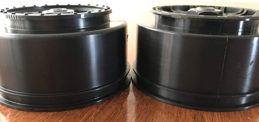

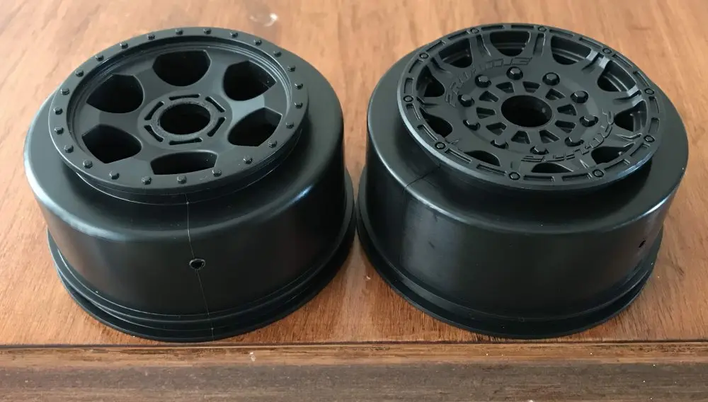

Looks like we have another option for those of us running 17mm SCT wheels.
Pro-Line Raid wheels. They seem to have about 2-2.5mm difference in offset than the DE Racing Trinidad wheels. Will get wheels and tires tucked in a little more.
I don't have tires to mount and test. but here are some pictures comparing Raid and Trinidad wheels. I tried using the cameras grid option to line up the edges of the wheels. You can see the wheel hex sticking out more on the Raid. Hopefully this info helps someone.
