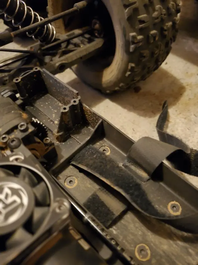

I have an assortment of batteries that I'd love to run in my MT410 and my SCT410.3. However, they just can't squeeze in. The 148mm is just shy of what i need (155ish mm). Are there any options for longer battery trays? Or is the only option to file down the rear lip in the battery tray? If so, are there any downside to filing that down (plastic tray is weaker or something)?
You could probably trim the current battery tray and fit a larger battery in there, those extra 7 to 8mm you need seem available from a real-estate perspective. I would however get a few kydex sheets and protect the batteries from the center diff since you're going to be dangerously close to those rotating parts.

Thinking about it more and about the exposed center diff output has made me less inclined to extend the battery tray. Ultimately I found a lipo that will fit my needs well. CNHL G+ 70c 5000mah. Short enough to not worry about that pesky diff outdrive but will still pack a punch and fit in all of my other trucks I want to run them in!

I'm having this issue with a Gens Ace basher 6800. Cutting off the end of the tray and making another gusset where the battery ends for strength. However, that left the battery way too close to the outdrive joint. The battery is wider than thicker so I left a little stub of the tray next to the joint just wide enough to fit the battery sideways. I'll fill the rest of the tray on that side with a spacer so it's snug. I have a full half inch between the battery and the outdrive now.

I have the rear rib of the battery compartment shaved down for my long batteries and have had 0 issues so far. My batteries do sit next to the center diff but i always tighten the straps while keeping the battery all the way forward and towards outside of chassis and never have had them move on me.
