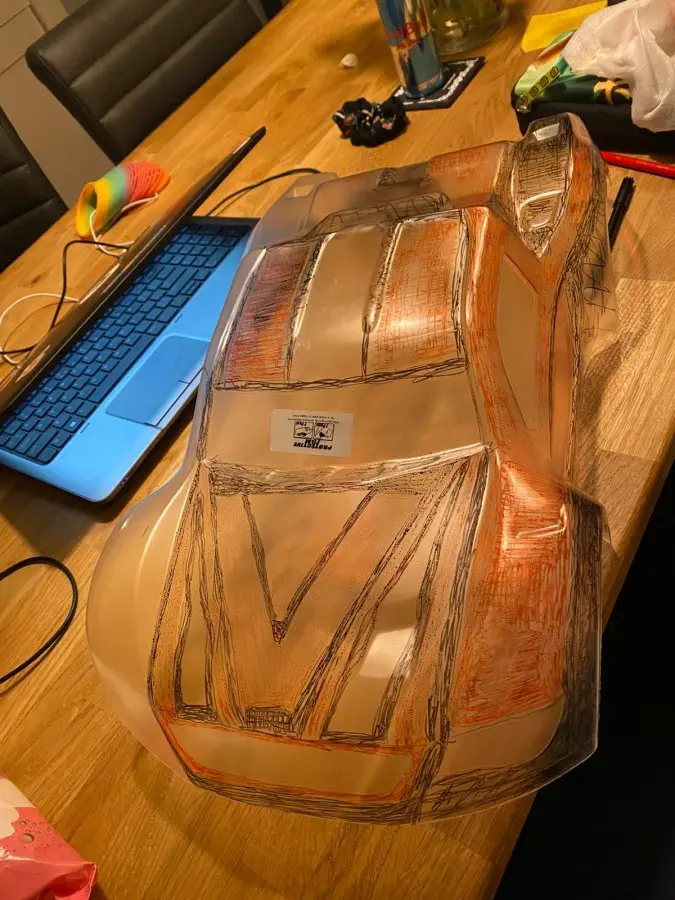

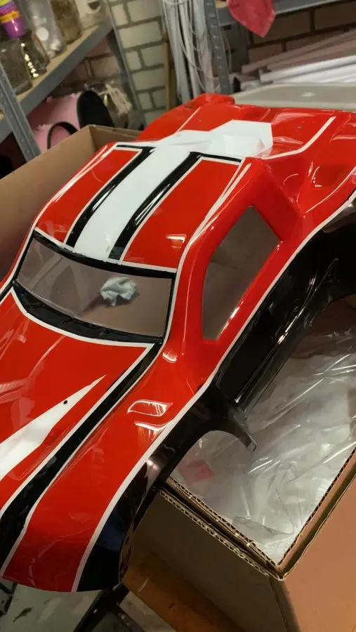

I was struggling how to get a design going, so i just got some felt-tip pens and started scratching stuff on the body.
Felt tip pen is easy to wipe off so I could retry and retry and retry. I just had to see what it could become.
My colors are Black, Red and White.
Came up with this, where the transparent spots will become white (or light decals and windows).
I got the right masking tape and hope it will hold up. Off course the lining will become symmetric.
What do you think, to ambitious for a first paint job or doable ?

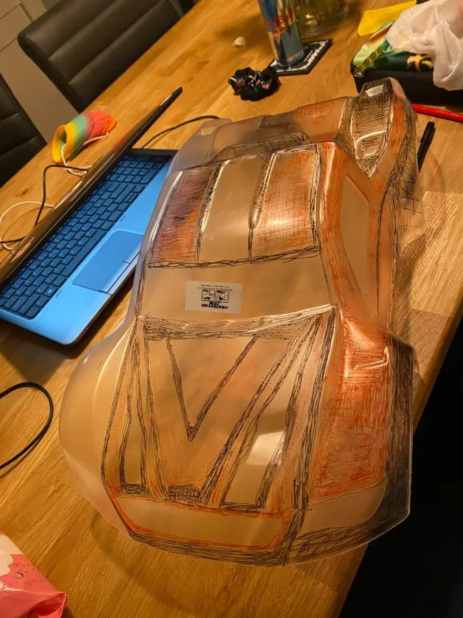

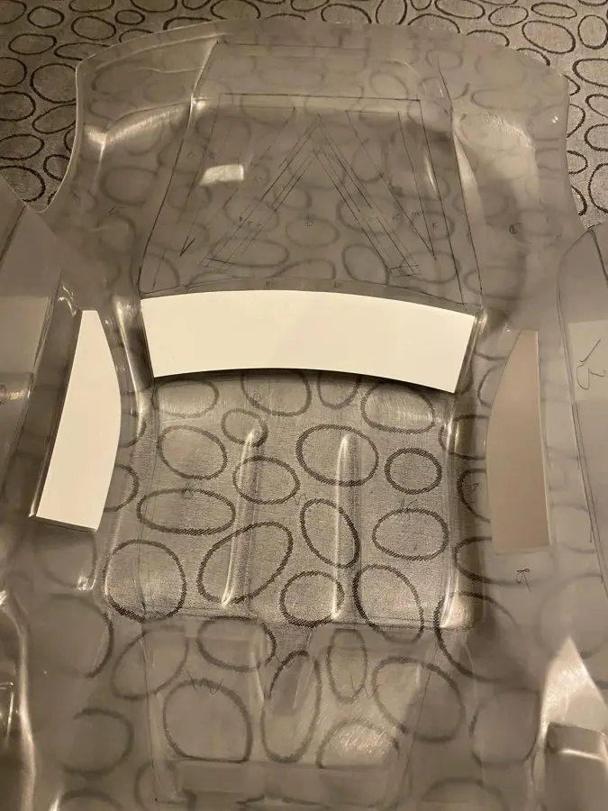

Eager to see it painted!

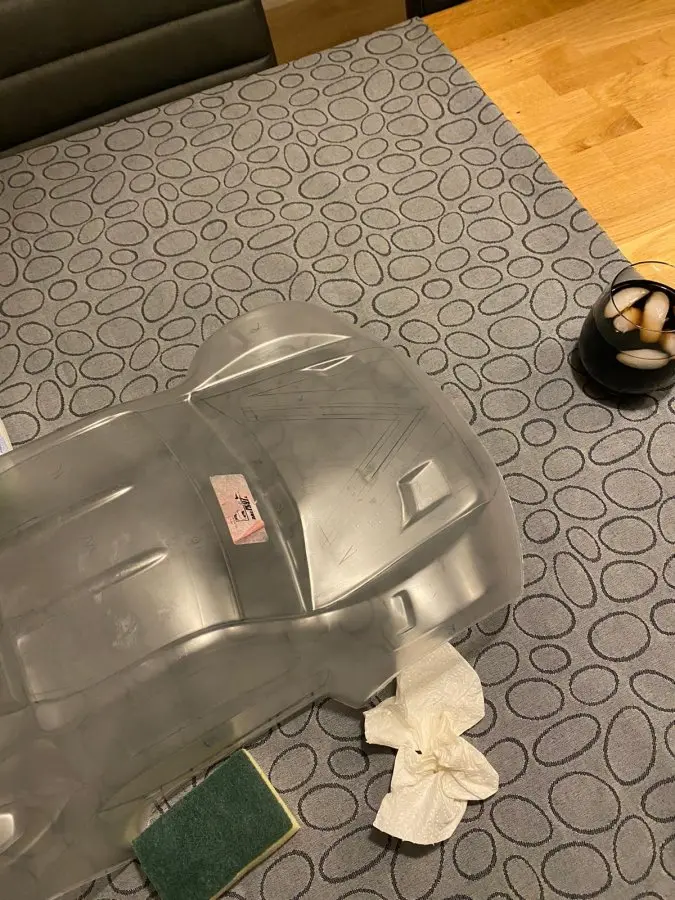

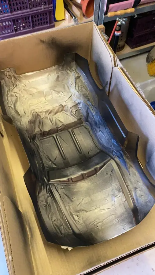

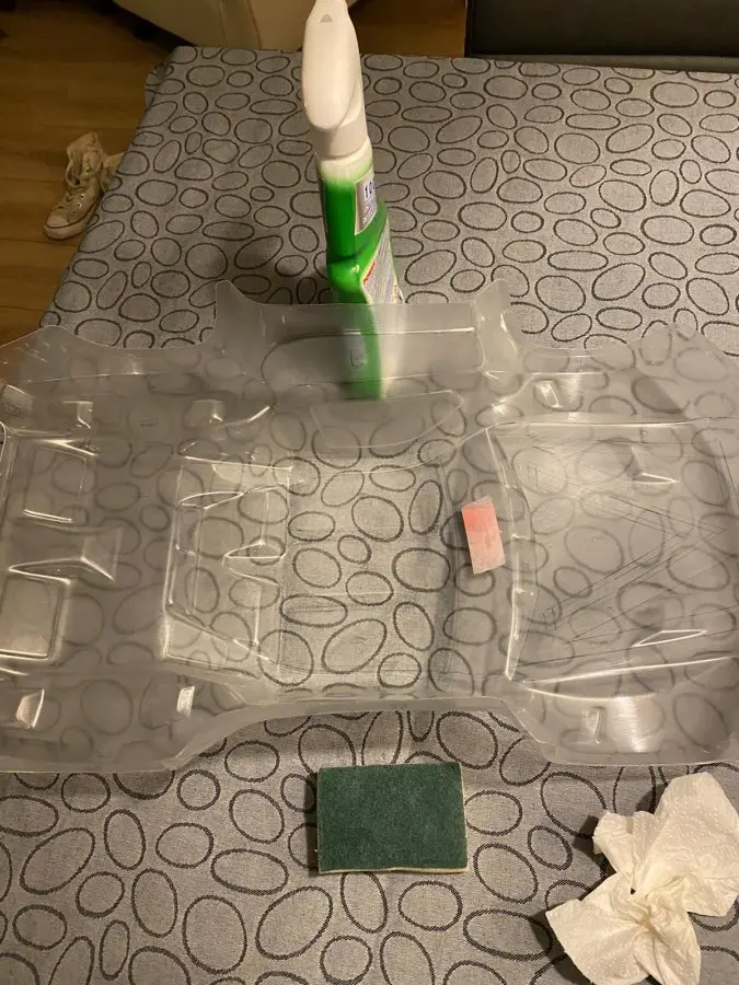

Clean and rough up :
Have a coke and check my lines :
Apply window masks :

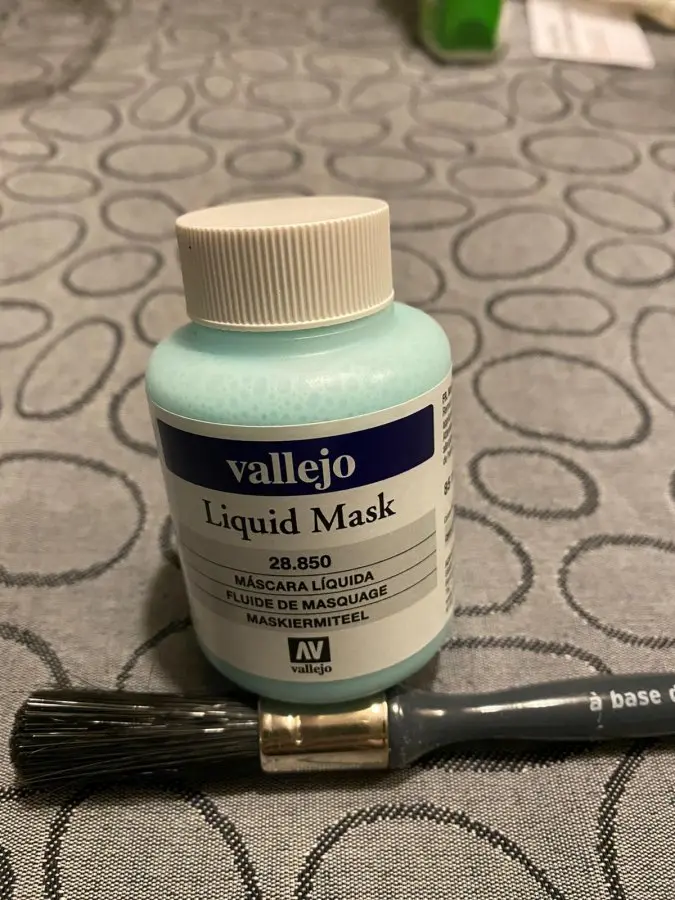

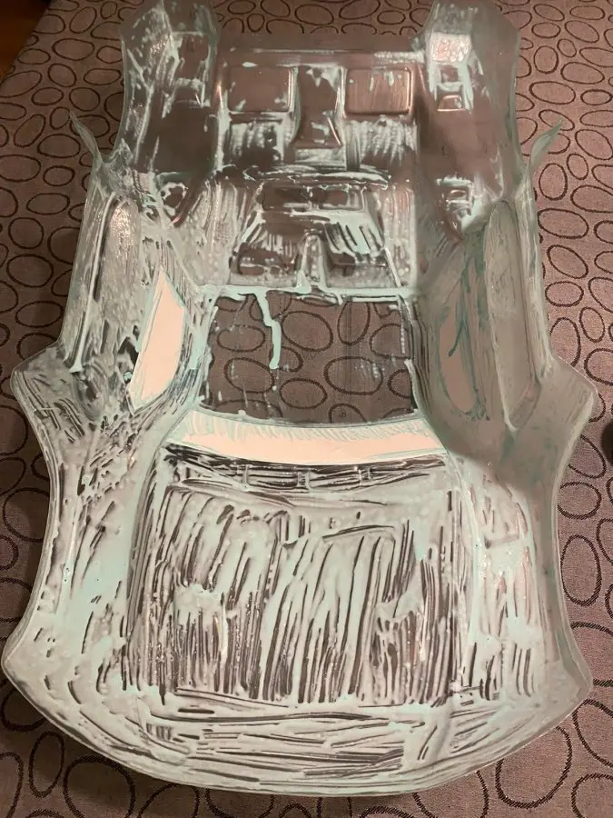

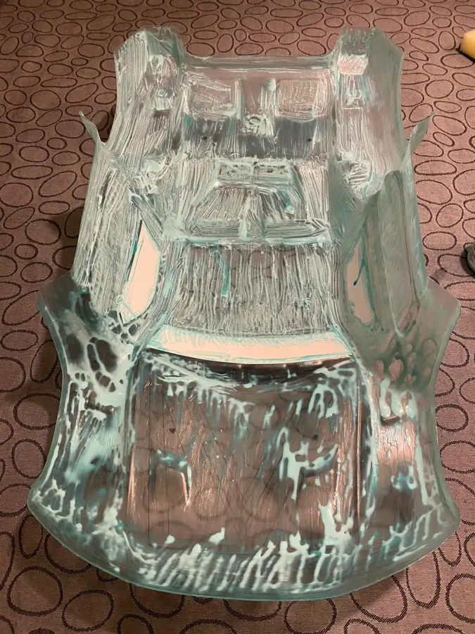

The liquid mask stuff:
1st layer :
2nd layer :
Next step is cutting out the design from the liquid mask ;-)

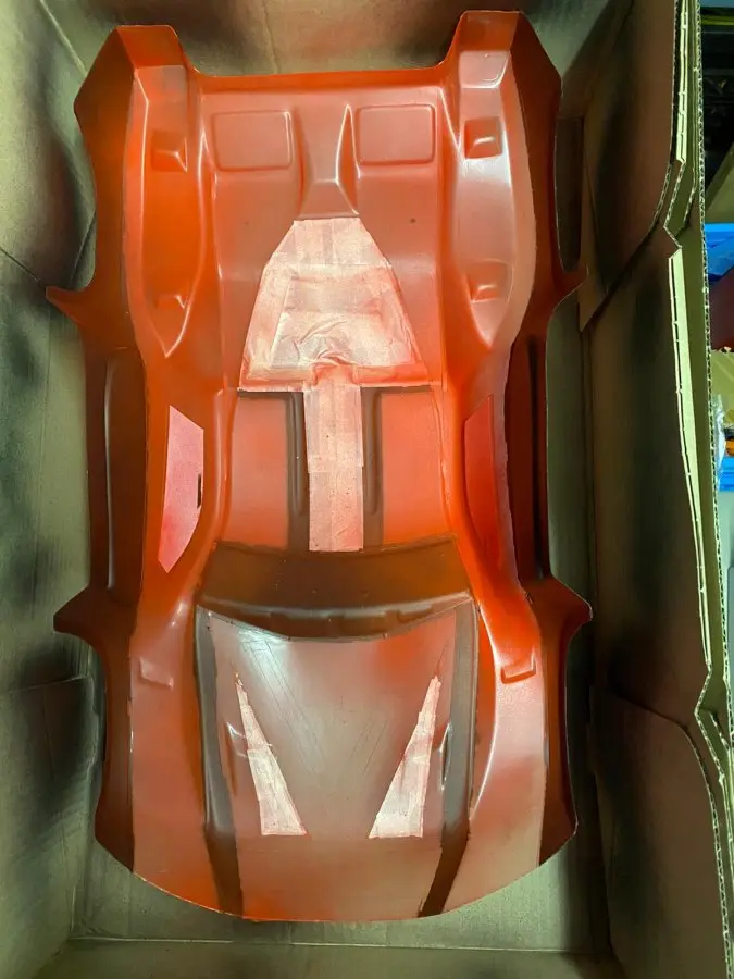

The vallejo liquid mask is a NOGO.
I tried 3 times, emptying the bottle, with different brushes.
It Curled up when cutting every time using fresh hobby blades.
But as I learned this stuff is more voor small surfaces.
So I went with masking tape and got a mediocre result, with some bleeding spots, still satiefied with it :-)

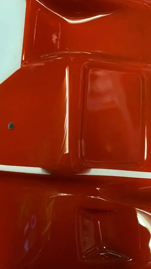

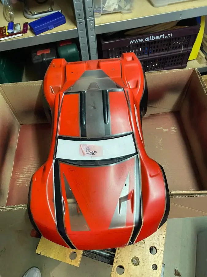

Masking:

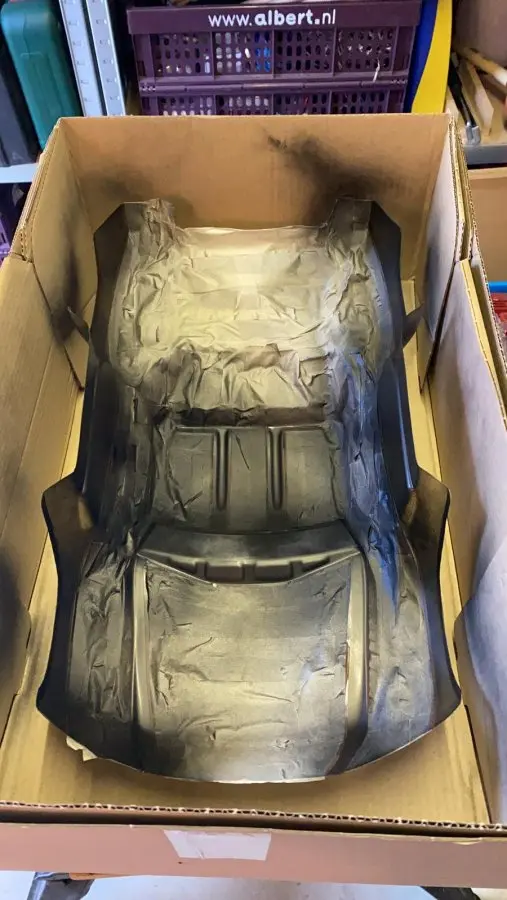

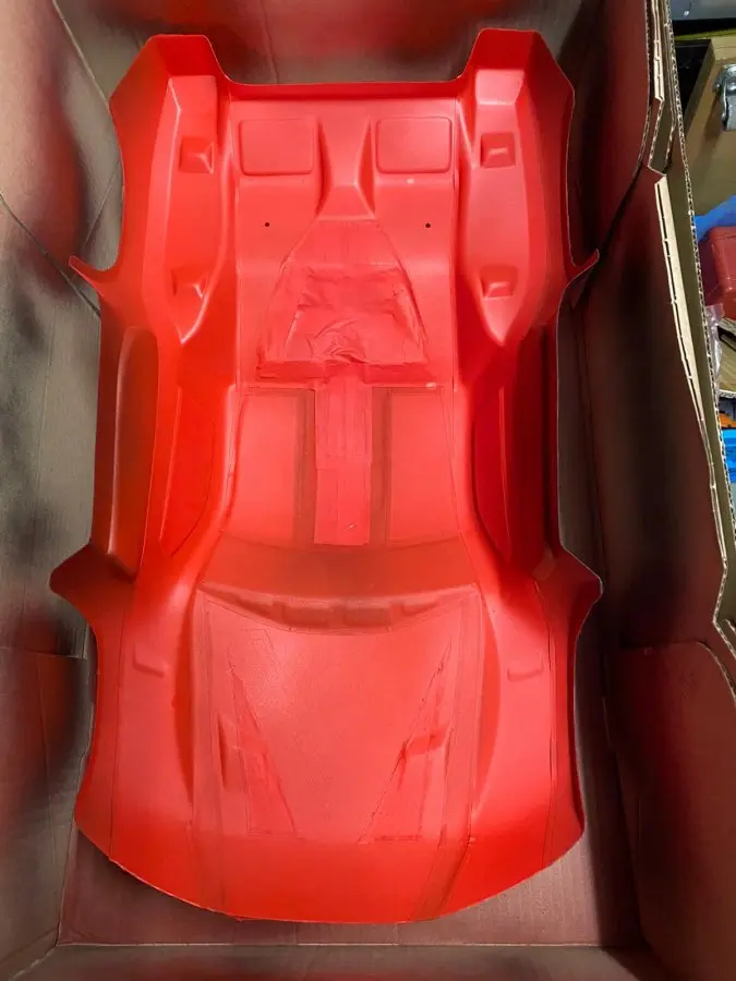

Black layers:
Red Layers:
Result of black and red :

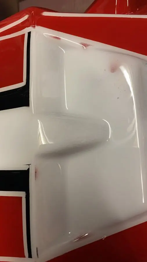

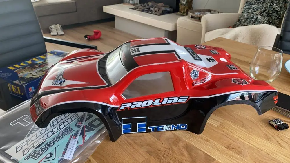

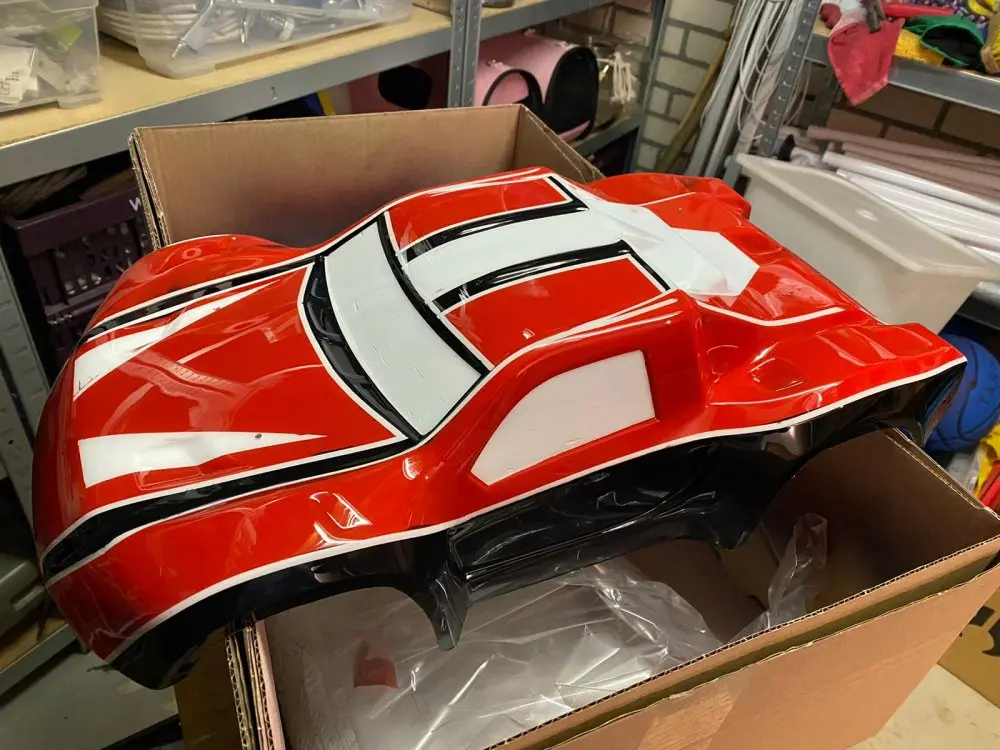

After white and film removed :

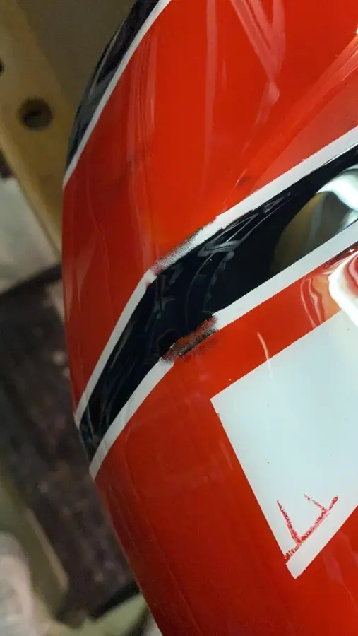

Bleeders !!!

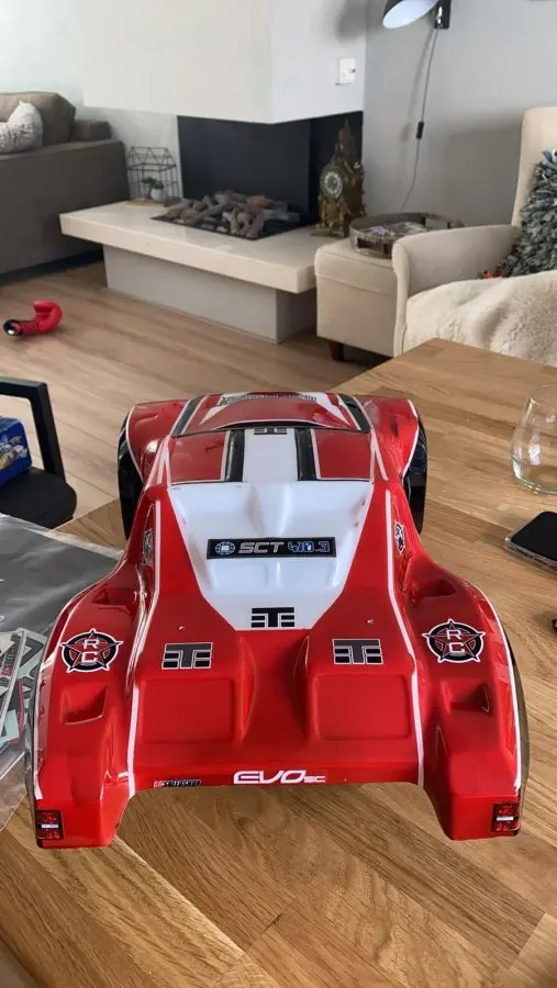

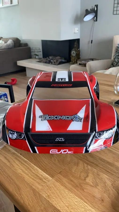

Result after decals :
Unable to cover up all bleeding but it will take a beating soon enough.
Will get some alternative decals in the future.

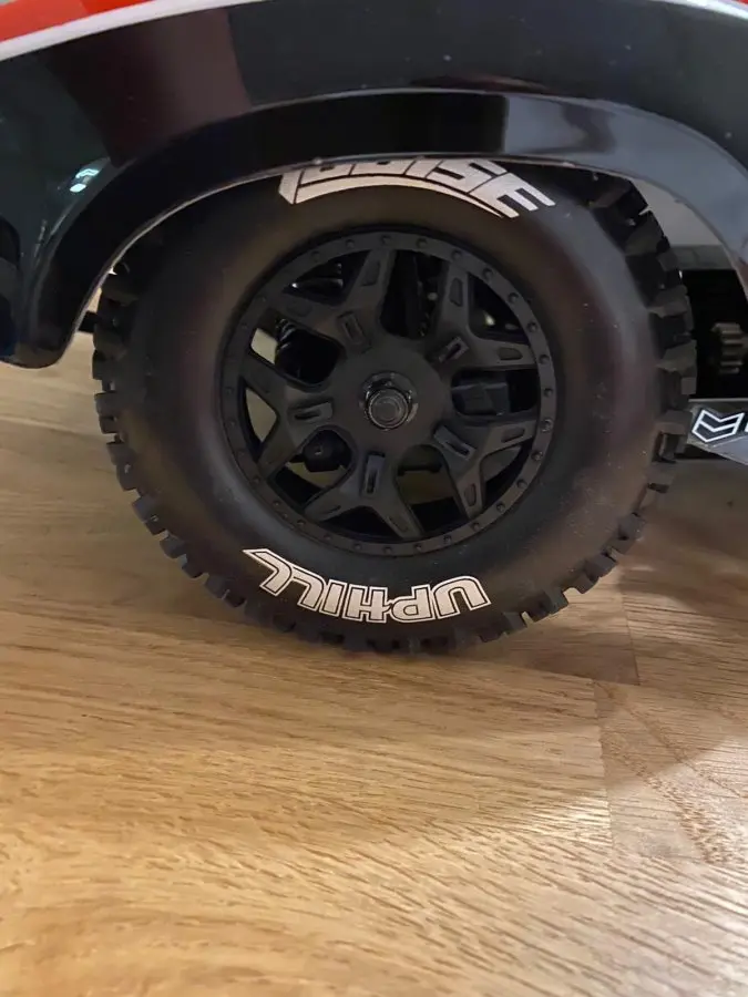

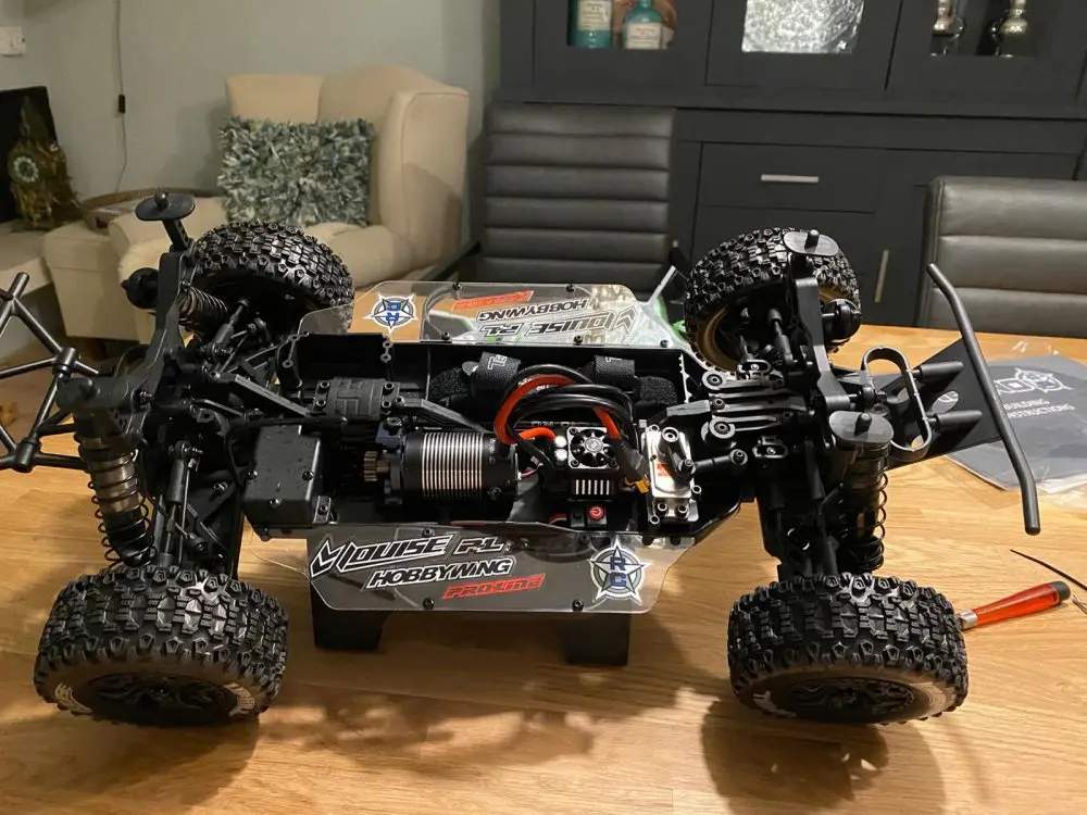

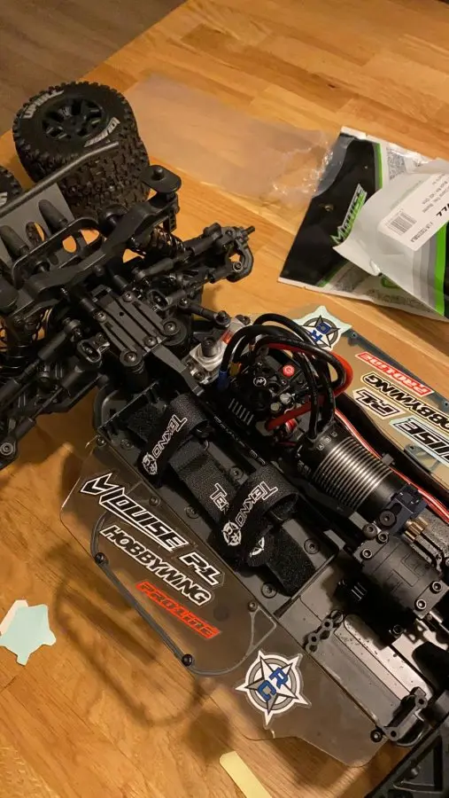

Installed airguards and new wheels :

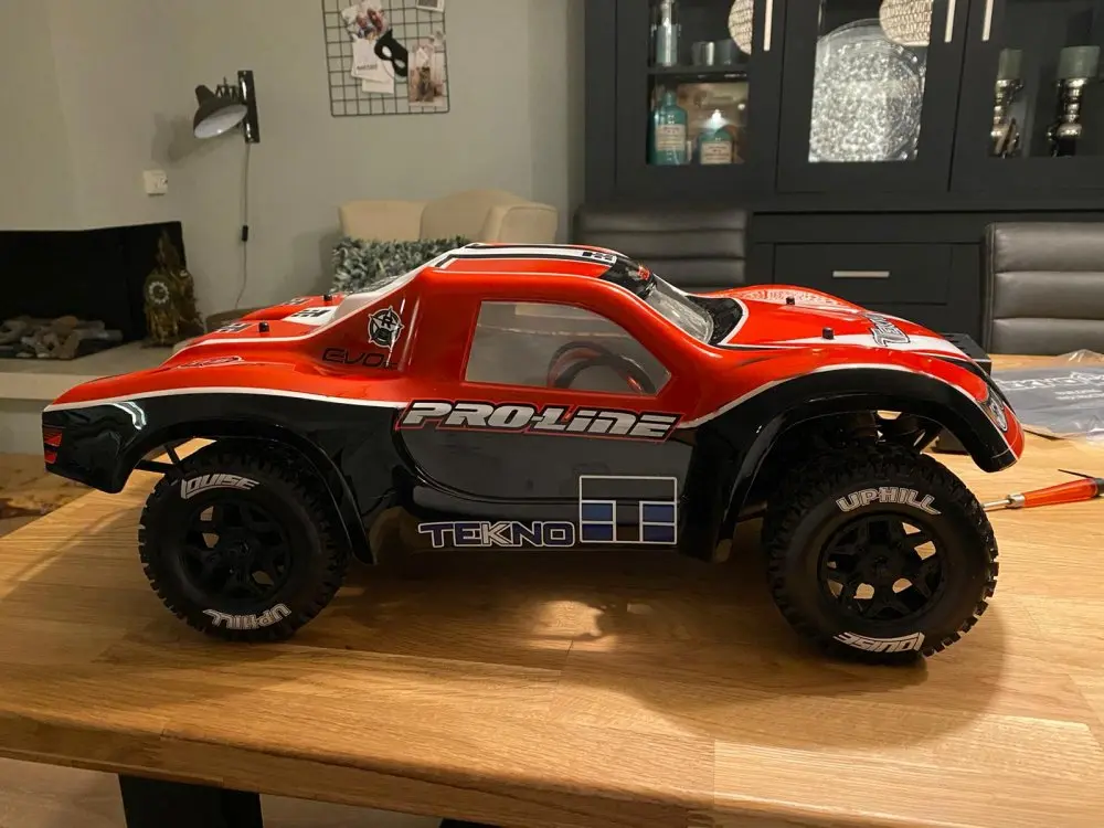

The car is really done now :
Wheels with the correct offset are clearing nicely.
