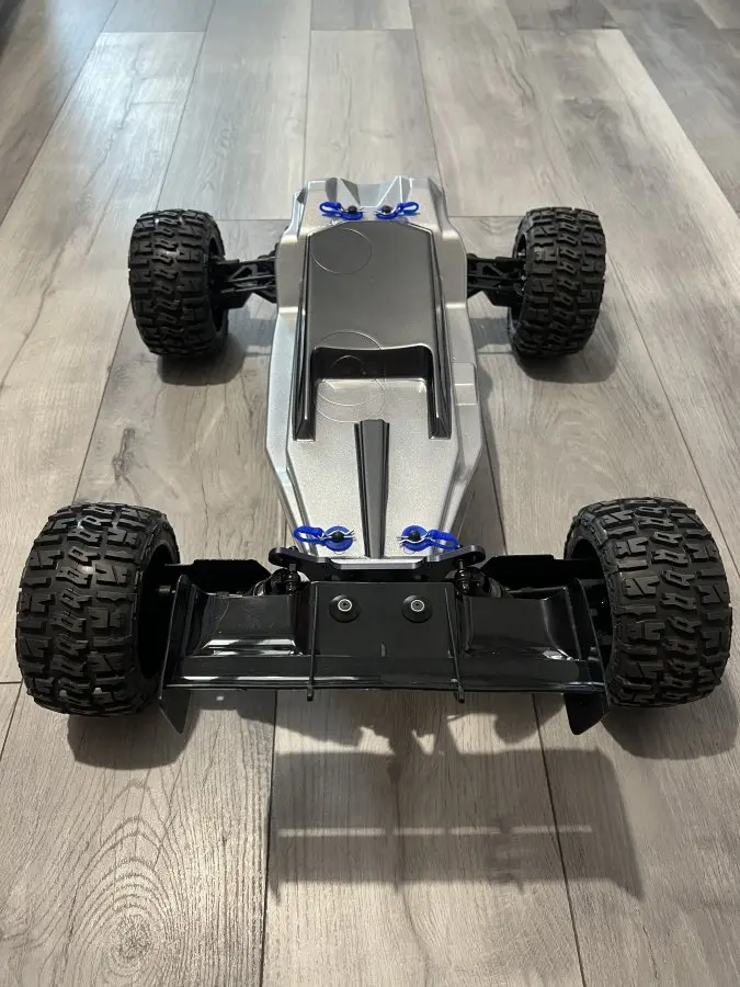

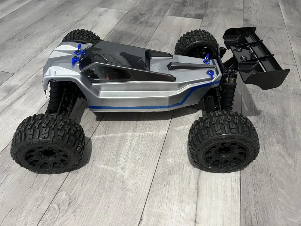

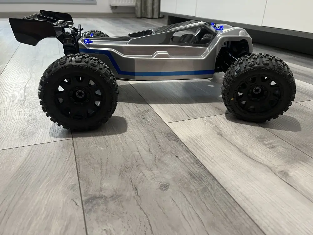

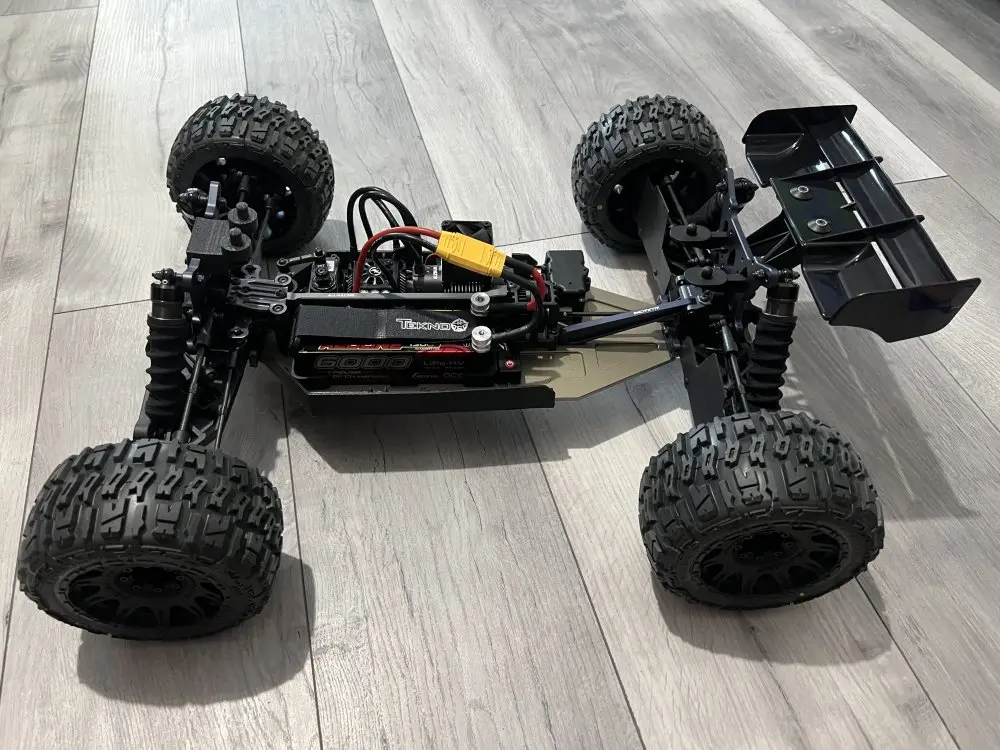

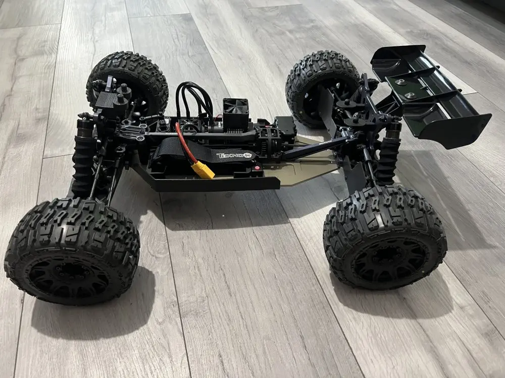

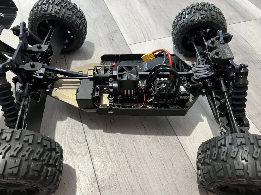

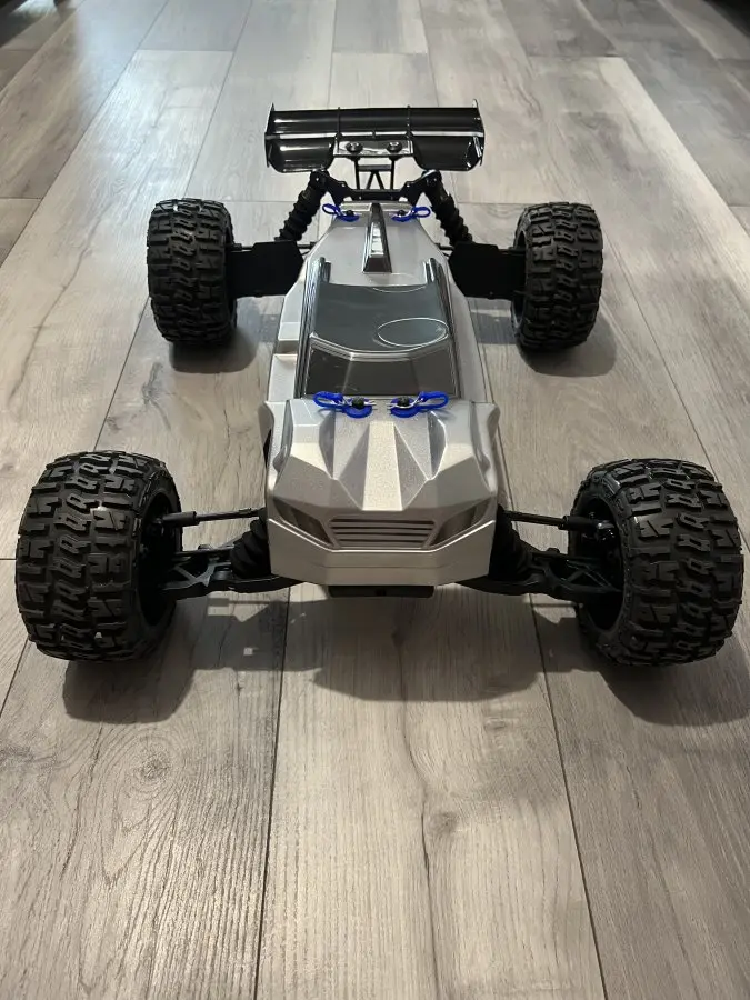

After a long wait and hard work it’s finally ready for the first run 😎
