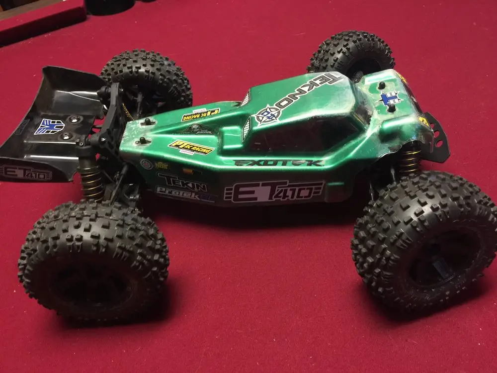

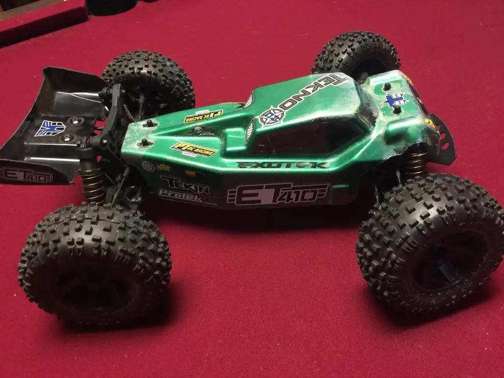

Don't totally throw the ET410 out of the options just yet. I actually own an ET410 and can attest it is quit the beast for its size and very durable so far! Of course the ET48.3 would be more powerful and be a ton of fun but if you don't want to spend that much and are not trying to launch your rig 30ft up in the air the ET410 will be very suitable for running in grass.
Slap some big ass wheels on the truck and and your good!

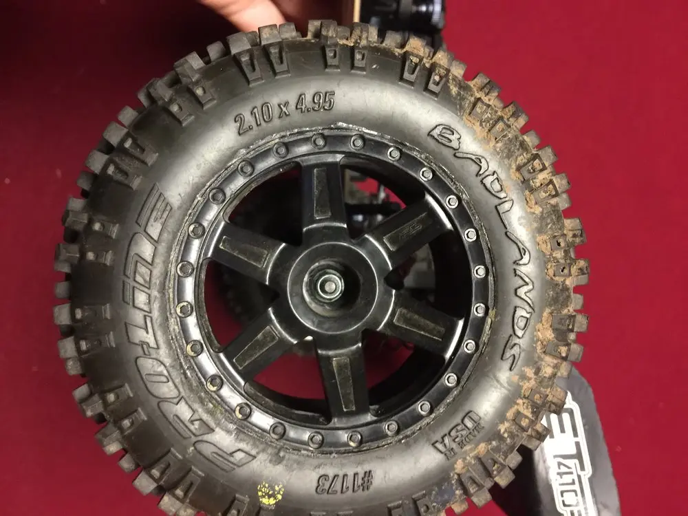

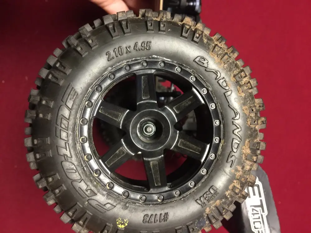

Don't totally throw the ET410 out of the options just yet. I actually own an ET410 and can attest it is quit the beast for its size and very durable so far! Of course the ET48.3 would be more powerful and be a ton of fun but if you don't want to spend that much and are not trying to launch your rig 30ft up in the air the ET410 will be very suitable for running in grass. Slap some big ass wheels on the truck and and your good! View attachment 1464 View attachment 1465
Thank you for posting that! Just the other day I was looking for pictures of the ET410 with 2.8 Badlands but never found one. Are you using offset wheels, like would fit the front of a Rustler or 2wd Stampede?

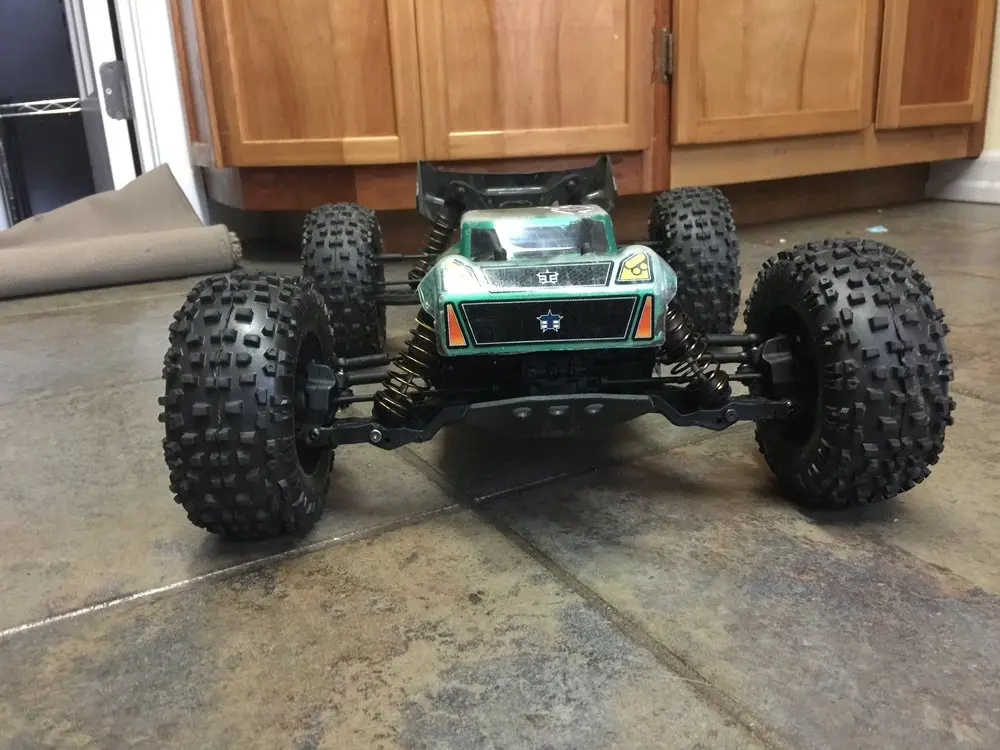

Also, could you post a picture of it from the front that shows how tall the tires are compared to the body.

They came from my brother's revo, so not really sure what the off set is.

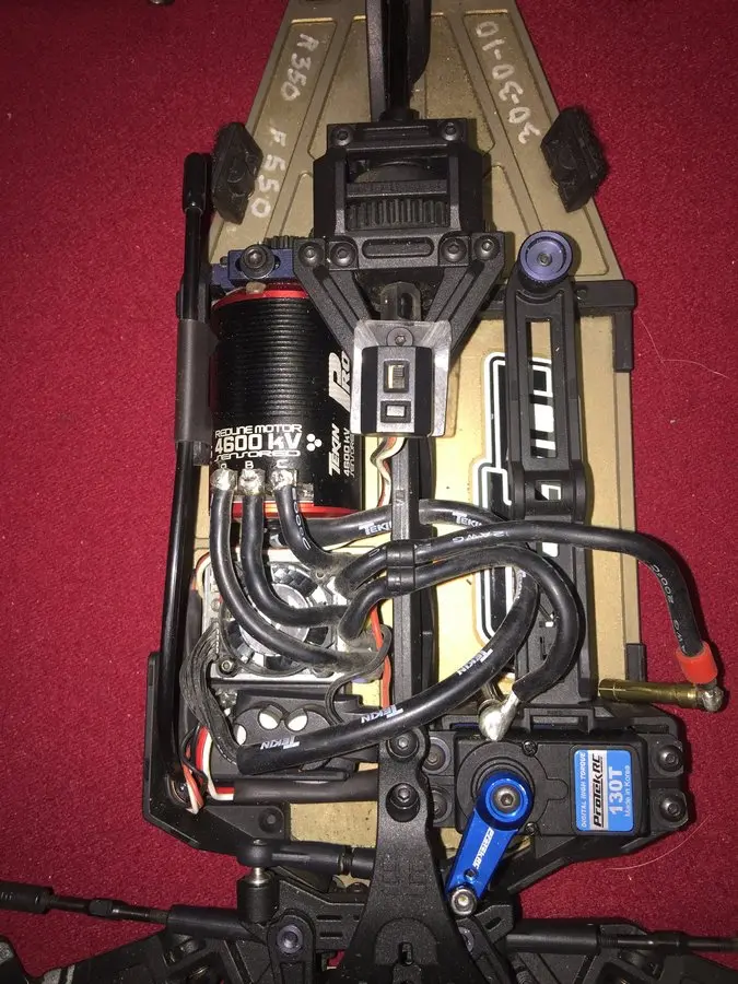

I have an Orion R10 w/ tekin pro4 4600kv powering mine and am able to clear some sets that typically only the 1/8 scales do. I feel there is plenty of power with this combo and or something similar. I don't have any over heating issues either. The ESC has a fan so I am sure that helps.

Just for a comparison;
Orion R10 160amp footprint is 41.5x30.5x20.2mm
The Castle Mamba X footprint is 54.4x35.2x30.0mm
Just so you can see my ET410 with the r10 installed. There is definitely room but not a ton.
Thanks for the pic, that helps a lot. Where is your receiver?
Wow yeah I can see it now, geez those are some big caps. How much voltage and Amps does the BEC put out on that unit?
I am assuming the chassis will not touch the ground before the shocks bottom out. Right? I'm just preparing myself when the day comes... supply of ST Step-Pins runs out and/or manufacturers stop making bashable 2.2" truck tires.
