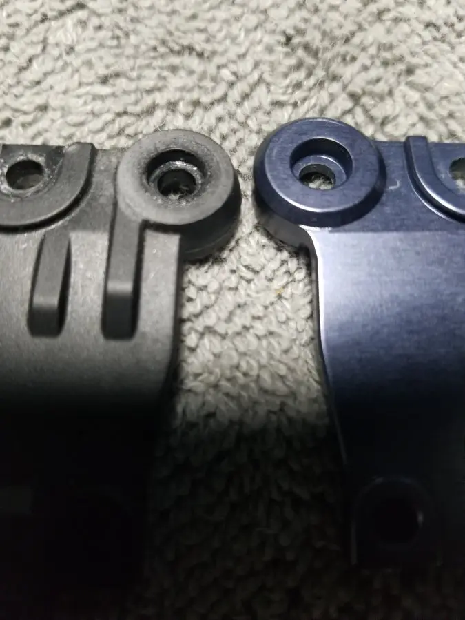

I guess this is the best section for this post.
Recently a lot of us on a Facebook group have purchased an Aluminum Steering Top Plate for the Tekno RC's. This batch was milled improperly, and the holes for the steering posts are too deep. When tightened down, you have no steering it just locks up.
One may be able to add washers into the holes to make up for the deep mill, but for $30 I feel that is not the correct solution.
Recently a lot of us on a Facebook group have purchased an Aluminum Steering Top Plate for the Tekno RC's. This batch was milled improperly, and the holes for the steering posts are too deep. When tightened down, you have no steering it just locks up. The guy is still selling them on eBay under zackwagner2011.

Unless i'm confused, it looks like in the picture the plastic stock one is the top and not the bottom so you can't tell the difference from that pic.
on the flip side, the plate I got actually isn't quite as DEEP there as the stock plate (opposite issue) so I have a bit of slop where the cranks can move up and down a little after it's tightened. i'm talking a millimeter of slop so it isn't an issue, just slightly annoying.

haha good catch, wrong picture Changed to a better picture. They were both them bottom side, but was hard to tell with the stock.

The bottom holes are to deep on the steering post, pushes down on the post when tightened, stopping them from being able to turn. A shim seems to do the trick. Below is the maker/seller solution.
