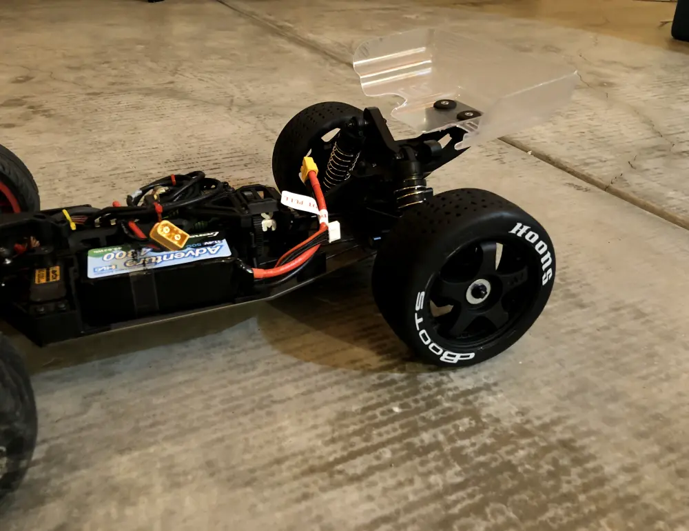

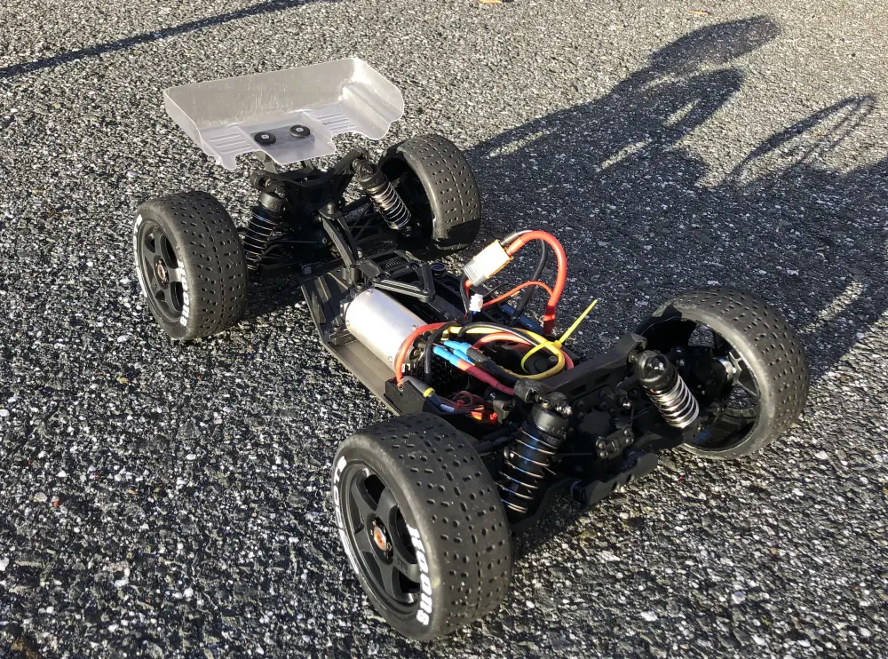

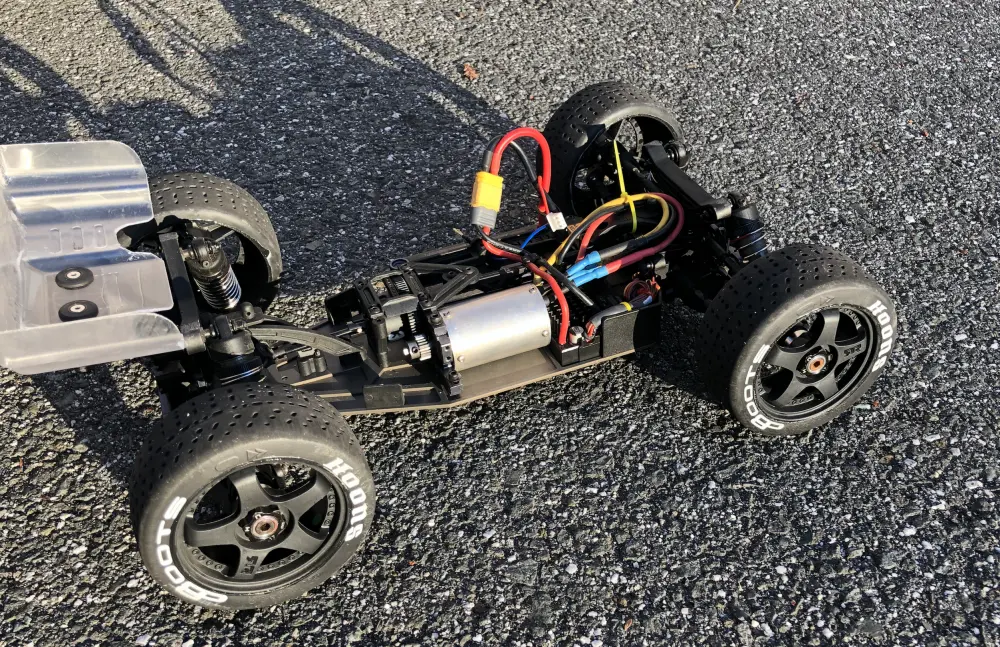

So here's the beginning of my attempt to turn the EB410 into a street machine. Thanks to some other members, I also have on-road buggy tires in the mail, but I couldn't resist testing out some Arrma Hoons.
I am also ordering the sway bar kit so I can get some thicker sway bars, and reduce body roll while cornering at high speed. What other changes would you recommend for on-road use?
The Hoons don't fit on the front axles (not enough thread) so I'm getting some rear axles to run up front. For now, I use some "over the top" adapters that just cover the 12mm hex with a 17mm hex. But, a better solution would be changing the stub axles to take 8th scale hexes without the use of adapters at all. Tekno makes these parts for other vehicles, like the Traxxas Slash, but so far I am not seeing anything that would work for the EB410. If you know of something, please let me know.
