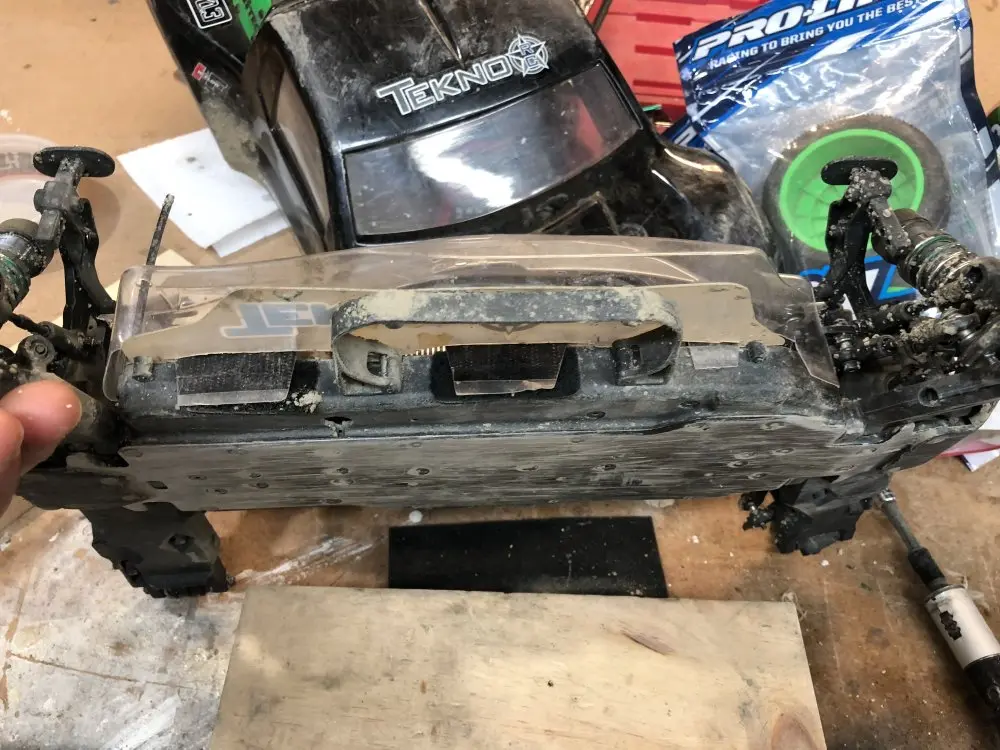

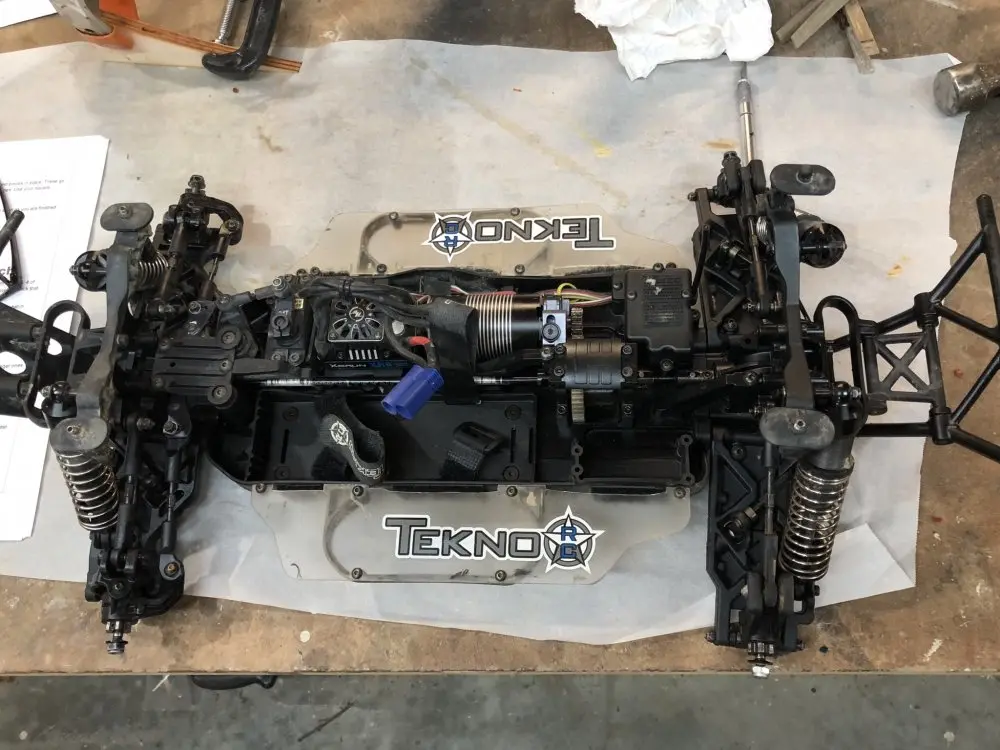

You can use the eb48 body under the sct body to protect the chassis in hostile environments. Haha

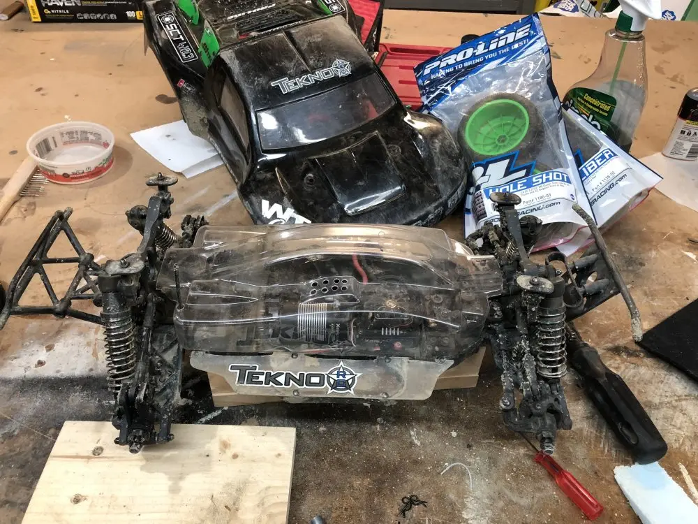

Yes you can, and my truck is forever packed inside. I've been told the M+ universal Dusty Covers shroud fits well too. Think I'm going that route. With 5min heats and 6min mains I have zero heat issues.
I don’t either. Esc usually around 90f and motor 115-20f. I did drill some small holes over the motor and esc just in case.

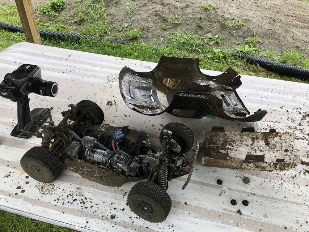

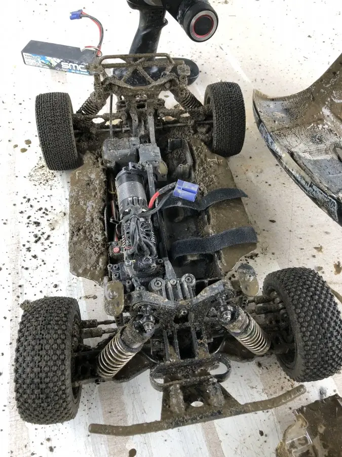

I ran the cover today because we shoveled and raked, then dragged the entire track. I checked temps after a full pack. Motor was 158 and esc at 98. All good and my esc fan only had to be jumpstarted once. That’s the main thing that binds up in gritty conditions.

Mud cover did it’s job, I couldn’t bare the idea of limping home with fully charged batteries. My electronics were safe and sound.
How do you go abouty cleaning after runs like this?
With my Kraton I would just grab the water hose, point and spray full throttle. Now that I have the et48 I am a little more concious of getting it wet, especially with the water hose. When I do hit it with the hose it's very lite misting and a toothbrush for that caked on mud. Then I bring the Tekno inside and point 2 fans at it. Any better ideas?
I had to resort to the garden hose. I still didn’t directly spray the electronics. Then I blew it dry with compressed air, then gave all the metal parts a light coating of wd-40. Everything seems to be fine. Sometimes you just gotta send it!
