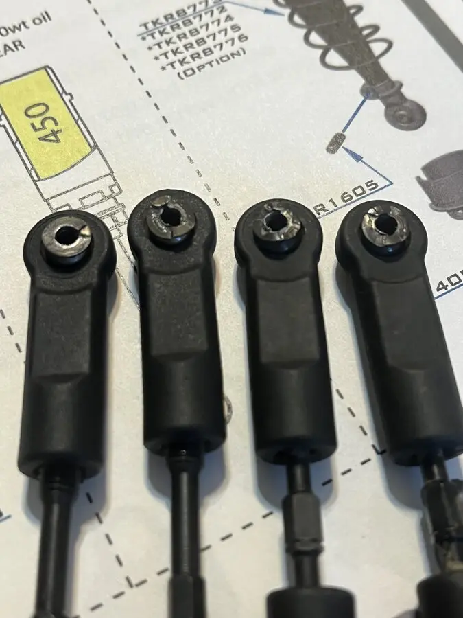

In taking apart and rebuilding my new to me EB48.4 among several bent, broken, and worn out assemblies I found that on all four turnbuckles one of the pillow balls is cracked and broken but only on one end and only on one side. Is this a weak spot? Are there perhaps stronger aluminum or steel or titanium upgrades for this part? Or should I just have plenty on hand for quick replacement at the track? Also some are nice and wiggly in there captive plastic ends, others are so friggin tight they barely move, especially the steering linkages. How do I loosen these up and free up the binding and drag on the steering? Thanks!
I would just replace with stock parts. You can get a bag of rod ends for 11-12 bones and pivot balls for the same. For tight rod ends you can try squeezing on the outside of the pivot ball area to loosen them up.

Those pivot balls in picture were in no way taken care of.:rolleyes: I crank down on the nuts, that secure those balls to the towers, pretty darn hard... I've never had any look like what you got in front of you. Just buy some new stock pivot balls, and rod ends.
I would definitely replace those. If you have other parts that need replacing I would collect them all together and send them in for Tekno's replacement warranty.
When you go to reassemble, put a washer between the tower and the pivot ball and that should prevent the type of damage you're seeing. Typically the balls will look like that if the screw and nut securing them loosens, then the ball smashes into the camber link cutouts and bends/divots. The washer helps with that in case it loosens and also helps spread the load the ball sees during normal operation.
