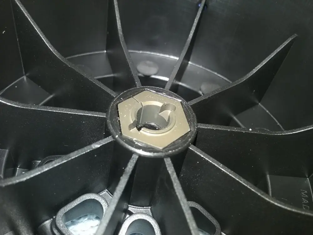

The wheels I'm using are Pro-Line's Renegades PRO2725-03 intended for use on the HPI Blitz, Ultima SC6, Jammin SCRT 10, and other RCs that use the Traxxas Slash (rear)/Slash 4x4 offset.
The problem? Tekno's wheel hexes (stock TKR5571M) are not wide enough and/or the Pro-Line wheels have too much material; making the wheel's socket too deep. When I go to tighten the wheel nuts, the extra plastic that is .41~.70mm above the wheel hex (in picture) rubs on the hubs. So annoying.

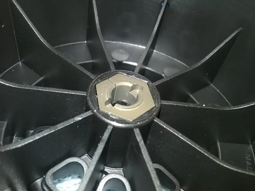

Tekno's TKR1654X aluminum +1mm hex adapters arrived today. The TKR1654X hexes measure about 5.51mm wide (including the raised lip). If it was not for that little extra lip on the +1mm hex, there still could possibly be an issue with binding on the hubs. Anticipating this, I have ordered 6mm wide hexes.
